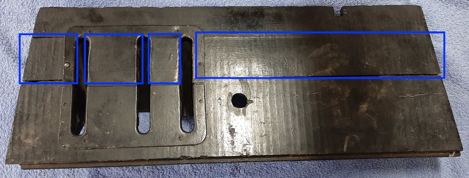

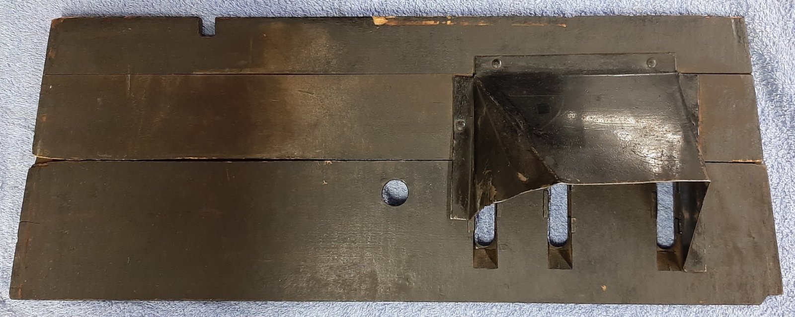

After some inspection I was surprised to find that the upper board (nº 1) is made from not 1 piece but 5 pieces of wood which are dovetailed and the riveted metal pedal slots hold them together. This shows the 4 pieces which are dovetailed to the upper piece.

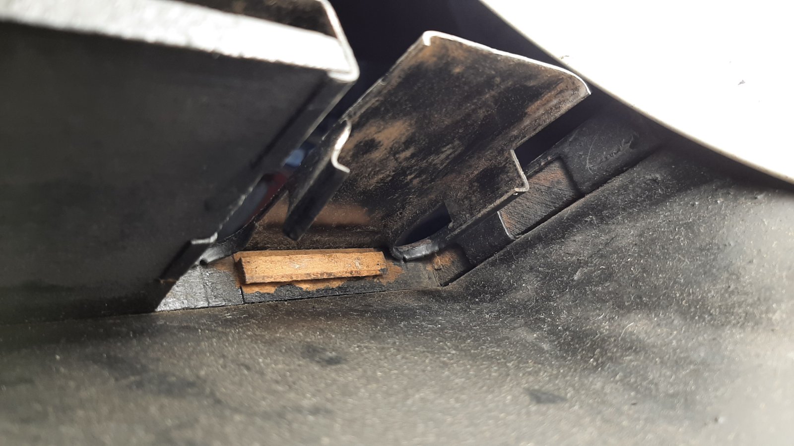

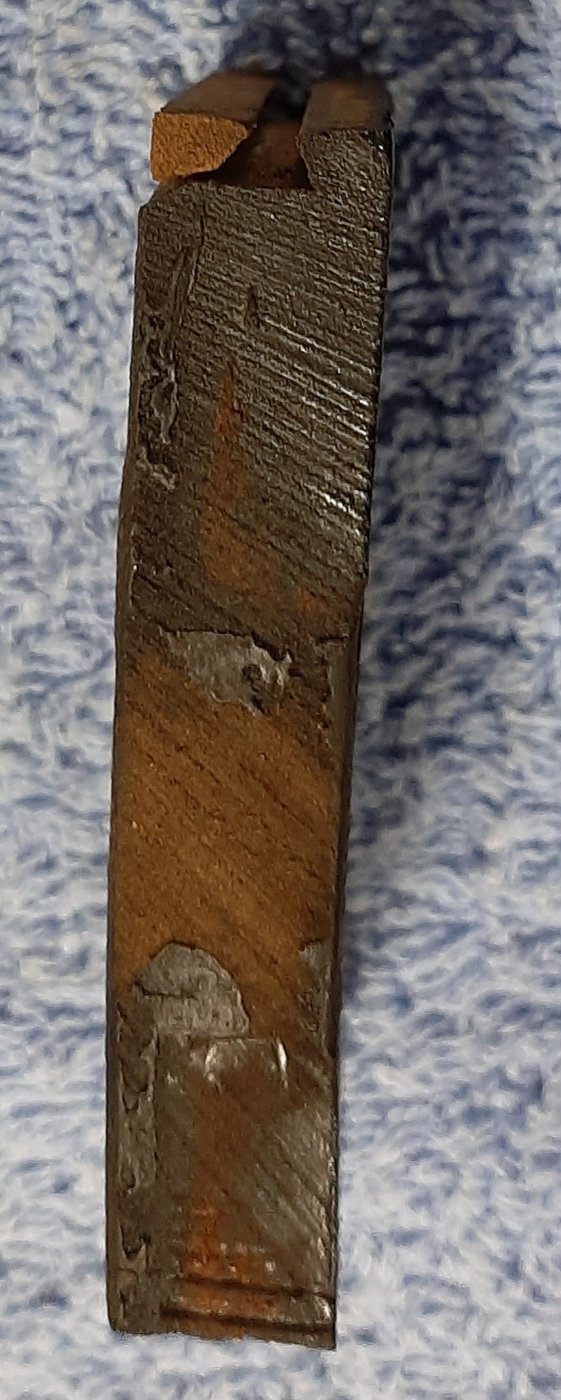

The dovetail cut can be seen here and the little piece between the reverse and the brake pedals is removed. I had to reposition it because the dovetail had broken off and was pushing it downward, making it hard to fit the floorboards in place.

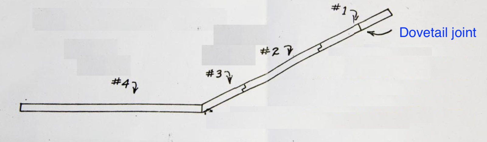

Using Jim Thode's original drawing as a base, my floorboards appear as follows:
Can anyone confirm if this is Ford original issue? It sure is quite a bit more ornate than any shipping crate could have been (reference to old wife's tail about Ford repurposing shipping crates to make the floorboards).
