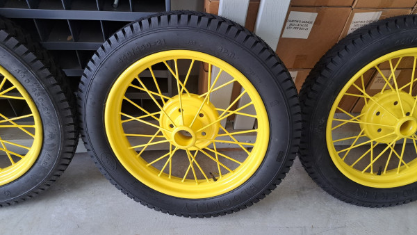

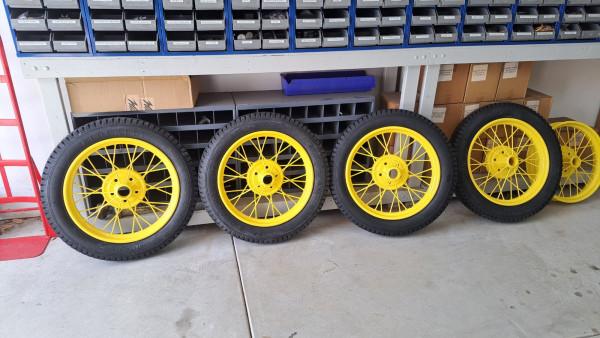

Post by Mark Chaffin » Mon Mar 31, 2025 9:49 am
After hearing the hype about Blockley tires, I had to order a set for the Ranch Doodle bug project. With the exchange rate and shipping it was expensive. About $1,600 for five tires, tubes and rim liners (450-21 size). The tires are no doubt better quality. Much thicker sidewall and tread. The tubes much thicker as well. I've mounted many tires over the years. These were much more of a challenge due to their construction. They are also DOT approved! Well worth the money and effort.
