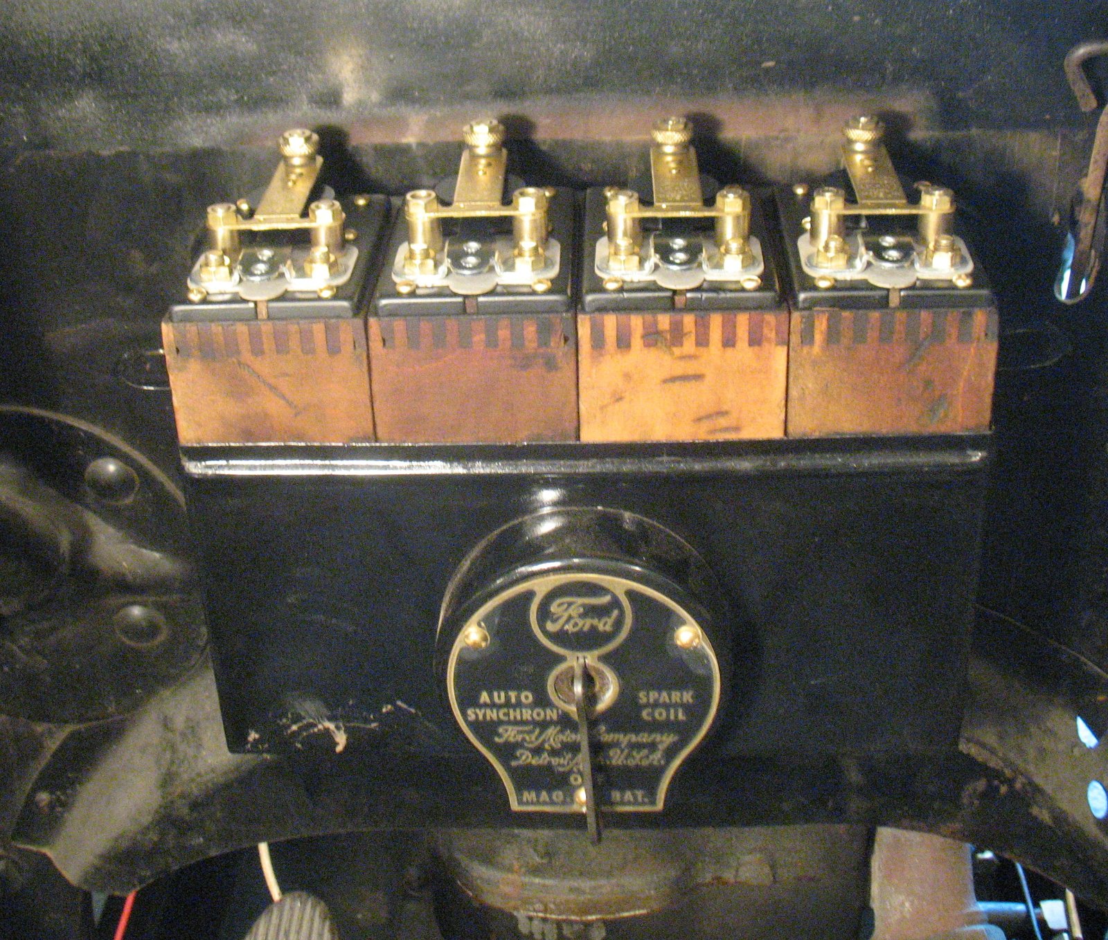

Observing a need, I posted the following in a couple of the Facebook Model T groups. It occurs to me that even here, there may be somebody unaware.
The black box is a coil box. The four things in it are coils, not "coil boxes".
You're welcome.

If you want to be authentic, the switch plate is not correct either!

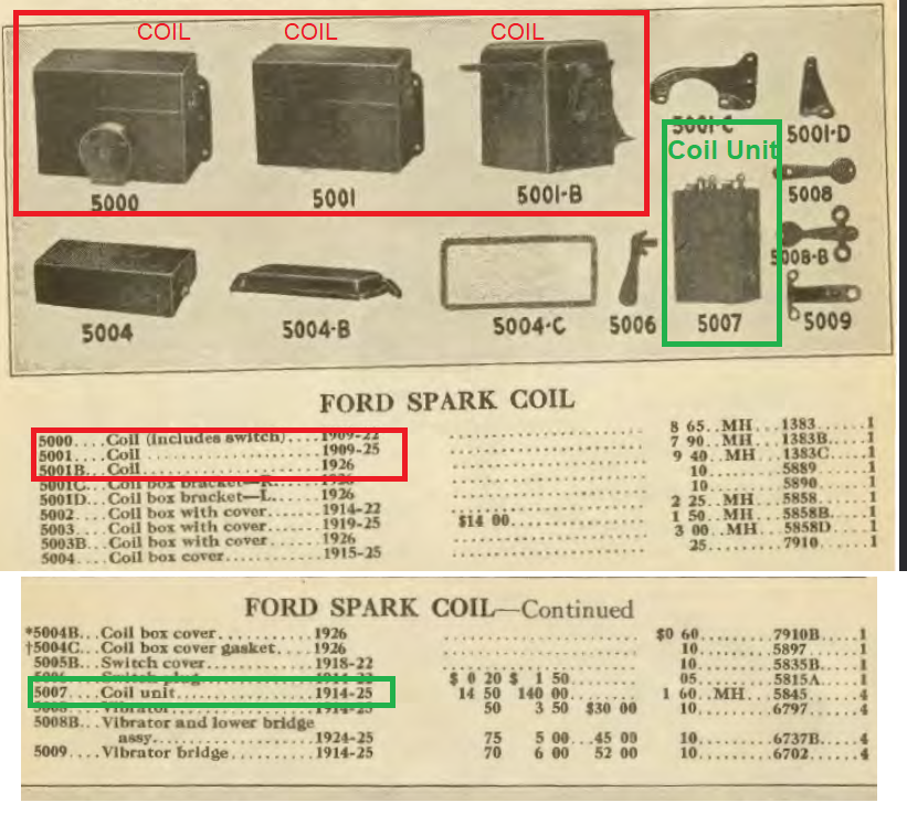

To each his own...
But the Parts Catalogue refers to the box in its entirety as the"coil" and each individual component as a "coil unit". AND then there are "coil box covers" and " coil box brackets" for the "coils" :?

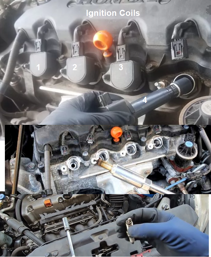

What's interesting is what Modern Car ignitions systems have now

The distributor-less automotive ignition system (DIS)
This system determines spark timing based on two shaft position sensors and a computer. The Crankshaft Position Sensor (CKP) is mounted at the front of the crankshaft or near the flywheel on some vehicles, and the Camshaft Position Sensor (CMP) is mounted near the end of the camshaft. These sensors continually monitor both shafts’ positions and feed that information into a computer.
The DIS also employs a different coil setup as compared to its predecessor. Instead of asking a single coil to power all the cylinders, the DIS uses multiple ignition coils called “coil packs," each generating spark for just two cylinders. As a result, each coil can be “on” longer and develop a stronger magnetic field — as much as 30,000 volts — and stronger, hotter spark that was needed in order to ignite newer vehicle's leaner fuel mixtures.
Coil-on-Plug Ignition System :o
The coil-on-plug (COP) vehicle ignition system incorporates all the electronic controls found in a DIS car ignition system, but instead of two cylinders sharing a single coil, each COP coil services just one cylinder and has twice as much time to develop maximum magnetic field. As a result, some COP car ignition systems generate as much as 40,000 to 50,000 volts and much hotter, stronger sparks.
COP ignition systems have another big advantage over DIS ignition systems. Since the coil mounts directly on top of the spark plug, spark plug cables are eliminated because the firing voltage is delivered directly to the plug. Plug cables mean greater resistance loss of amperage and voltage, as well as the possibility of contamination and cross-firing between cables if they become greasy or worn.

In TRDx82's comment about the coil-on-plug ignition system I agree - sorta. My 'o5 Dodge has the 5.7 liter V8 with two plugs per cylinder does have a coil-on-plug ignition system. The coil on any given spark plug fires it's own cylinder and sends a pulse to the cylinder 360 degrees from it; meanwhile our cylinder's other plug is receiving the "waste" pulse from another cylinder.

To call both "coil box" is less confusing?
I just posted the Ford 1925 parts catalog as a reference to what it called them. (same picture & descriptions in the 1927 pats catalogue)
What's interesting is that the images don't match the part numbers. "COIL (no lid)" vs "COIL BOX with LID" then other parts have the adjective "coil box" to describe them. So the COIL BOX is the container for the COIL UNITS (coils)
