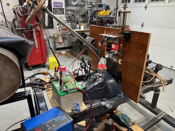

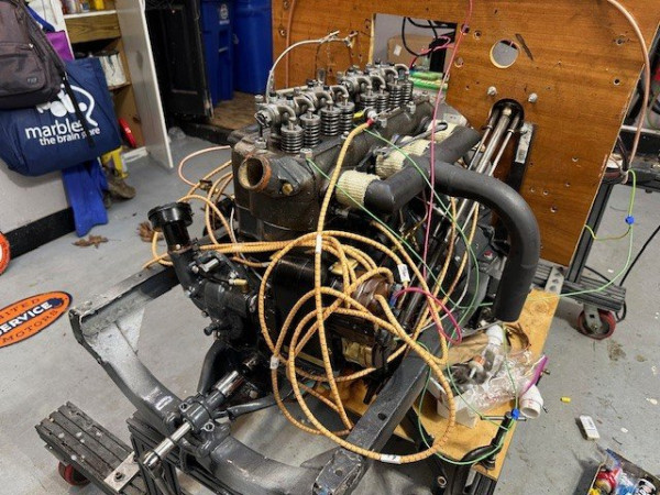

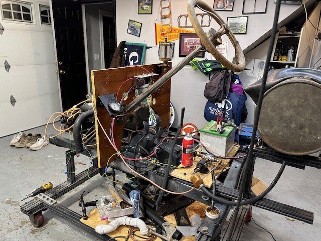

I have been picking away at this project for a couple of years and I finally get to the first start stage, and I am having issues. It was a running and driving engine, had the head rebuilt, and put it back together. Changed from a distributor set-up using one set of plugs to a Bosco ZR-4 to fire both sets of plugs at the same time.
the most I got out of it was a sequential four pops in the last two months. that was long ago. this is where I am at:
* got plenty of fuel, fuel pump, pressure regulator set at what it was for the last time it ran as a complete car.
* plugs are wet and smell like fuel
* get spark to the wire when placed near the head
* no spark at a plug when laid on the head.
* wrapped a wire around the plug for better grounding, nothing different
* tried a good plug out of a car, no spark on this car laid exactly the same way.
I am stumped....
The pics are below. Please ignore the long spark wires, it will all get cleaned up when running

Does your magneto have an impulse coupling?
What is the condition of the mag? Rebuilt? Recharged magnets? Appears as if it's weak, (spark from wire to ground, but not through plug electrodes.)
Timing correct? TDC compression versus TDC exhaust?

Yes it has an impulse and I can hear it click off and it was rebuilt by marks this year.
I also have I hooked to a battery connection and grounded

What are your spark plugs gapped at? Some Bosch magnetos want the plug gaps at about .020, not the usual distributor setting of .032.
A lot of the "antique style" spark plug wire has had some cross firing leakage issues in the past decade or more. So much excessive length will exacerbate the issue, and could cause misfiring problems. Often, such problems will fire okay at slow turnovers making one believe there isn't a problem. But once rpm surpasses about 10? Spark begins landing anywhere but where you want it. It is often interesting to look at the wiring in a dark shop at night with the engine running. The amazing thing is how well an engine might run with ignition going every which way. And sometimes they don't run.

"I also have I hooked to a battery connection and grounded". ??? The mag should not be hooked to a battery or voltage source. There should be a ground wire connection on the point cover. To kill the mag, this wire gets shorted to ground. Otherwise not connected when running. \How did you time the mag? The impulse should trip slightly before TDC on the compression stroke. Just popping might be the case of really late timing. What do you have for a mag coupling to adjust the timing? FYI, the mag should fire when the points just break open.

I have an adjustable coupler, using 4 set screws. Been all over the place around the timing at TDC. I have a boroscope that look at the bore. It is timed right now for when the piston is just over TDC the impulse clicks off.

I see the wires are old style, but are the wires copper or steel core wire? I know magneto dont like modern fiber plug wires, just something to check,
