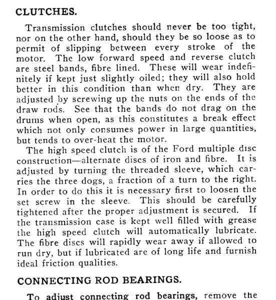

I have a 1907 engine and transmission that is ready to go into the car, but the transmission needs to be adjusted. I’m not sure how to do that. Can you guide me to someone who may be able to help?
