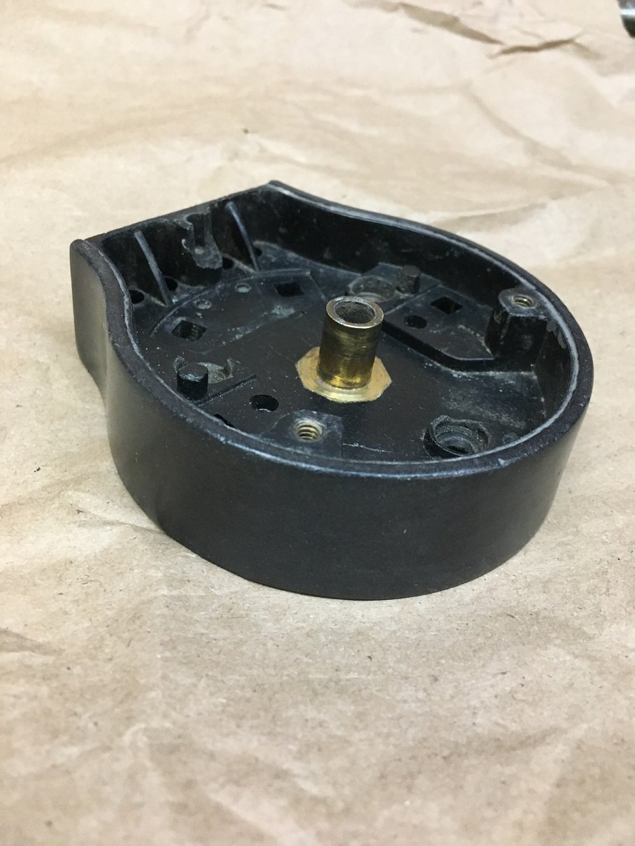

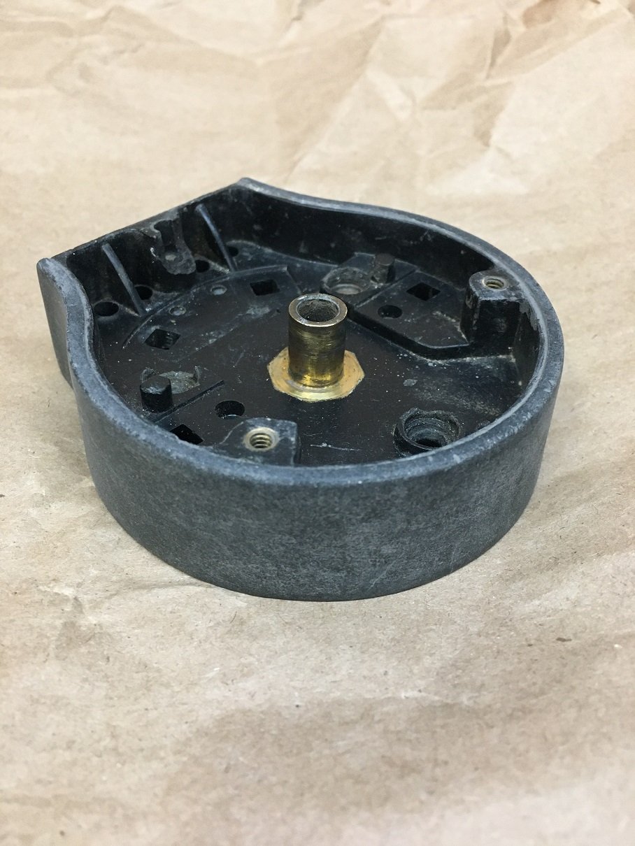

I need some advice on bringing out the black color on this original 1914-18 ignition switch body. I sanded the outside to even out the surface imperfections by wet sanding all the way through to 2000 grit. The surface is smooth, but alas, not ending up black. The hard rubber up to this point is not taking on any shine. Sooo, my question is what have you used as the next step to finish bringing the appearance of the switch back to its original condition.

What does it look like if moistened? Perhap some sort of clear matte or gloss coating might mak it look the way you want it to? Does anyone know how they looked new?

If you wet a spot, does it look good?
If so, as simple as a coat of satin clear lacquer spray.

Have you tried a rubbing compound? Maybe try some 3-4000 wet sanding paper.

When we are restoring similar items to a Fine-point adjudication quality on Model-As (Steering Wheel, Terminal Box, Wire Plugs, etc.) that used the same material as this switch, we use several applications of paste-wax Kiwi brand Black Shoe Polish to bring back the correct sheen. The wax actually absorbs into the item, and we often use a Nitrile glove and a finger to work it into the pores. A terrycloth towel is used to buff the excess off. Generally 2 - 3 applications makes a nice smooth finish, and it won't smear off onto your hands (-think 26/27 Steering Wheels

Many thanks to all the responses concerning my request for solutions to bringing out a nice black finish to my original hard rubber ignition switch body. As a follow up, I took the suggestions of Brent T and Larry S and used a wax polish and it worked just fine!
