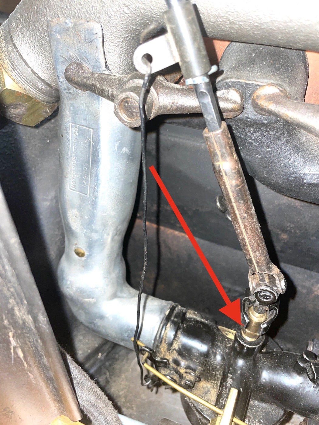

How do you tighten a late carb needle? The carb is a sway back NH. The car is a '14 with the large brass disk on the other end which adjusts itself as I drive and not always the way I feel it ought to be adjusted. Lately I have been using a block of packing foam to hold it in place.
The '23 also with a swayback NH has a top nut that has grooves so it will tighten the needle as the nut is tightened into the casting. This nut has no grooves and does not tighten the needle no matter how hard it gets tightened.

The arms press on the nut and not the needle unless I'm missing something. How would that keep the needle from migrating to a new position?

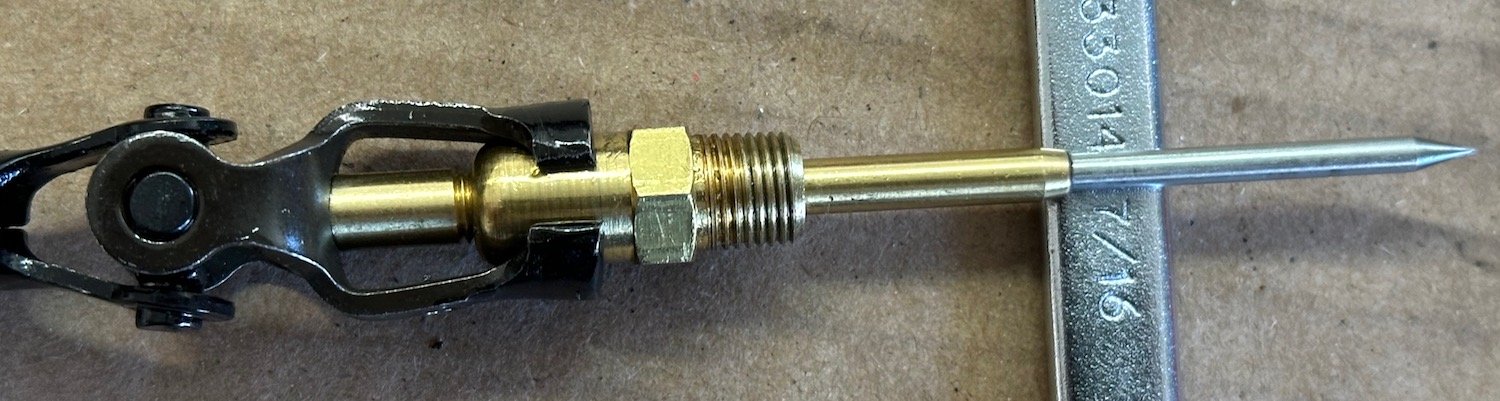

The arms are part of the cross piece attached to the top of the needle. They are a unit. So just wind the needle out and pinch the sides in a bit. Job done.

As posted by others, crimp the fingers over the cylinder of the lock nut to tighten drag of the spray needle. Easiest done by removing the needle, crimp some, re-fit needle , remove again and test and crimp to get the right tension.

Thanks everyone, once I took a second look I could see what was happening and understand what needed to be done. No amount of clamping with the biggest channel locks I have would compress it enough to make any difference so the next step will be to remove the assembly and use the big vice. If that doesn't do it . . .

Paul, once you remove the needle from the brass nut, the fingers are easily bent to tighten their grip. Using channel locks with the fingers around the brass nut will do no good, but you already know that.
