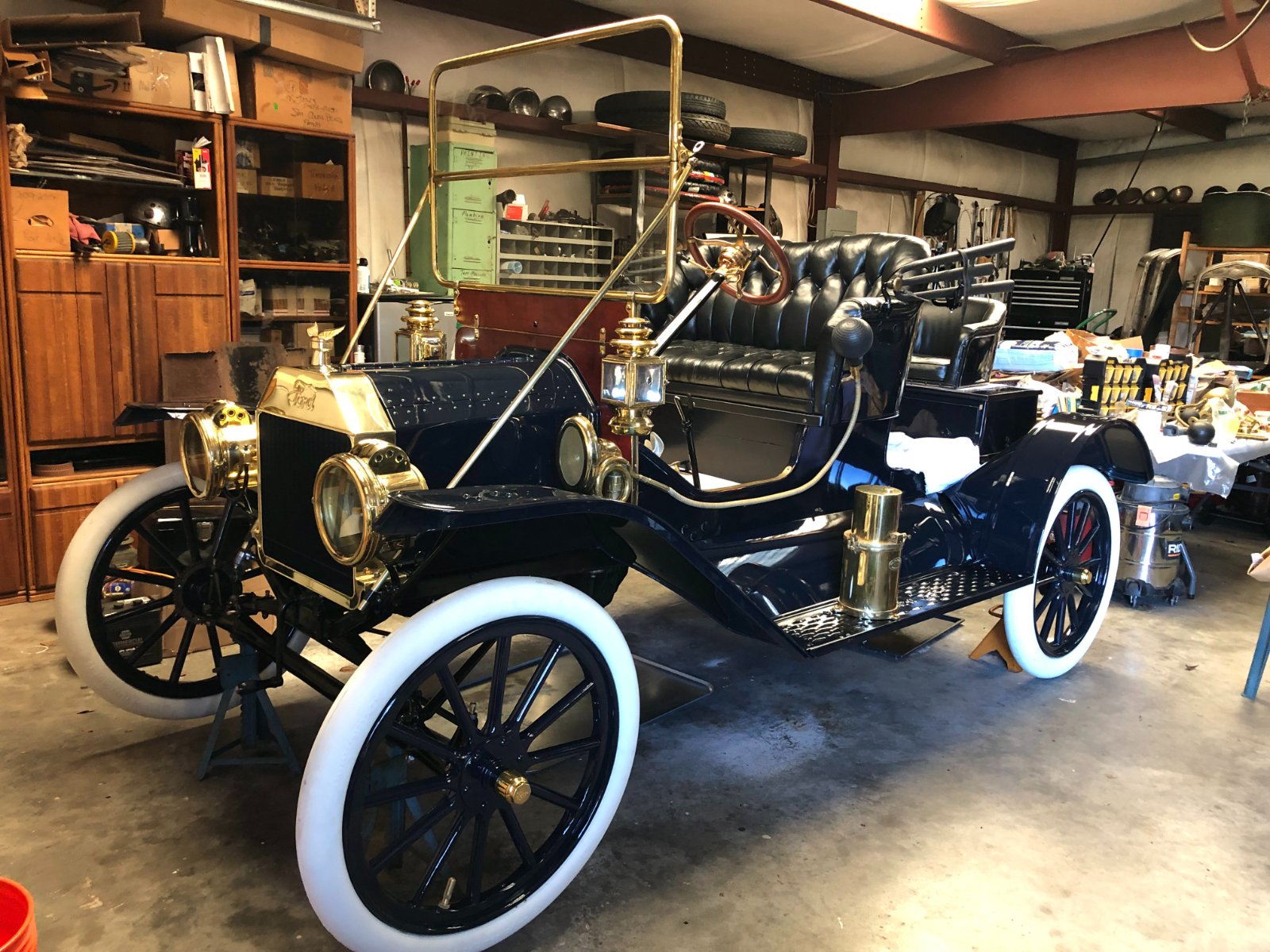

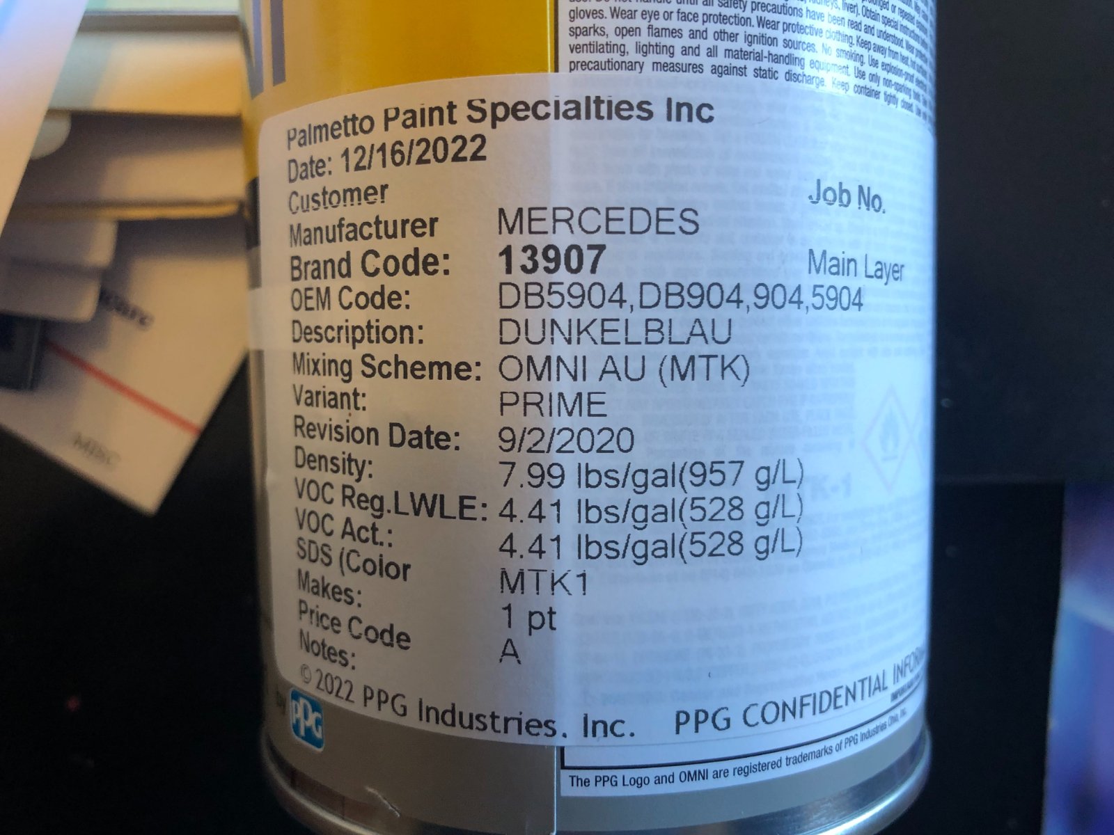

Brent,
I don't know if this helps but here is the label for my Midnight Blue as I used on my 1912 Roadster. It's got OEM codes, but no formula and it was done in OMNI single stage. Picture of my roadster although you can't tell much due to the lighting. But it is a dark blue. The fluorescent lighting makes it look "bluer." I asked several "experts" and did a lot of research, and pretty much all said to use the DB904. I know some go even darker or lighter but the "old guys" advised me to use the DB904. Is it absolutely correct? Sure......

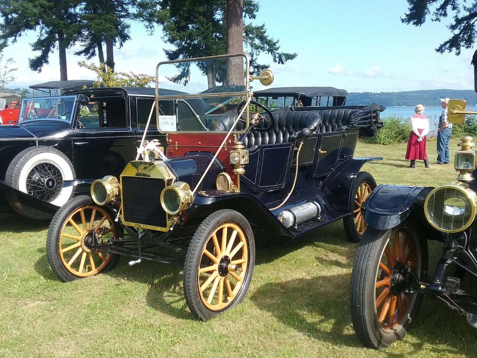

The DB904 if a very pretty blue, but my choice is a little darker DB332:
Diamont Uno 4635 A Mercedes DB 332 (ca. 1963-1967)
Use PPG Non-Sanding Epoxy Primer DP90LF as an undercoat
Pint: am’t (g) acc color tint
SC01 44.8 44.8 Base
SC10 70.8 115.6 Clear
SC46 41.8 157.4 Green shade Phthalo blue
SC25 87.0 244.4 Carbon black
SC54 226.1 470.5 Blue shade Phthalo green
SC99 7.2 477.7 low strength white.
Keith

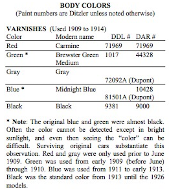

Whenever this subject comes up I point out that names are not a dependable reference. One company's Kelly green may be another company's Envy green. Specific formulas are better. With modern technology a paint company can also match the original color scanned from an original body part with a spectrometer. This page from McCalley's encyclopedia lists specific formulas.
The part about green and blue being almost black is apparently unknown to many owners and restorers.
I've read that some 1914 cars have been found with blue on them.

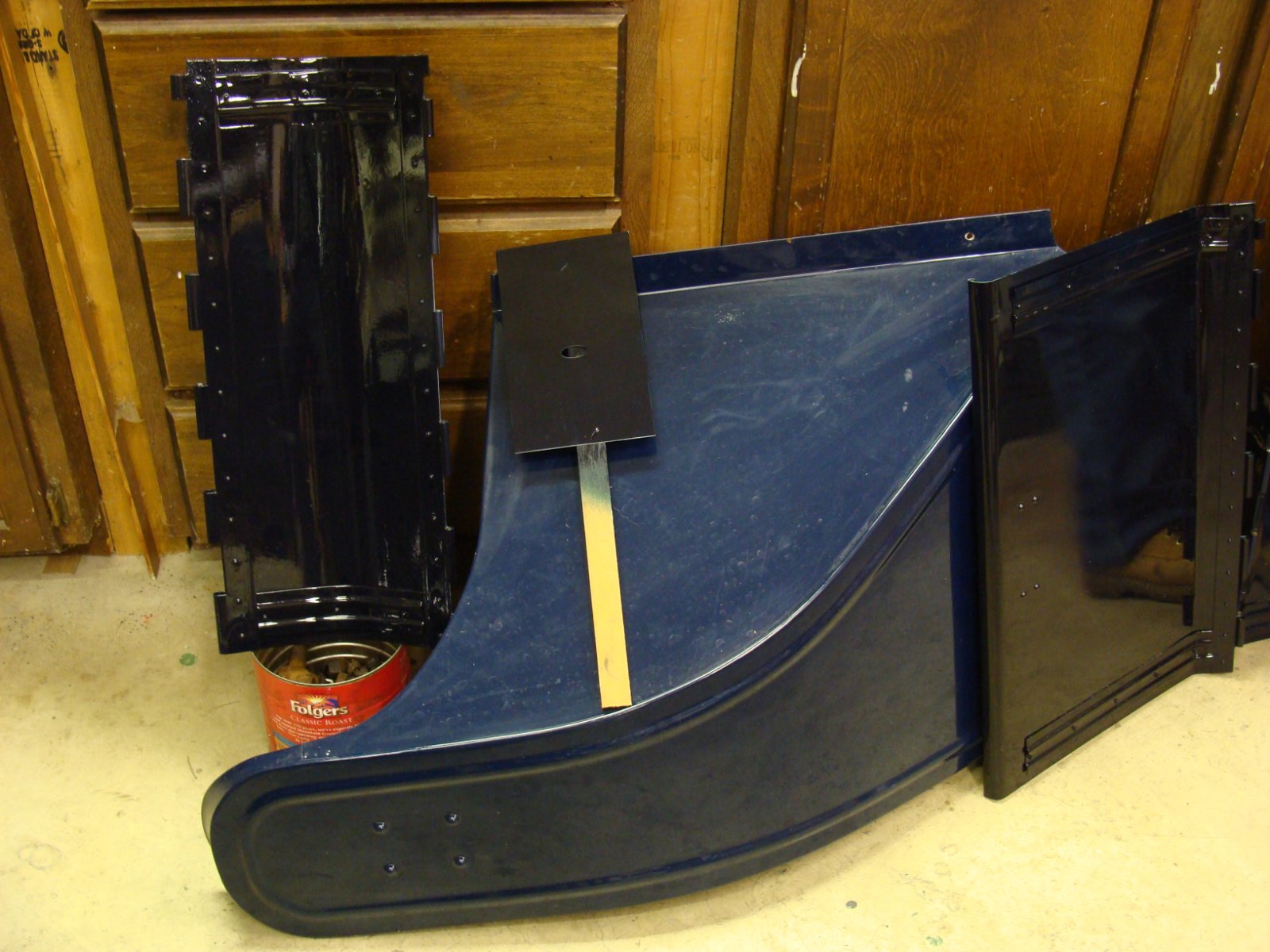

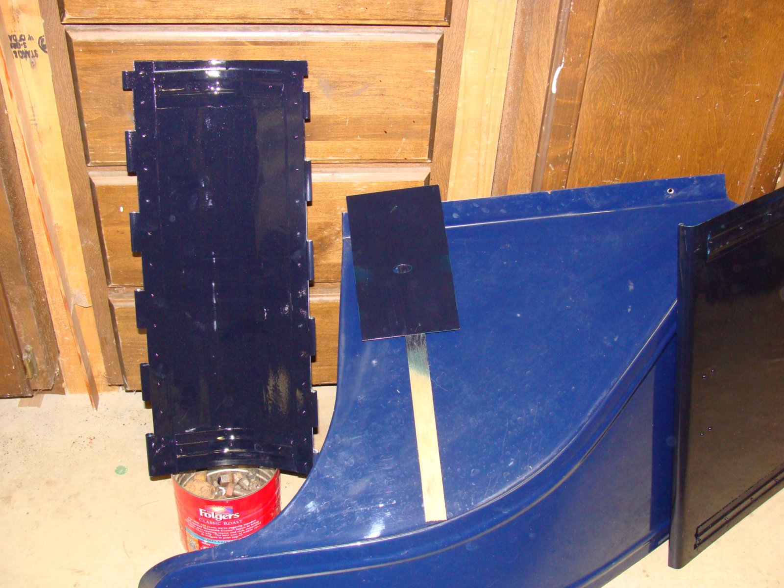

The fender is this photo is Dupont 81501A.
The hood sections are Diamont Uno 4635A (BD 332)
Even without the flash, the Dupont color is far too light.
YMMV
Keith
