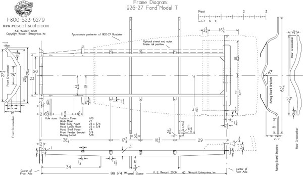

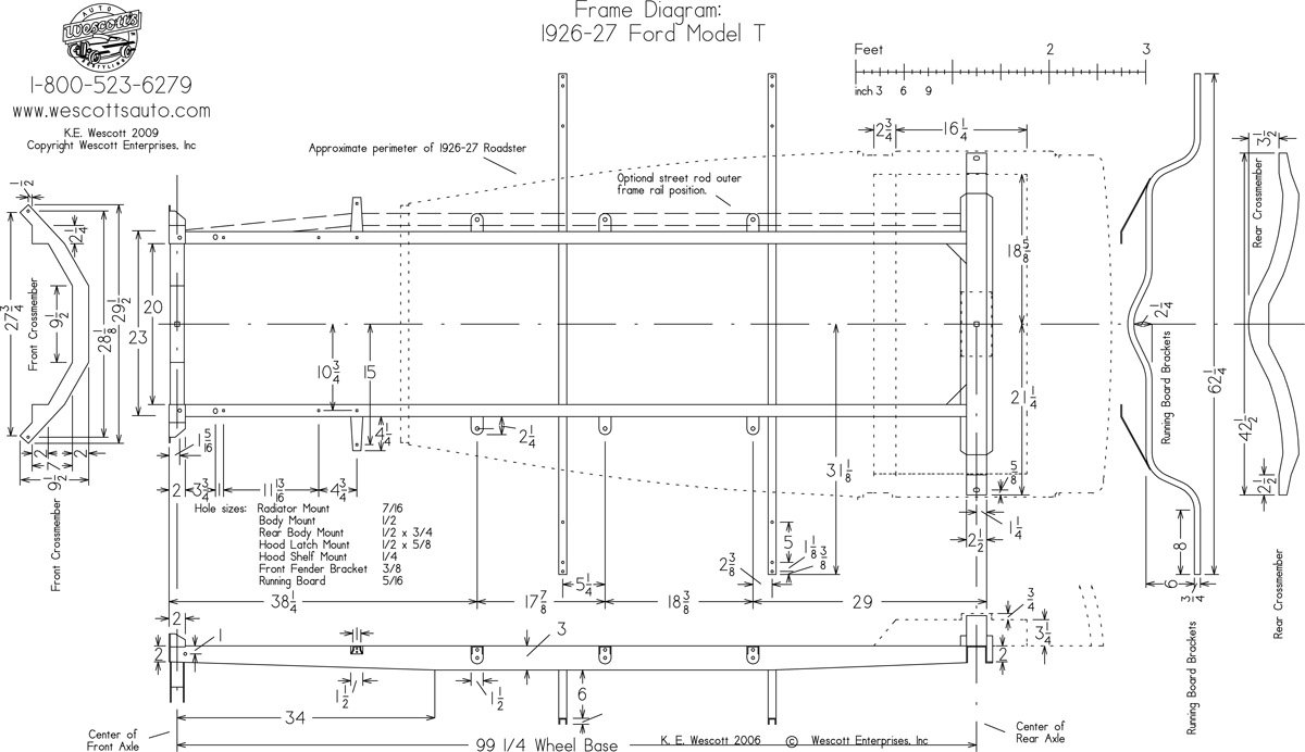

Just to make sure all are on the same page the link has part numbers & pictures https://www.cimorelli.com/mtdl/1926/1926bplmay.pdfBarnesvilleT wrote: ↑Sun Nov 03, 2024 8:28 amDoes anyone know if the sub frame from a 1926 T Coupe will work
for a 26 Roadster?
Bill H.
Chassis
