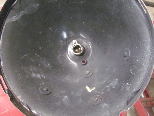

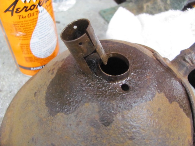

Those early lamps used a single filament bulb, so the collar in the hole has adjusting slot positioned for the screw drive adjuster of the bulb socket. Later lamps use the Tu_lite bulbs, with dim and high beam filaments, so the side screw type housing came about.
Early lamp
Early lamp housing
Later lamp , note the slot for the adjusting tab on the bulb socket, that slot has to be oriented to the tab of the bulb socket
IMG_2002 (640x584) (560x511) (550x502).jpg (135.74 KiB) Viewed 1710 times
The collar fitted to the bucket is sort of pinned or pinched, it determines the position of the lamp socket. That collar has cutaway for the action of the socket going in and out to adjust the beams.

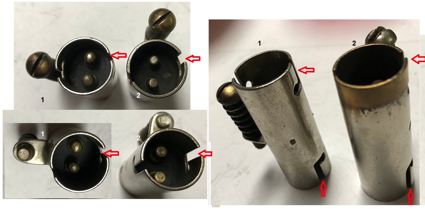

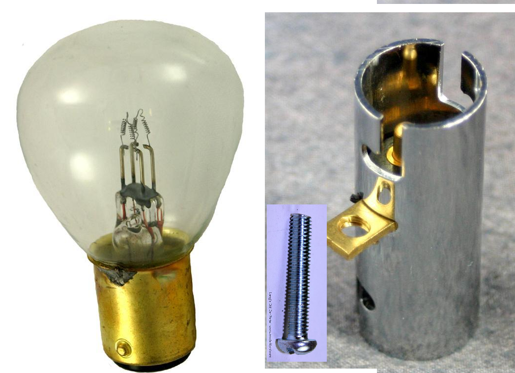

There is another other subtle difference that has done unnoticed. An original double filament 6V bulb has two "A" shaped filament such that the pins in the body would cause these to be oriented horizontally when inserted into the headlight socket. This configuration is a BA15D (BAY15D has two offset pins).
I have two different double contact sockets, such that the orientation MAY be compatible with the different position of the headlight adjusting screw location. I came across the difference in cleaning up a bunch of sockets. I just came across some 1915 headlights that I have yet to take apart to confirm a difference,
As you can see the two different adjusting screw positions result in their contacts being in a vertical position. So moving the screw may require a different socket if the headlights can't be focused correctly.
There were some 1915 headlights in my Barn Find. I will need to take them apart to see what sockets are being used.

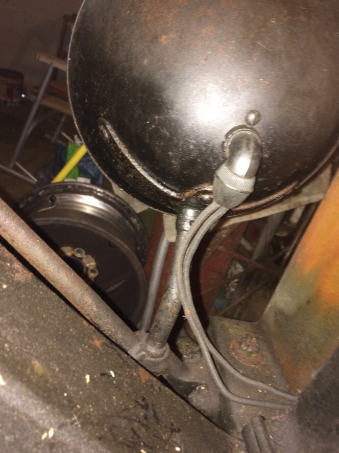

For 1915, 1916, and into 1917, the headlight focus screw is at the 12 o'clock position:
1915 headlight E&J model 440.jpg (22.95 KiB) Viewed 1514 times
Notice the contacts are in line with the focusing screw.
If right angle headlight connectors are used and the wrong sockets are used, the right angle headlight connector will sit 90° off
1915 headlight sockets & plugs.jpg (30.89 KiB) Viewed 1514 times
1915 headight plugs.jpg (30.46 KiB) Viewed 1514 times
