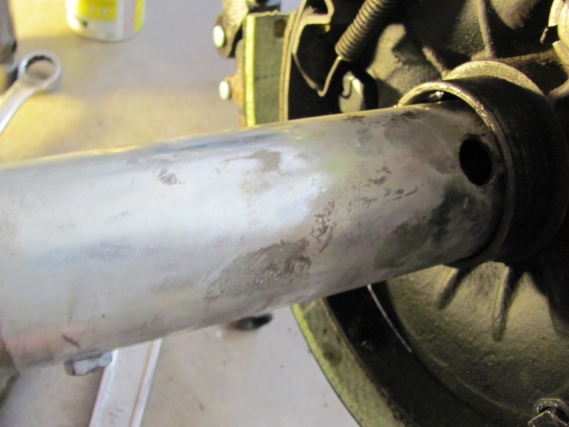

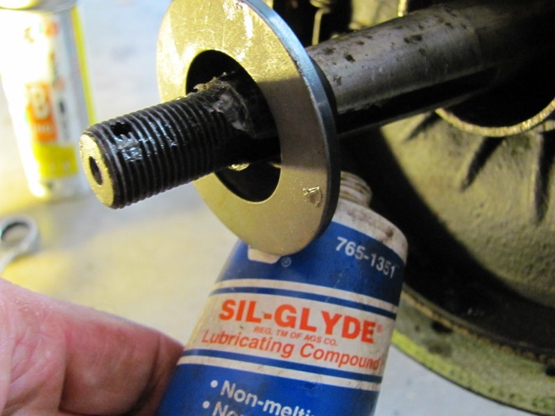

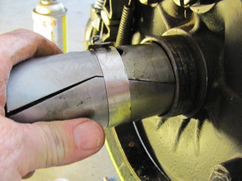

Yes. You have the process correct. Have used the sleeve puller to place the neoprene seal, just push it in with the outer non button end of the puller. Pre-grease the neoprene seal so it slips on the axle easy.
Then place a radiator gear drive hose clamp around the sleeve to collapse it some for slipping it in , align the bump on the sleeve to the recess in the housing

Sometimes the sleeve will not fit all the way in. Check that the bearing will go in all the way and then cut off a small amount of the inside edge of the sleeve till it will slip in to where the dimple fits the hole and the hole mates with the grease cup.
