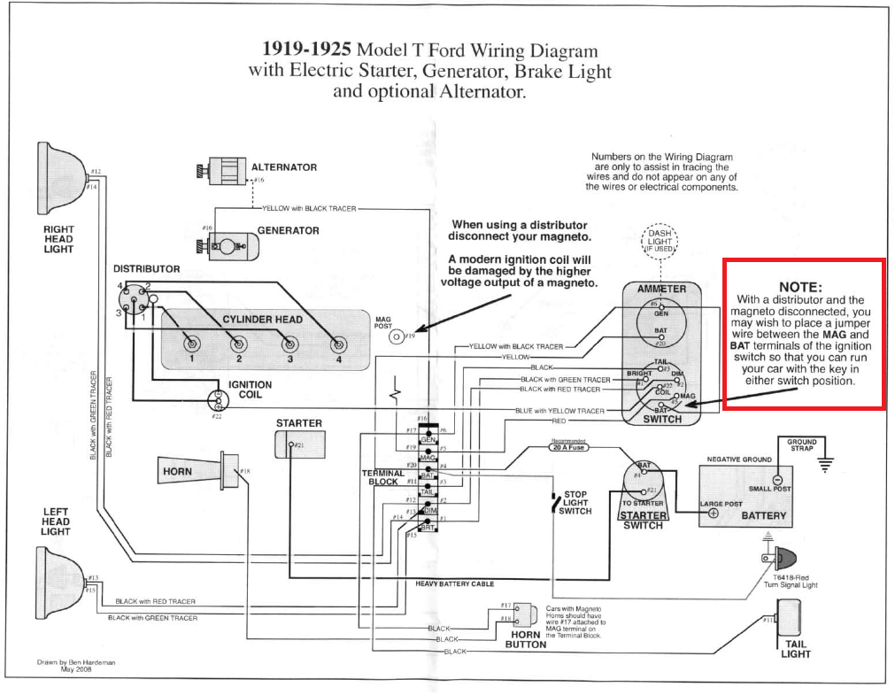

Compare your wiring to the diagram - you may have the jumper as described in the red box

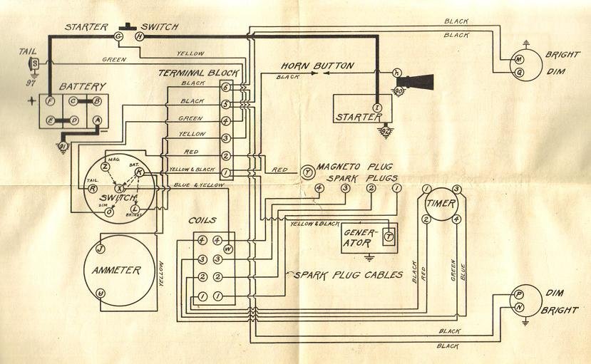

It would help to know exactly how you wired your T. Is it like this? This diagram also implies that the headlights (dim & bright) only work off the battery. What do you get if you disconnect the wire from X to W - do you still get continuity as before. Frank

Thanks, Frank. Yes, it's like that with the exception that my generator is self-grounded with a jumper right now and "T" is unconnected and insulated. Disconnecting at "W" makes an open between KLOR and X. Also, taking the coils out does the dame thing. That's why I'm thinking there's continuity through the coils to ground when the timer rotor/roller happens to be grounded. That would make the headlamp wires and coils both tied to ground, and therefore show continuity between KLOR and X when the light switch is on and the timer rotor/roller is grounded. If this isn't supposed to be the case, perhaps I have a coil short problem. My scenario would indicate that there's continuity between "W" and the timer side (top row) of the "1 2 3 4" coil box terminals.

I confirmed with several coils that there is continuity across the side upper button and bottom button, so that confirms that "X" would be grounded if the timer rotor/roller is in contact. I also confirmed that disconnecting all three light bulbs made the continuity between "KLOR" and ""X" go away; of course, turning the light switch off makes this continuity go away, too. So, I do think "KLOR-X" are tied together through ground when the light switch is on. Then if you have the key on mag, the mag is tied in, too, because of "X-Z". Note that "L" and "O" aren't tied to each other in the switch, either, but rather by the same issue of continuity between then through a common ground.
