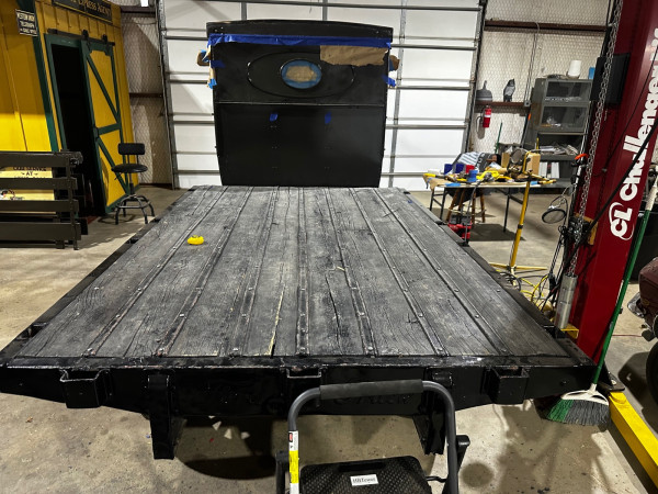

My top replacement for Clarabelle is turning into a more involved refresh. The latest item I’ve decided to tackle is replacing the wood on the ford built flatbed floor as it is getting really rough. The current boards look to be pine, 1-1/2” x 7”. They are routed on the rear to fit underneath the lip of the rear frame member. IN looking at other pictures on this forum, I see other flatbeds where the boards look more like 1” without the routed edge. Can any of my fellow TT owners confirm what their bed wood measurements are.

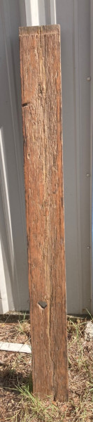

Here is a picture of an original TT stake bed wood piece. Probably not unlike those in your picture. I cut the forward section due to damage. Indeed, it’s pine. Although it’s 100 years old, the dimensions are 1” thick and 7” wide. Zoom into the top of the picture and see it’s been routed 1 1/2” to fit into the ‘Ford Truck’ last crossmember. The board will then extend to the forward edge of the front bed crossmember. The left and right boards are also routed lengthwise to fit the side panel flanges. Many, many years ago I believe I bought #1 pine 2 x 8s and went to planing and routing…..

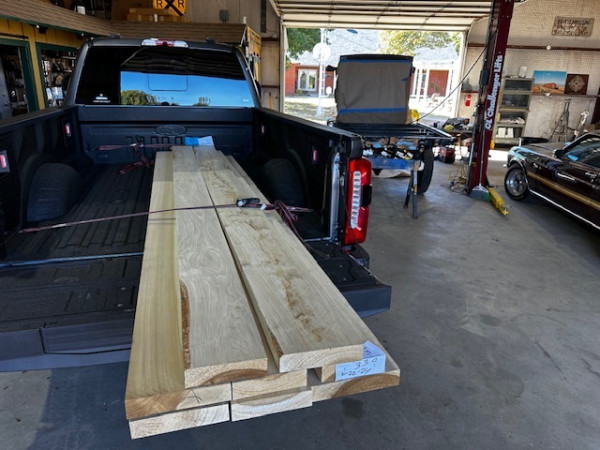

Post by abcarswell » Thu Nov 14, 2024 10:08 pm
I ended up with Poplar as that was the only wood of appropriate size at the local dimensional wood supplier. I’m sure it will stain up nice and I will use my West System coating. I used it on the painted side racks and worked well.
