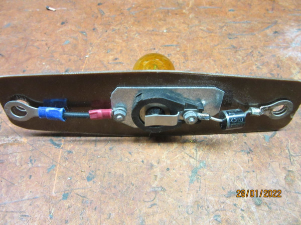

Looking at the hot shot charger pictured, I was wondering how it worked.
As currant comes from the mag does it go thru a diode to keep power from the battery from flowing back thru and demagnetizing the magnets? Also it looks like it has an 1151 single element bulb. Does that help change the ac currant to DC and reduce the voltage so as to not send a high voltage to the battery? There has to be something to do the magic.

This earlier post gives a bit of info, but the charger diode converts the AC to DC and the magneto current is limited by the type of light bulb .

It simply converts the mag AC TO DC and the bulb limits the current going into the battery to try and prevent overcharging of the battery. I don't have direct experience with one so I can't tell you if it doesn't overcharge the battery or not. It's a very simple but effective design if you don't have a generator on your car. Automotive Battery charging does not need clean DC to charge. In fact the old FP voltage regulator used a bunch of power pulses in quick succession to charge the battery.

The primary reason the Fun Projects Hot Shot battery charger circuit design includes the 1151 lamp is to, should the diode fail shorted, prevent sufficient current flow from the battery into the Magneto field winding to discharge the magnets.
