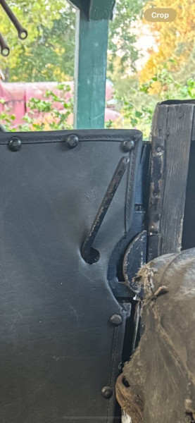

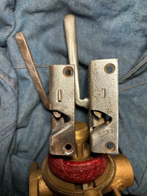

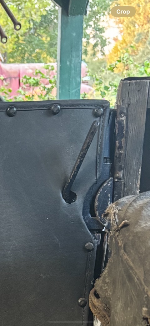

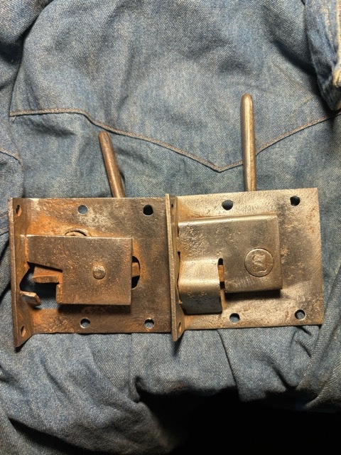

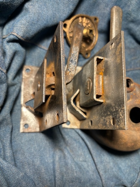

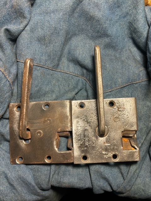

Here are some pictures of the 2 different 1914 door latches.
Both use the exact same strikers and mounting screw locations. Their construction is slightly different but the main difference is where the handle itself is located.
The 2 different 1914 door latch assemblies and why it is important

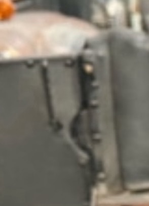

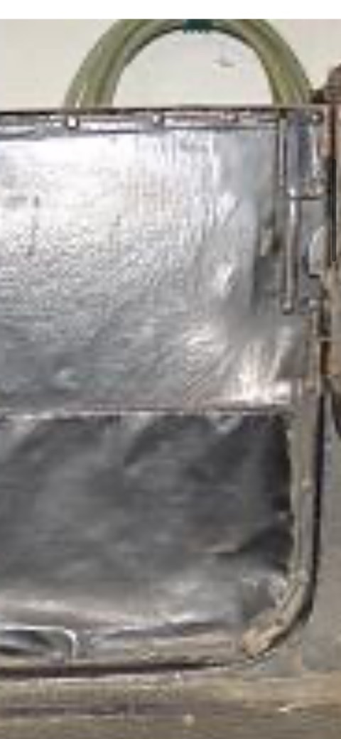

It is important to know in case you are buying a new interior with the hole for the handle as such. I have here a factory photo where the area for the latch is cut out and stitched around. Not sure if they were all like that but if you get a new kit with a hole there is about a 1” difference. It is easy to tell the difference because the one with the longer distance between the handle and the edge has a space and the other is filled in so you can’t see through that area.

Corey, I am glad you found the latch to fit the used interior panel you bought from me. I ended up making paper patterns of my right side panel with the latch/handle location and the drivers side panel for Mike at Classtique who made panels that will fit my 14 perfectly. They are being shipped to me and I should have them today. We are very fortunate to have Mike and Classtique for our Model T and Model A interiors and tops. The loss of Cartouche and Lebaron Bonney has made it impossible to find interiors for the later,(30's/40s) vehicles. I had to settle for plastic panels with no vinyl attached for my 36 Pickup. I can't even find any "chicken tracks" vinyl to cover the plastic panels. At least the plastic panels have the chicken tracks molded in them, it's better than nothing, Art

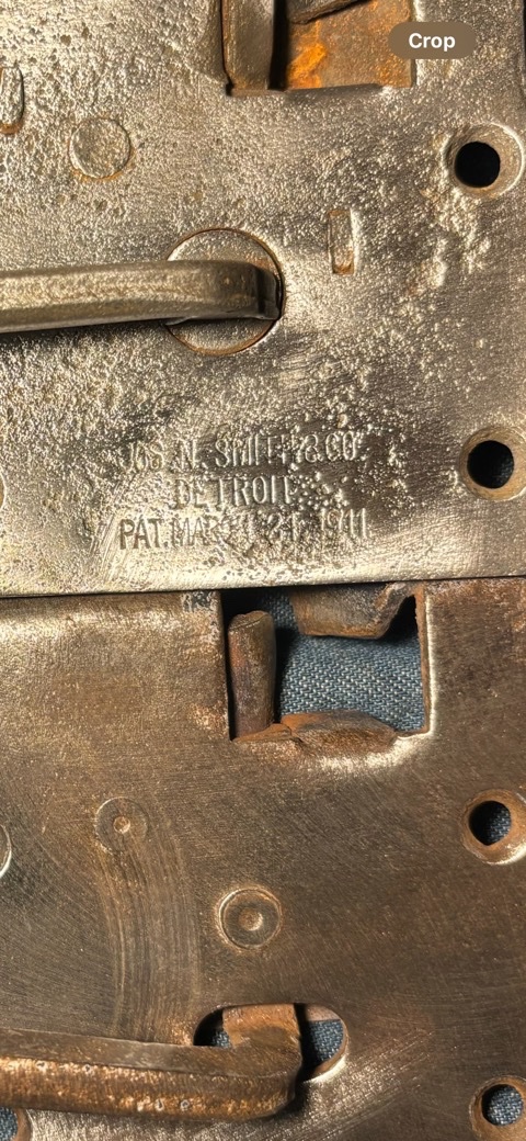

They are both real. The one on the left is later.
