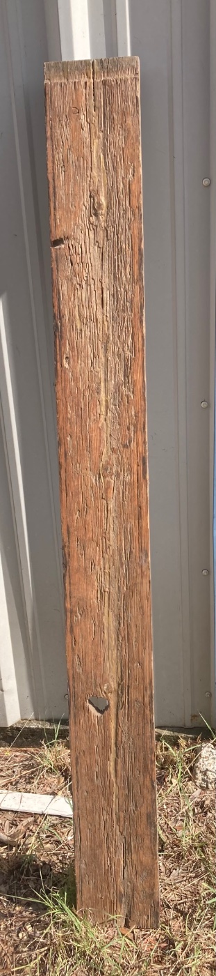

Here is a picture of an original TT stake bed wood piece. Probably not unlike those in your picture. I cut the forward section due to damage. Indeed, it’s pine. Although it’s 100 years old, the dimensions are 1” thick and 7” wide. Zoom into the top of the picture and see it’s been routed 1 1/2” to fit into the ‘Ford Truck’ last crossmember. The board will then extend to the forward edge of the front bed crossmember. The left and right boards are also routed lengthwise to fit the side panel flanges. Many, many years ago I believe I bought #1 pine 2 x 8s and went to planing and routing…..

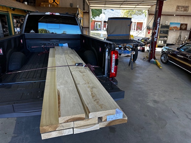

I ended up with Poplar as that was the only wood of appropriate size at the local dimensional wood supplier. I’m sure it will stain up nice and I will use my West System coating. I used it on the painted side racks and worked well.
