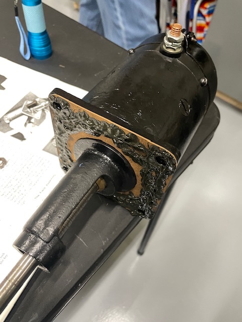

Re: Starter motor mounting screws or bolts?
I brought bolts for mine. The screws were a pain to get out. Just curious, how thick should the gasket be? That one looks alot thicker than the one I brought.
- Posts: 4112
Gasket is paper type T vendor, doubt they vary much in thickness, original were cork and maybe thicker, add some gasket cement to prevent oil leaks.
RecklessKelly
- Posts: 304
- Joined: Sun Sep 01, 2024 8:57 pm
- Last Name: Maxson
- * REQUIRED* Type and Year of Model Ts owned: 1926 model t coupe
- Location: Old Saybrook, CT
I use sealant on all gaskets. The threads sealed also if there are thru holes. A few of them I had to double up with sealant in between to get closer to the original thickness. They were literally "paper thin".

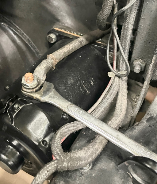

- Posts: 4698
Dan!
I like your 5/8 wrench with the ground down sides for getting to those nuts/bolts in tight places. I’m assuming it’s been ground down. Ive done that a few times.
- Posts: 7312
Dan's modified wrench is something every T owner should have.It needs to be thin enough to fit between the insulating bushing and the cable terminal. The first nut is done up just tight enough that the bolt is firmly in place. When the cable is hooked up and the top nut wound down, the wrench holds the nut while the top one is tightened. This stops the bolt twisting at the contact with the bus bar, protects that soldered joint from being broken and at worst, prevents the bolt actually breaking out of the bus bar.
- Posts: 5609
Thin wrenches are readily available - I have a set from 3/8 - 7/16 up to 11/16 - 3/4 - quite handy for tight spots !
- Posts: 8681
"Tappet wrenches" are good to have, and a cheaper set can have the heads ground back if necessary. They are usually thin enough as they are made.
