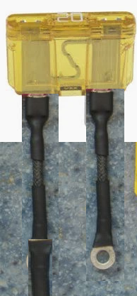

A 20 amp fuse, as pictured here, was installed in the generator by some as protection to your system against stuck original style cut out points.

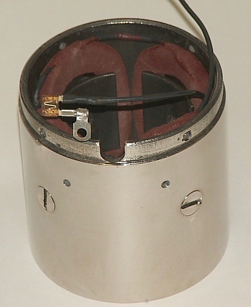

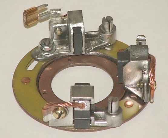

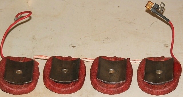

Art, I’m sorry but Ken Kopsky quit ‘customizing’ generators with fuses but said they protect the field coils from burning up. I have 2 more generators I’d like to have fuses incorporated. Ken did relay some pictures to me. Lets see if these help:

The fuse that can sometimes be found inside the Model T Ford generator case as shown in Ken Kopsky's photos IS NOT 25 Amp and it IS NOT to protect the generator from stuck cutout points.
It should be a 4 or 5 Ampere fuse and it is installed to protect the generator in the case of the battery is disconnected from the charging circuitry allowing the generator to destroy itself.

I wrote an article a few years ago describing normal generator operation, how the "building up" process works. See attachement. If no battery is connected the generator build-up process continues uncontroled causing the generator voltage to rise to over 25 volts and a the 15-20 amps current produced in the armature (looking for a battery) but has no where to go. The armature and field windings get very hot very fast. So hot as to melt the solder retaining the multiple armature winding ends in the commutator (ever seen the solder thrown in a circle inside the generator case?) or burning out (burnt insulation on each field winding) one of the four series wound field windings. Either will cause the generator to quit charging and now requires a complete rebuild to the tune of $400-$500.
The fuse we are discussing is commonly installed in series with the wire from the third brush to the 4th field winding (see attached diagram).
If the battery becomes disconnected while the generator is operating the fuse will almost immediately go open disconnecting the field circuit feeding voltage to the four poles. At that point the generator will cease to produce current therby saving it from disaster indicated above.
