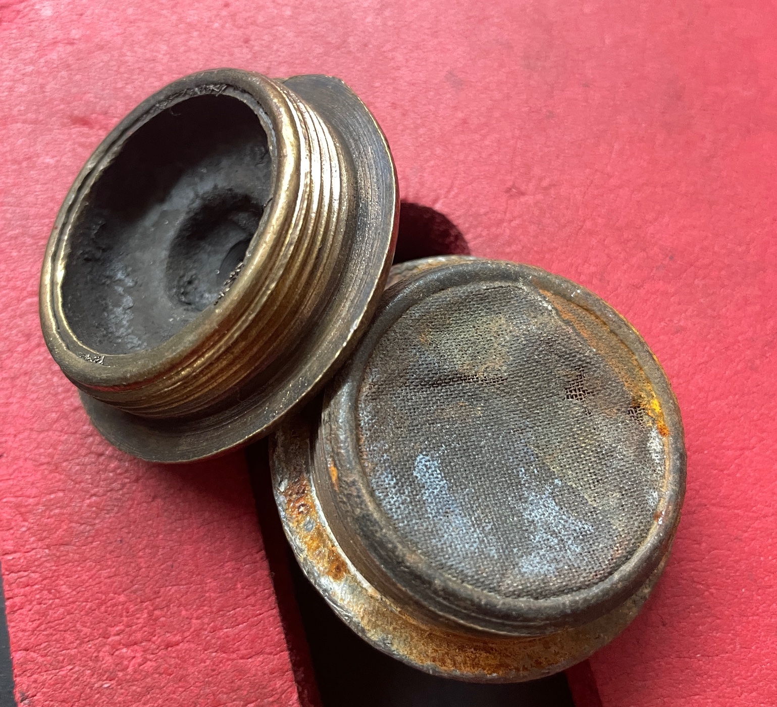

Thought that too when reading, could well be the sediment bowl screen is partial clogged. Happened to me, could not run up a pretty steep hill on tour in VA with my FL flat land touring ;) Ran fine on level or some hills.
Came to find out the screen was partial clogged (photo is another screen) with fine fibers :? Believe the gas cap hole sucked in those fibers from the coarse burlap used to cover the spring set under the front seat upholstery. Over time that burlap gave off fibers, as could see them on the top of the tank too.
Soldered on new screen and cleaned the bowl, full gas flow then.
