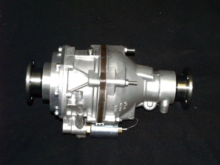

Driving on a road where 50mph is allowed, which is the case on almost all the roads connecting villages, is not very convenient. In no time you collect quite a lot of vehicles behind you and when they start overtaking, it can be quite frightening. So I think of some kind of overdrive to be able to drive 45-50mph without overrevving the engine.
Did anyone try to integrate the Laycock de Normanville overdrive? This quite compact device reduces the rpm by 22% and is very common in older Volvo’s and a lot of British cars. It works with a planetary reduction, so you keep in style. I have some Austin-Healeys and all of them are equipped wit such an overdrive. It works with a built-in hydraulic pump and actuator that is powered by a electric solenoid. These units shift very smoothly. There is no freewheel so the brake in the gearbox keeps functioning.

I'd think the unit itself would be excellent, but adapting it to the enclosed Ford driveline would be a challenge. Aside from the issues of adapting to fit, you don't want to shorten the drive shaft too much, so overall length of the unit and adapters needs to be considered. My car will run all day at 45 MPH, and it has a stock driveline with no auxiliary. The engine is near-stock, with a performance cam. The engine has a stock crankshaft, aluminum pistons, Texas T oiler, and it has been balanced. It's capable of higher speeds, but I limit speed to 45 to 48 MPH in the interest of longevity. It's very happy at 42-44 MPH. I've run this car over 17,000 miles with no mechanical issues. For what an overdrive installation would cost, you might do as well to install a counterbalanced crankshaft and balance the rotating assembly. It would be a lot easier to install a KC Warford than to adapt the Laycock. I'd love to have one in my car. A KC auxiliary and a Pruss cylinder head would would probably allow me to run in the 50 to 55 MPH range. Adding a counterbalanced crankshaft to that would probably allow speeds around 60 MPH.

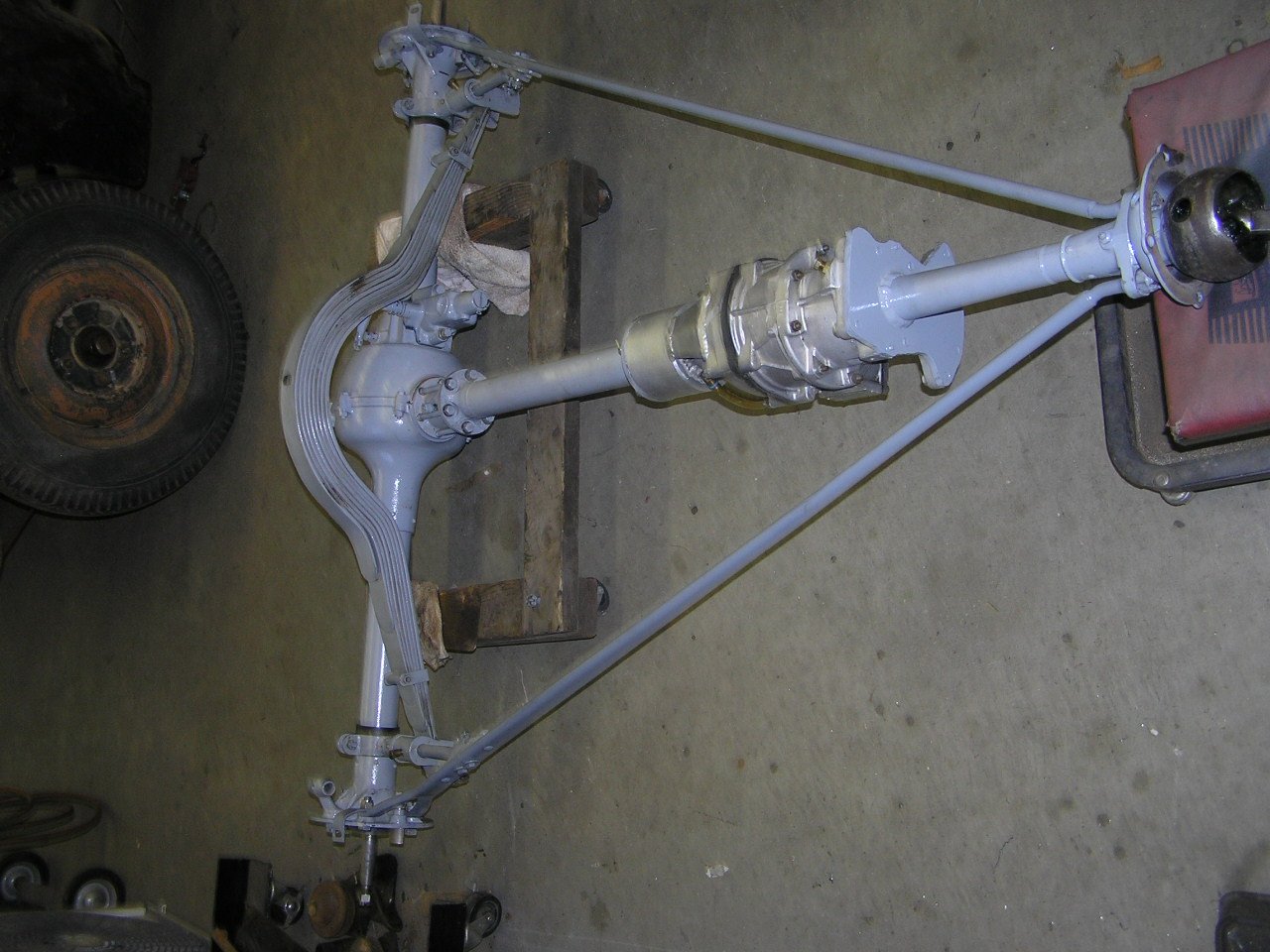

A friend has one of the Laycock units installed. The conversion was done by someone down in California, I do not have any details and he has not got the car on the road to report how well it works. Not sure if those guys are even still doing the conversion.

I have a Laycock OD in my Sunbeam Alpine. Indispensable in that car
But it needs 12v to power it. It takes 17A during engagement and about 3A when engaged.
And they are quite heavy. Would need support if hung off a Model T transmission.
Rootes made their gearbox output shaft the OD input with the eccentric to drive the oil pump.
And the splined propshaft fits directly into the OD output.
That would be more difficult to fit than the type shown, with flanges on both ends.

We have on of these in our 26 Touring with a Ruckstell and a 4:1 rear axle ratio.
It works really well. Our car is still 6 volt and the solenoid works just fine.
You also have a switch that disconnects the overdrive if you go into reverse - apparently they don't like going backwards.

Chris, thanks for posting the name. As close to the rearend as the one I was reinstalling on a shortened drive shaft (was originally made for a stretched T frame), I really don't think it would much more unspring weight then say one of the cast iron over drives bolted to the rear end.

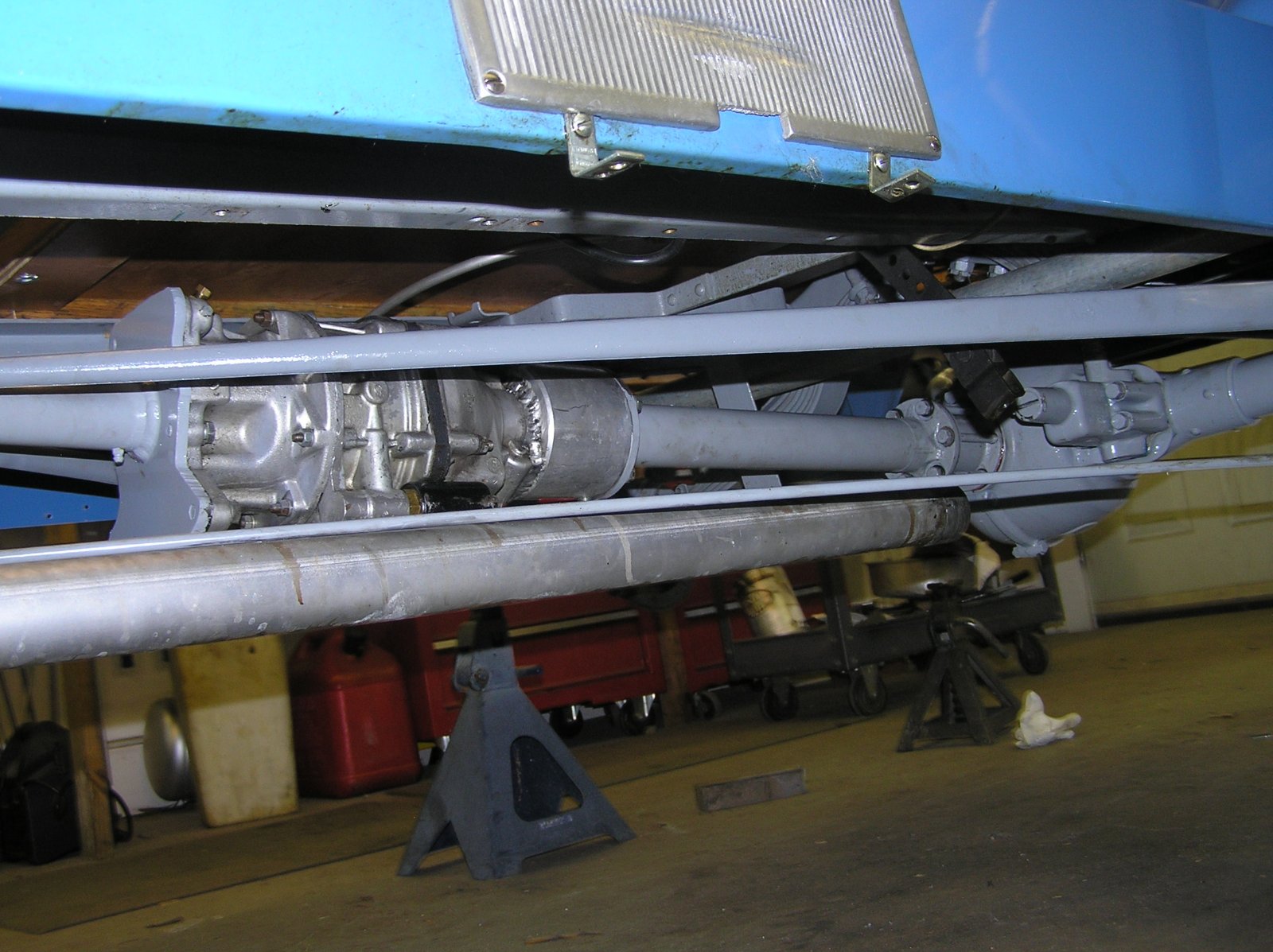

Our T is a 1926, has a Sherman style HC head, a Scat cranck, su carburetor, double exhaust manifold and as a result is quite strong. It also has a Ruckstell with 3.25 ratio, Rocky’s and 12V. So I think much of the conditions for an overdrive are good. Roads in the western part of Holland are flat. The main goal is to take advantage of the strong engine to drive 45-50 with lower rpm. And when the wind is strong or going up a hill, you shift to 1:1 reduction in a second.
My main question is how to integrate it in the driveline. I thought of integrating it in the torque tube/drive shaft as close as possible to the universal joint. But I don’y know if the overdrive likes the vibration and movement of the rearaxle…?

Laycock overdrives are quite popular in Model As and early V8s. Installation issues are the same for a T. I put one in my ABC speedster many years ago and love it. I like it because it is small and unobtrusive. Unless you crawl under the car the only visible sign is the small toggle switch to activate it. Mine was built by someone else but there used to be some folks in California that would do the conversion (try searching "Laycock" at Ford Barn). They come in different ratios depending on the planetary gearset used. I believe the J-type used in the later Volvos were 25%. I used to see them on ebay for $100. Of course adapting one to a Model T is considerably more expense.

This looks very good. So it does not suffer from the movement and vibration? Was there a reason to but it backwards so much? I would say it could be closer to the gearbox.
