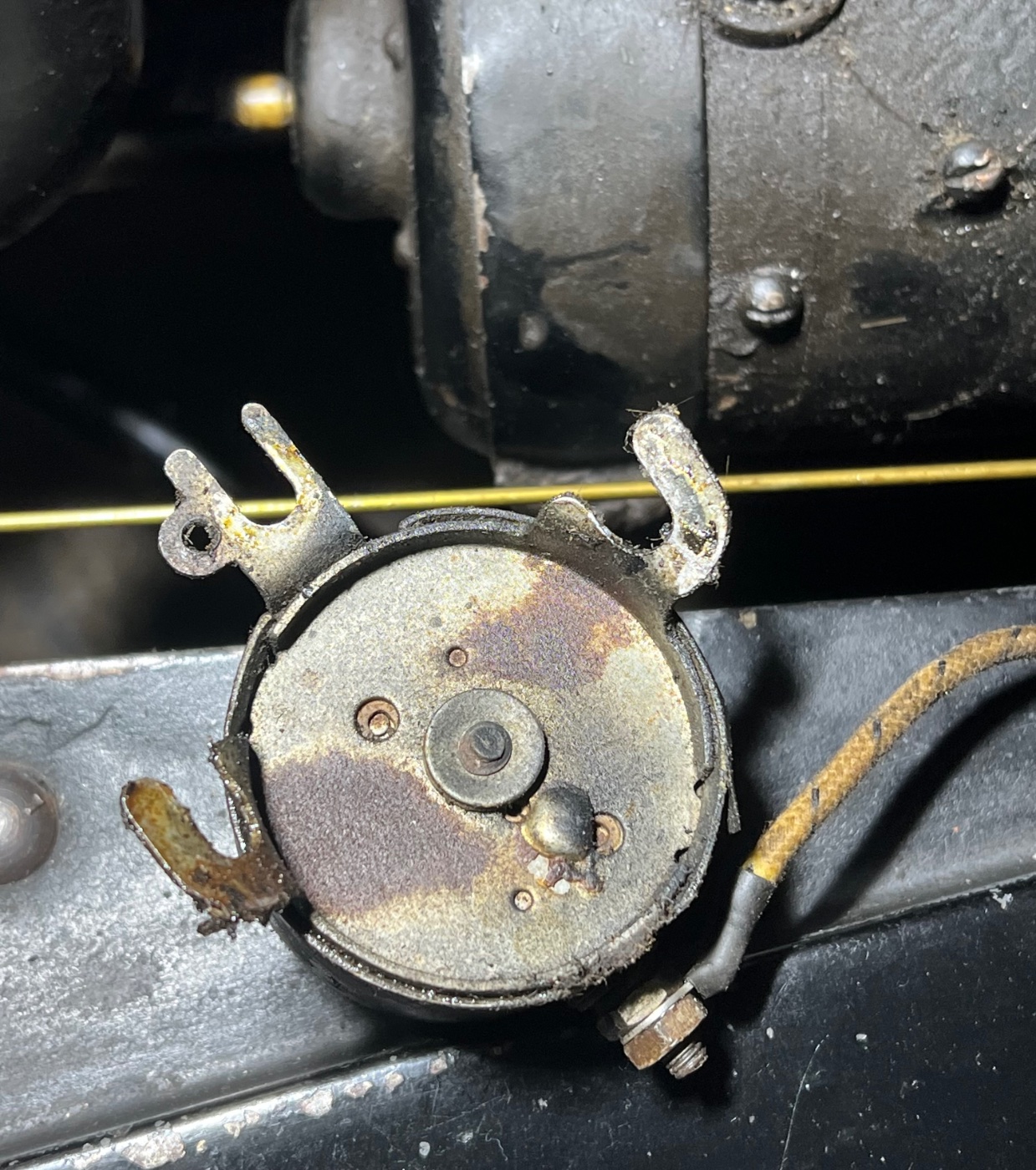

Unfortunately, when we got home, I realized the battery had been installed backwards (reverse polarity). I removed the battery, tested and charged it, and it seemed fine afterward, but I’m not sure if this caused any damage to the car, the battery, neither, or both.
I then reinstalled the battery (this time with the correct polarity) after about 24 hours on a charger. Within 48 hours of being reinstalled, that battery was completely dead as well.
Questions
1. Could driving the car with the battery installed backwards for an hour or two have caused damage to the generator, electrical system, or anything else?
2. Before installing another new battery, should I do any troubleshooting to pinpoint a potential issue, or is it safe to assume it was just a battery problem?

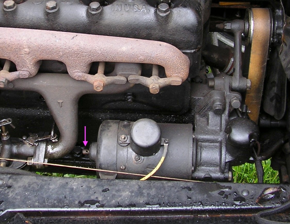

3. I noticed a small brass piece at the back of the generator. What is it, and does it play any role in this situation? (Image.)
I’d greatly appreciate any advice on how to proceed—whether to test the generator, check for shorts, or just monitor the next battery closely. Thank you for taking the time to read this and for any guidance you can offer.

The brass thingy is an oiler for the rear armature bearing. Normal rebuilds use sealed bearings, making the oiler only cosmetic.
You might need to re-polarize the generator. Does the ammeter show a charge when running?. When you have it running, you can check the generator with an analog volt meter @ the gen output terminal. You can check output amperage with an analog ammeter between the cutout & the hot wire running to it.(big yellow wire)
Your fresh battery should not have gone dead. Check for a spark when replacing a battery cable to its terminal.
If so, there is something draining the battery.

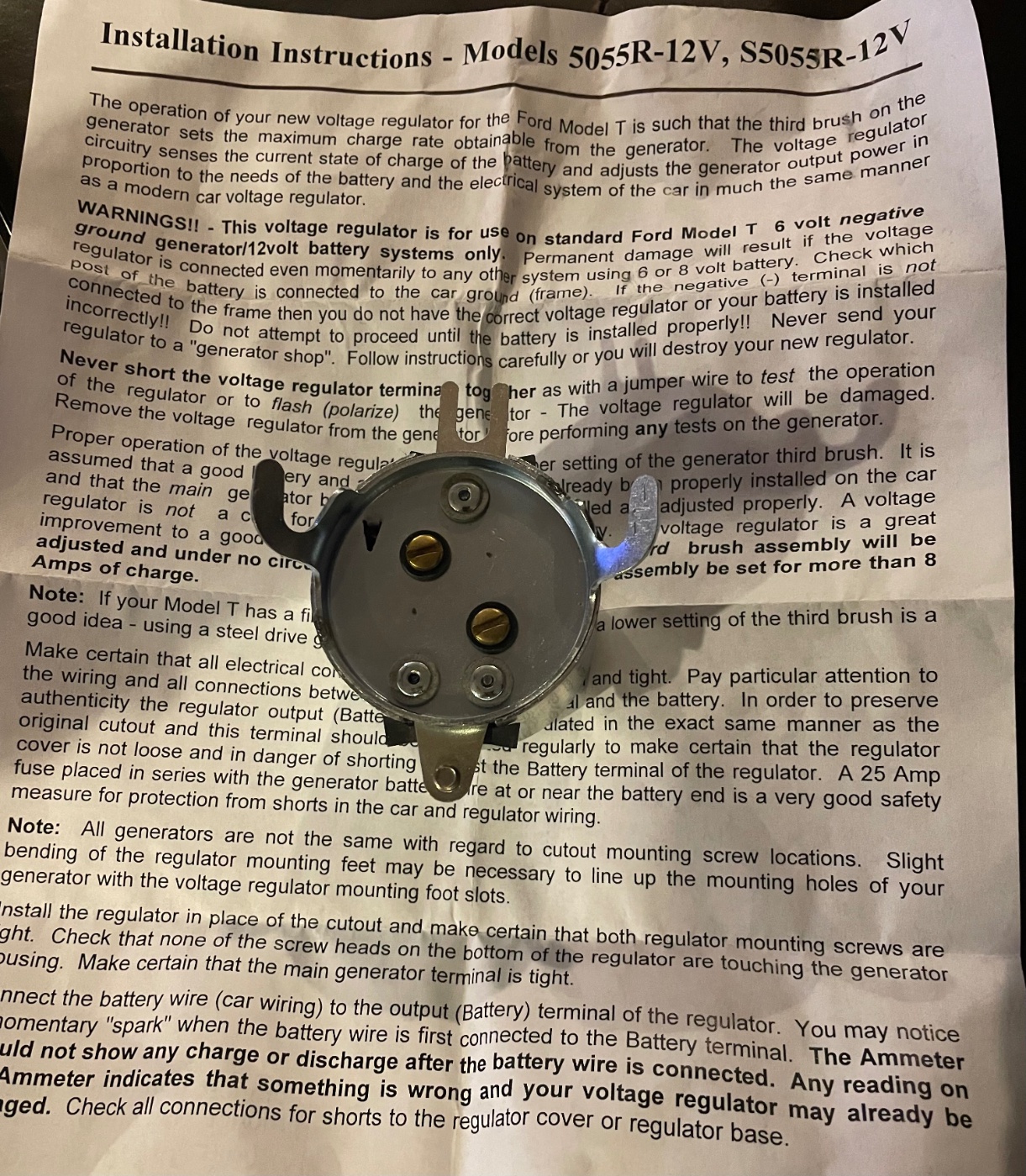

Matt before you try to reverse polarity at the generator please disconnect the battery in the car and then remove the cutout on top of the generator. Take a picture of the bottom of the cutout & post it here. You may have a voltage regulator and flashing it will cause problems with it operating. Don’t ask how I know. Folks here will be able to see what you have and may save you from destroying it.
If the bottom looks like this it’s a Fun Projects voltage regulator. Don’t flash it.

Here is a picture for John. Not sure what this means…. lol

Matt. That's not a Fun Projects voltage regulator. It is an A model cut-out. Next question, does it matter if a cutout for a positive ground vehicle, a model A. is installed on a negative ground vehicle, a model T?

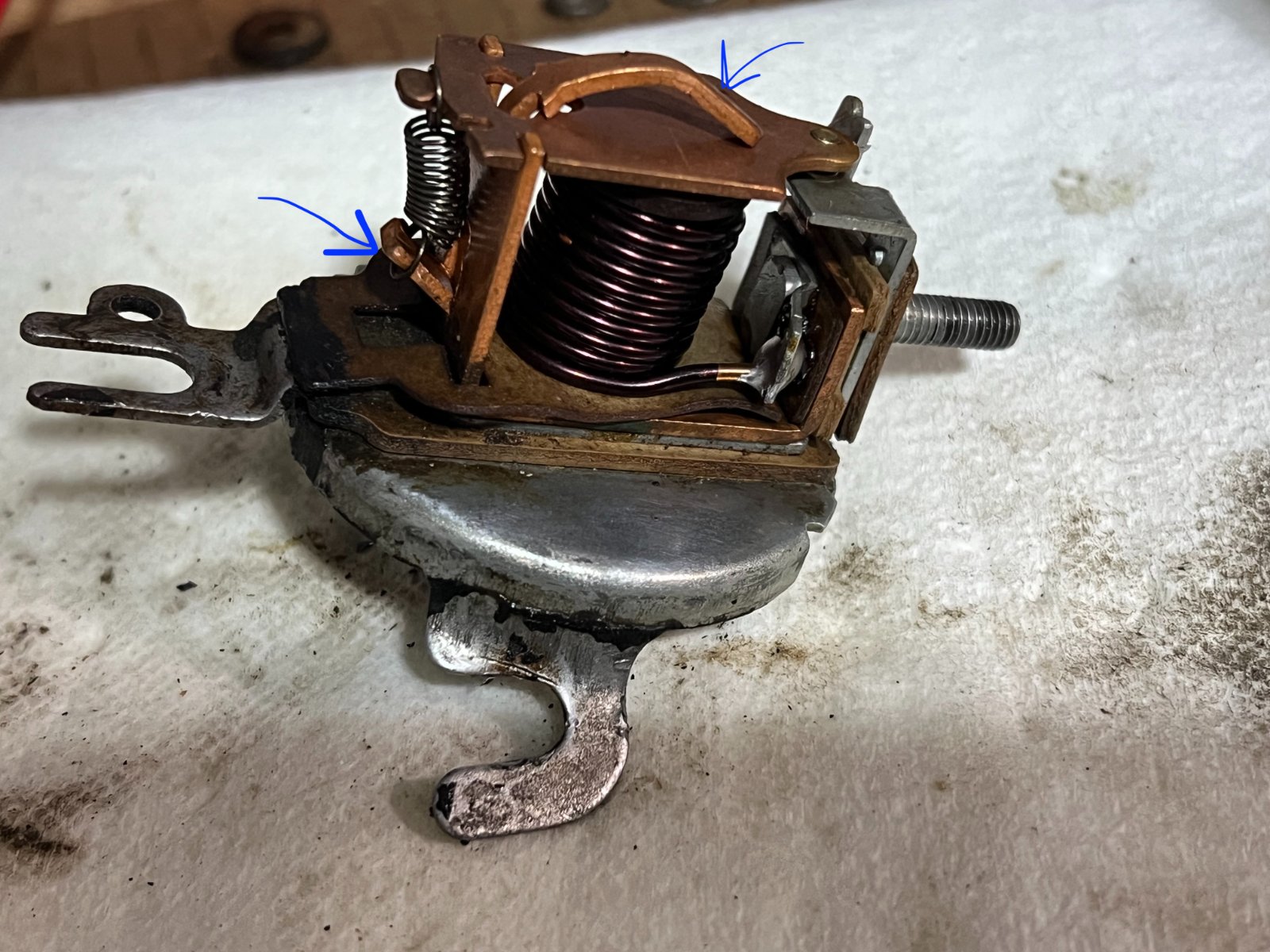

I took the cut-out off the car and on to the bench. Using a variable DC power supply found that the cut out was not closing until closer to 17vdc. Watching the video and a few others that were down that rabit hole, I learned how and started adjusting the cutout (bottom of spring). Later realized that I could either adjust it too high or too low but there just was not a just right. Next I realized that the top of the cutout "maybe" had an adjustment to bring the top point slightly lower and closer to the electromagnet. BINGO!! That enabled the adjustments of the "below the spring" to not be so extreme and enabled a nice cut-in voltage around 5.7 - 6.1 and a cut-out voltage between 4.2 - 5.2. Took around 5 - 6 hours but was actually fun (but no one else in my family realized the pride of figuring it out. Ya'll will :).
Before this post, I didn't know if that was the generator or the starter :). I certainly had no idea what a cut out was or how it worked. Then learned how it works, how to adjust it, and countless other things I learned along the way...
So, end result - no damage from the reverse polarity BECAUSE the cut out was not working... That also explains the drained battery that was swapped out that caused the reverse polarity... YEAH!

Prior to having a laboratory quality DC power supply, I used 4 D cell batteries to set the cut in voltage. The cutout was about 5.7 volts. This worked well until a loose connection at the terminal block caused the generator armature to burn up.

I should have said cut in voltage was about 6.2 volts. The cut out resulted at about 5.7 volts.
