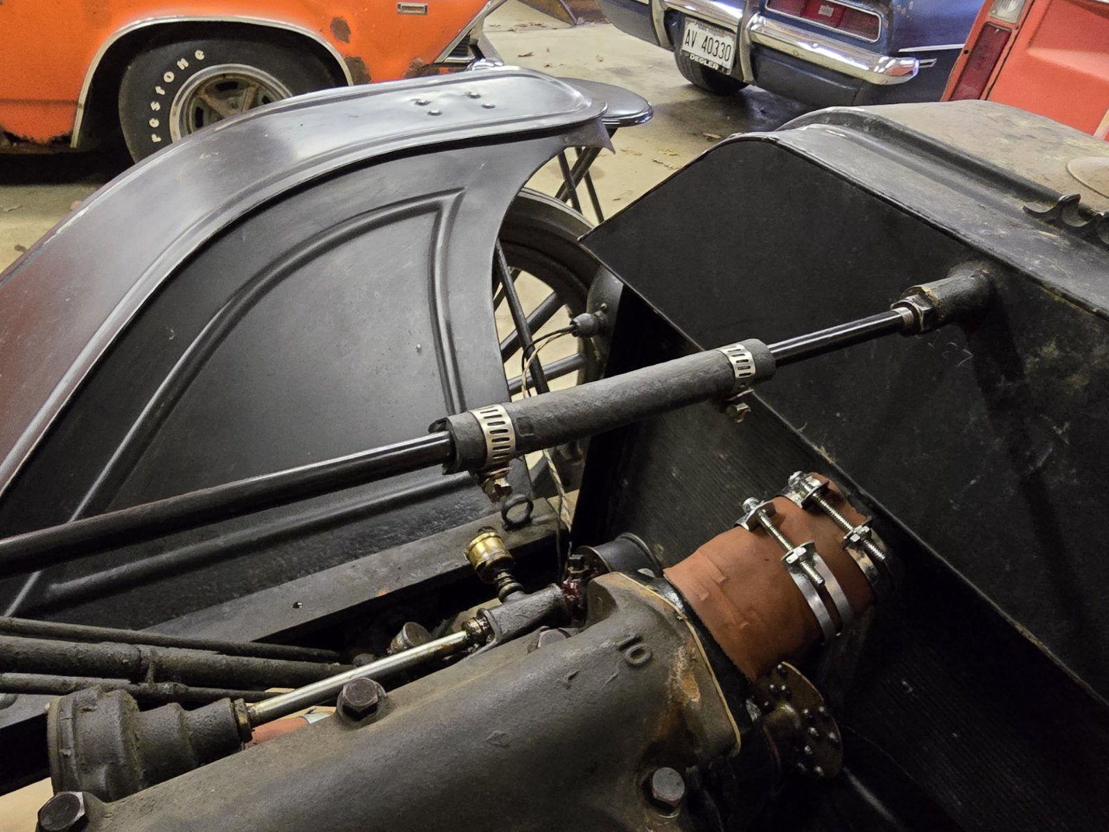

I've had my unrestored 1915 touring for 20 years. I don't know how many miles we've toured, but I've run the wheels off it. In that time, I've had to pull the radiator and fix small leaks every 3 or 4 years. In 2019, I decided I'd had enough of that and made some changes that appear to have worked. I decided to isolate the radiator from any hard loads, essentially dampening as much vibration as possible. The pictures show what I did.
At the frame, I installed two layers of leather between the radiator support and the frame. Instead of directly bolting the radiator down, I used parts from the later mounting design which uses one mounting spring on each side and a retaining cup. When the car hits a hard bump, the shock is mitigated by the spring.
The radiator support rod also got modified. For this, I purchased a reproduction rod from Langs so I could save my original. I then cut a 1-inch section out of the rod and used 5/16 fuel line as a shock absorber. This also eliminates a "hard mount" attachment between the radiator and the car and dampens any shock that tries to enter the radiator. The rubber fuel line, along with the upper and lower radiator hoses are more than enough to keep the radiator securely in place.
Usually, I'm a stickler for being "correct". But in this case, I don't care about that. This car is a driver and I'd rather have the radiator stay together. So far, it's working like a charm.

Be sure your radiator hoses are still pliable, especially the upper one. Some old radiator hose gets hard and brittle. Don't over-inflate your tires, and keep both front and rear springs clean and lubricated. Be sure the engine mounts are in good condition. Stiff springs will cause more frame flex and transmit more road shock to the car. Worn steering parts may add shock and vibration. Keep a little oil on the front engine mount.
The radiator on Model Ts is close to the engine, making the upper radiator hose short and stiff. You can't do much about that, but keeping the hose clamps as far apart as you can may help a little.
