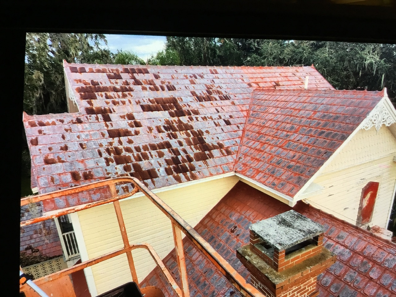

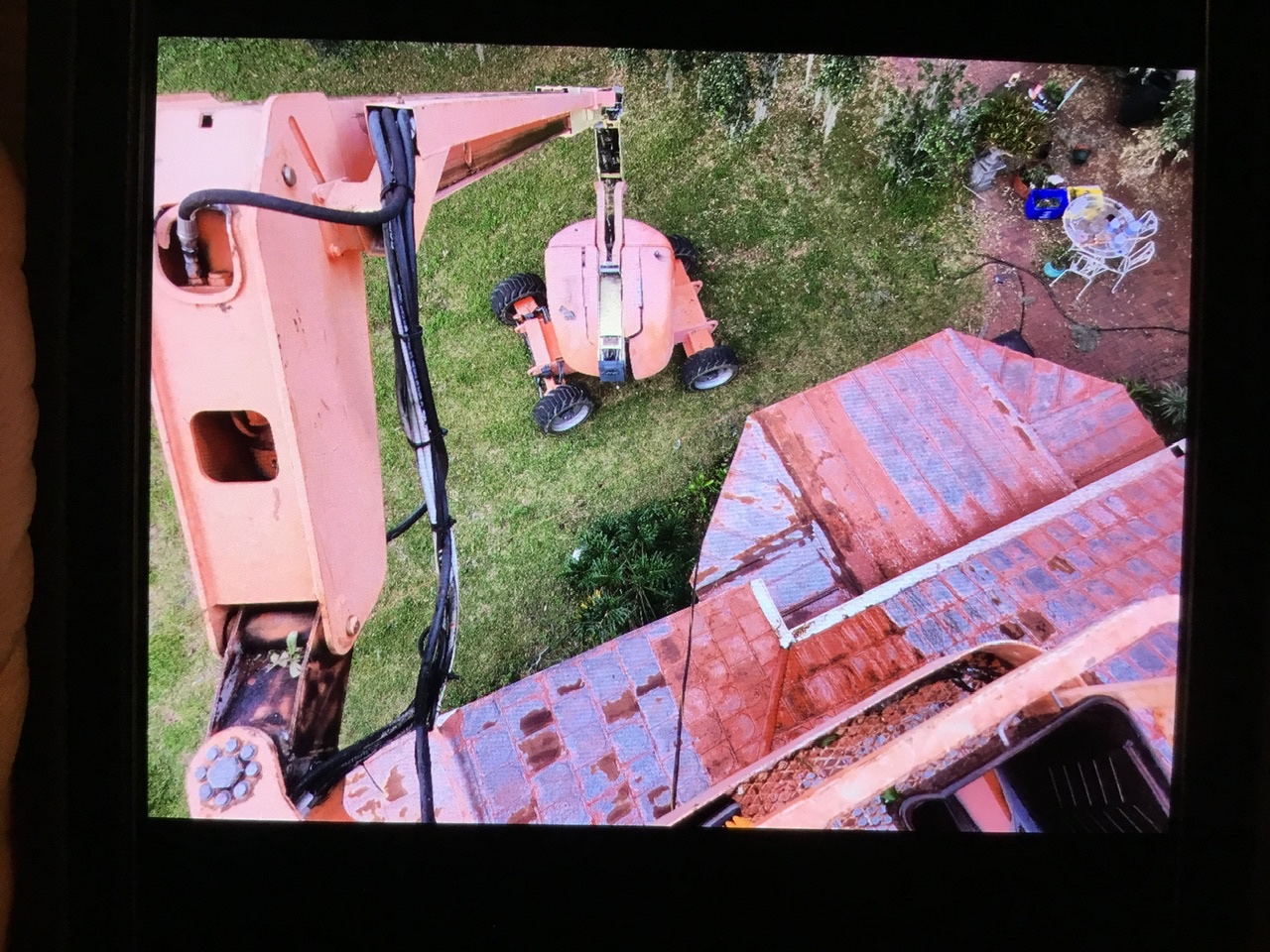

Not yet Robert. We are having some beautiful weather here right now and I am taking advantage of it to work on my house: repair the rotten woodwork, repair and treat the rusted areas of the roof with Ospho and coat the roof with a rubberized coating and paint my house. I am renting a 60’ high lift for $100.00 a day so I must get as much use out of it as I can while it is here. I will get to my T in several weeks, or early, 2025, when my house is done. Thank you. Jim Patrick
