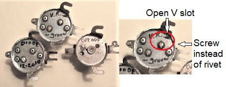

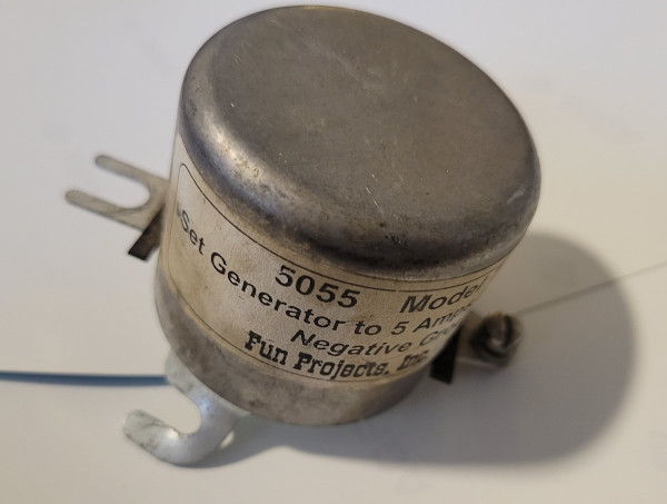

I recently acquired a used 5055 solid state cutout from Fun Projects - I'm assuming it's basically a diode with some sort of crowbar circuit to prevent a runaway condition. It seems to have a diode drop in the forward direction and a high resistance in the reverse direction. Does anyone have any recommendations on how to further test it to make sure it's OK to use?

Your test says its likely Okay "If you have continuity in both directions, the diode is likely shorted"
https://www.google.com/search?client=fi ... ing+a+diod

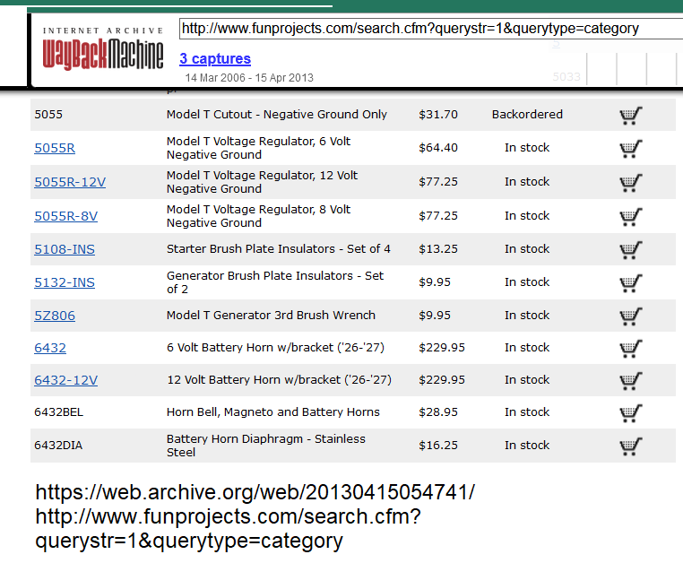

If I am not mistaken that is a Fun Projects Voltage Regulator. NOT a cutout.
Ask someone on this Forum to send you a copy of the Installation Instructions and follow them to the letter!

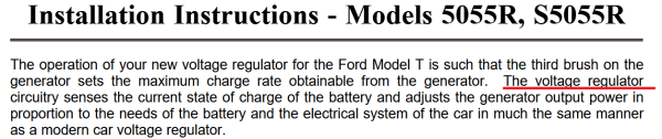

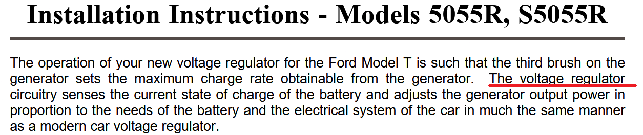

Ron is correct. 5055 is a Voltage Regulator.
Try it.... you cant hurt anything. Here are the original FP instructions:

The 5055 is the Cut-Out & the 5055R is the Voltage Regulator
Instructions for the 5055R --
Post a photo of the underside The Top is the Voltage Regulator, the bottom left is the FunProjects Cut-Out and the bottom right is one of the many versions of original cut-outs or reproductions
