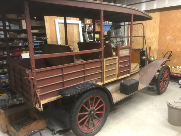

Front fenders would be normal t fender brackets. Rears May have to be made up to work with your hack body. Ford didn’t make a hack. When I put a Cantrell hack body on my ‘13 chassis I used hack fenders and made up the brackets.
