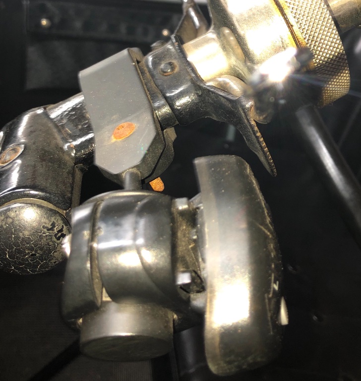

This is the same China version unit mounted on the steering wheel spider. The China version comes with this control for handle bar, but it fits neat on the steering wheel and simple access. Make your own rear bracket to mount. On the '24 made a mount to fit to the spare tire hanging off the center. The signal is centered on the T that way.

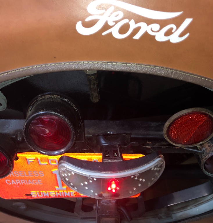

Eldo

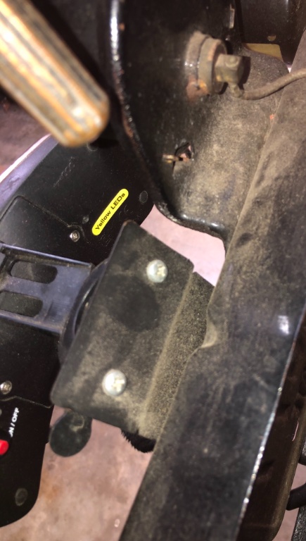

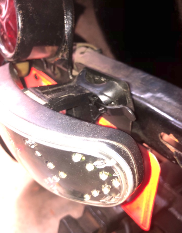

IMO wire mounts may wiggle and get loose, easier to use small bolts and nuts and add the mount to a bracket, fit the bracket where the Signal Lamp won't interfere with the body or fenders.
On this install of the China bicycle Signal Lamp, made a small bracket of sheet metal, bent it to present the lamp at level and marked and drilled holes to mount the sheet metal bracket to the tire carrier frame crossbar. Really not hard to make a sheet metal bracket for that plastic mount.
The plastic mount for the Signal Lamp has screws on the backside to use. That mount of course has the clip handle for instant off and on of the Signal Lamp, to change batteries, or to remove for safety to keep away slight of hand characters. :(
Back side of small sheet metal bracket fashioned and bolted to the crossmember of the spare carrier on the '24.
Control module on the steering wheel spider.

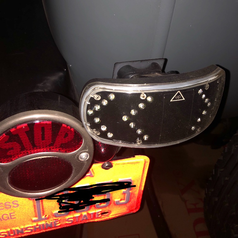

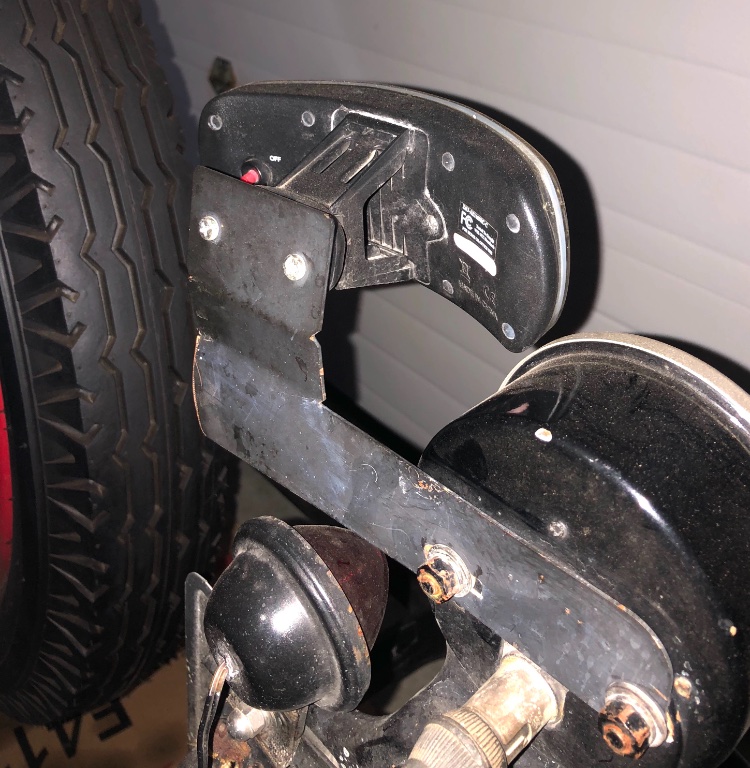

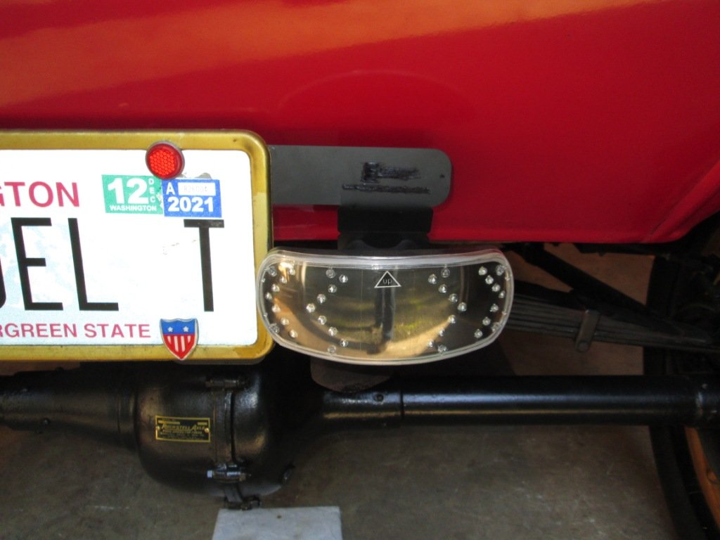

Here's how I mounted mine Eido - Egypt Garage has about every type of mount you might need without "major" modifications.

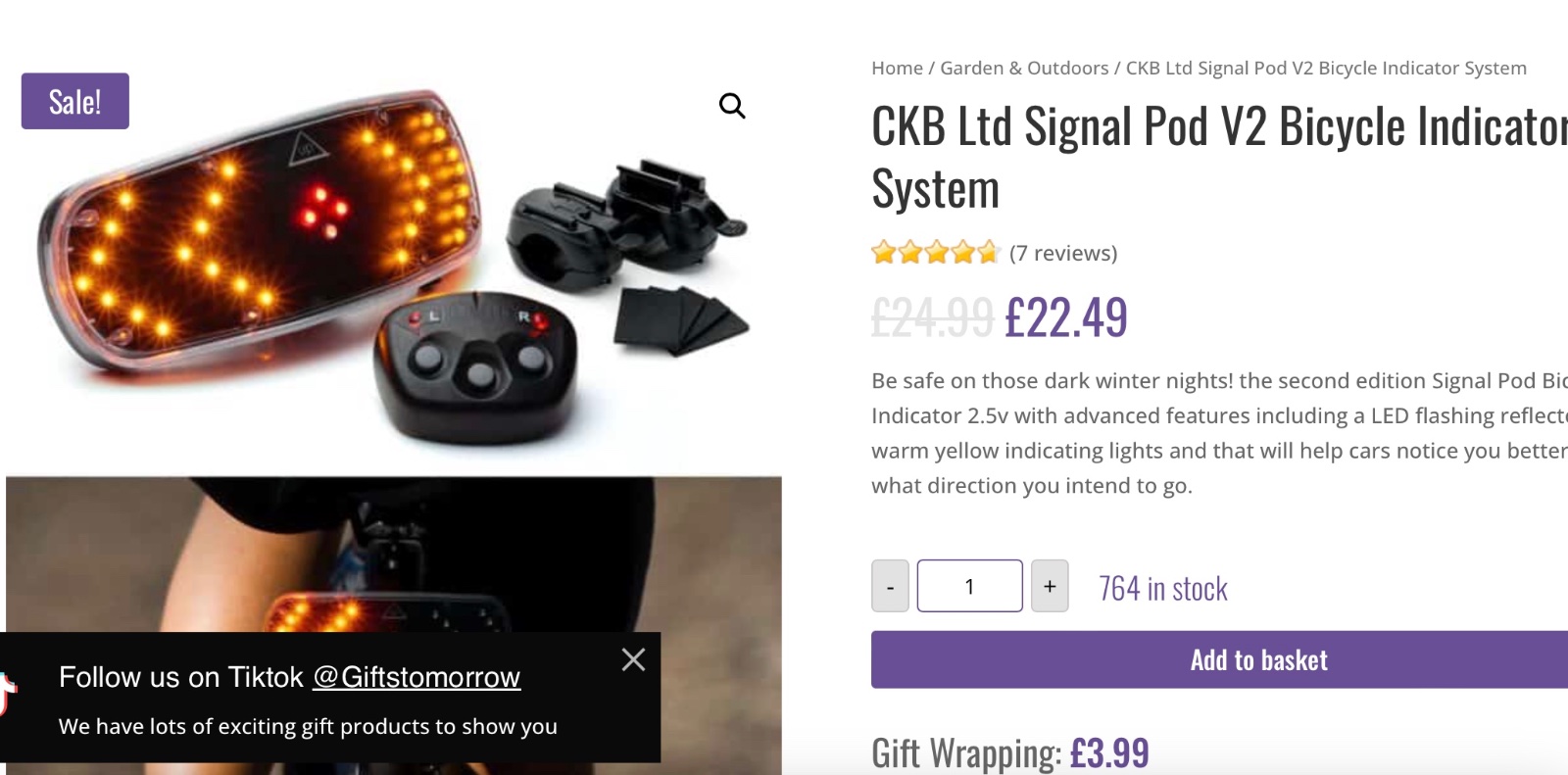

The brand I use in the posts and still works fine is the "Signal Pod", there are many other bicycle turn indicators, some are USB rechargeable, you find at bike shops or Walmart places, I prefer the battery type. The Signal Pod used to be avail in the US, but the last one I ordered came from the UK, they ship the unit for $10, as least the web site states. 23 Pounds Sterling is approx. US$29
China made, imported to UK by CKB. www.giftstomorrow.co.uk or www.ckbltd.com
