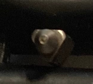

My ‘26 roadster with a straight thru Simmonds or NH carburetor failed to start. Diagnostics dictated fuel problem. With the sediment bulb shut off I’m underneath draining the bowl. With that over I removed the bowl and float. Latter didn’t make any noise when shaken but the triangular shaped needle didn’t fall out so I removed it. And it’s rubber tipped so I researched ‘viton’ on past Forums. Then emailed Scott C needing one of his Full Flow Valve sets. But I went to my coffee can of carburetor parts and found this steel needle with a rather blunt or rounded tip. There doesn’t appear to be any circumferential rings around the needle ?…. What’s the groups opinion ??
Use it ? Thanks
Use it ? Thanks

It looks like brass. Most metal ones are aluminum. If you dont have the matching seat its probably going to leak. Its not worth bending up your float tang to get the right fuel level. I would buy a new needle and seat and be done.

You can try the one you have. If it results in fuel starvation you can get a better one from Scott C.

John, are you saying an NH needle and seat is like crank and cam gears / ring and pinions ? They have to be a mated set ? Steve, I very quickly contacted Scott C trying to buy a Full Flow set but he cordially said more won’t be made until March 2025. Terry, thats a good sequence of events and I heartily concur but it’d be cumbersome at a typical 4 stop tour. …anybody have one of Scott’s Full Flow Valves they’d sell ?

George..... Find yourself a original intake valve, put the triangle shaped valve in a hand drill, and with some crocus cloth apply that to the tip as you spin the valve, .....with the screw in section soak that in carburetor cleaner and use a q-tip with the crocus cloth to dress up the mating surface so the valve will close properly without leakage...... To be sure of your work, set up carburetor on your bench with an elevated fuel supply and check for leakage after an hour or so.

George, yes they should be a matched set. Different angles may not seal together. For $20.00 new why not.

Sticking to the original question if there is no ring on the tip & the needle centers well in the seat, try taking the seat out setting on a smooth
flat surface put the needle in the seat with a brass or other soft punch give it a firm tap this should form a good ring in the seat for it to seal
on. I test float valves by pulling a vacuum on them with my mouth & sticking my tongue on the end if it sticks to my tongue for a few seconds
it's good. At least till you get a Scott C. valve from John T.

Thanks Craig, I shall follow that excellent advice. It’s always been easier for me to remove the intake manifold with the carb attached than the carb by itself. I use the 2 half manifold clamp method. And the original aluminum manifold is already in the vise sandwiched between boards with the carb bottom up. I read about Stan Howes tapping the needle into the seat with a ‘big fella hammer’ and that sounds like your suggestion. And I also test by pulling a vacuum like you suggested and our friend Hugo Richter illustrated in the Carburetor Manual….. Merry Christmas

Tapping on a steel tip needle & seat unit is covered in the service manual.
A lite tap is in order, not a big hammer blow.
