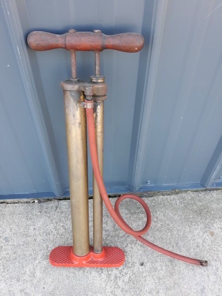

Post by DanTreace » Fri Dec 06, 2024 5:33 pm
These pics may help, you may can extrapolate the length hose. Normally they are fairly short, so standing by the tire is necessary.

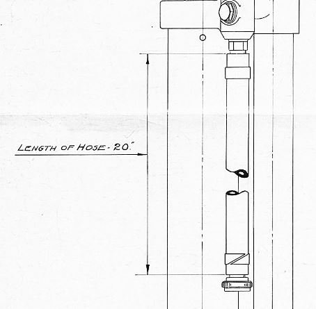

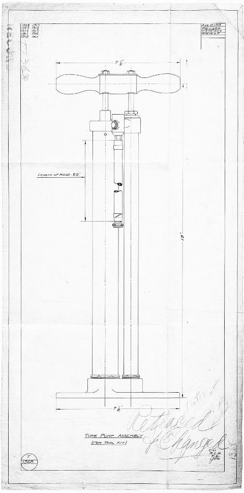

Post by namdc3 » Mon Dec 09, 2024 12:54 pm
20 inches. See image for details.
