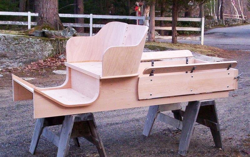

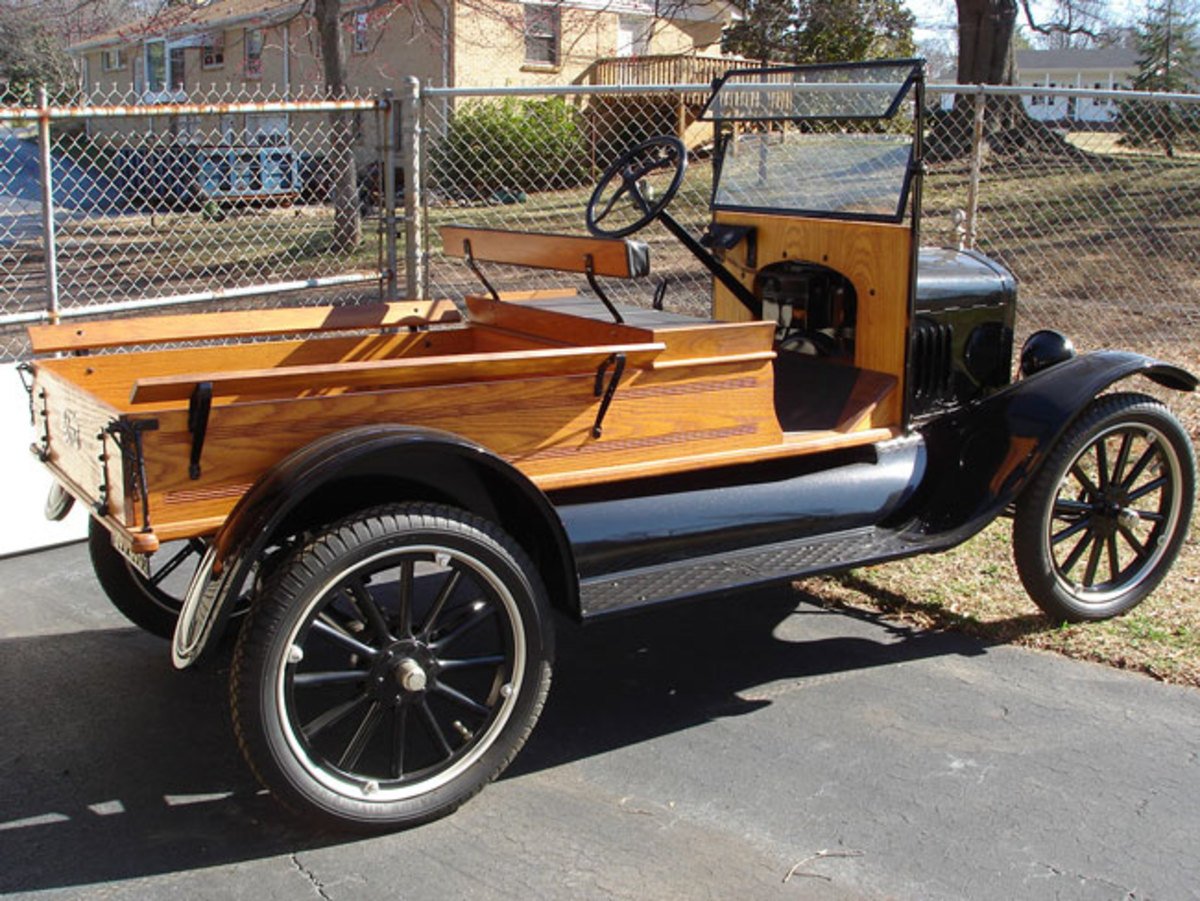

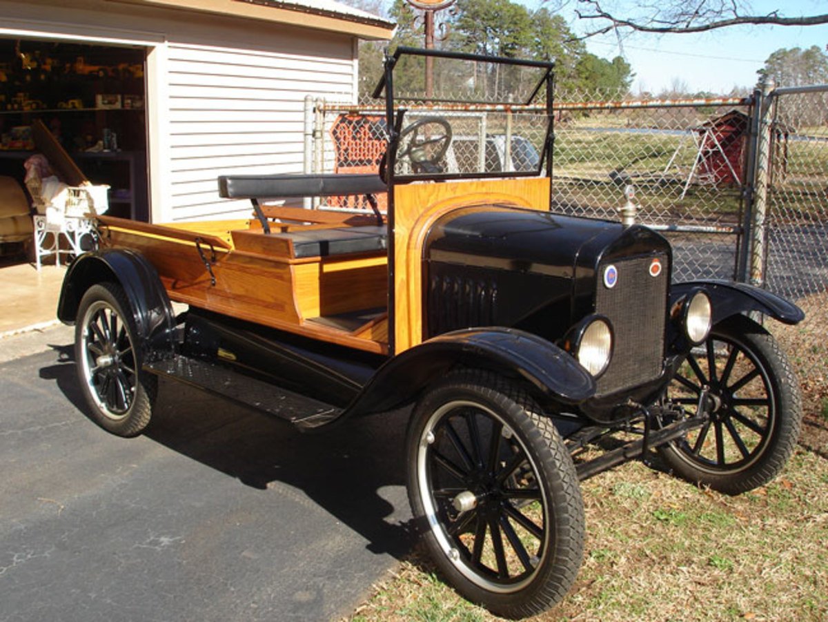

Ford sold the Model T as just a bare chassis. In the day, many folks either built their own pickup body or purchased a ready made body.
Today you can still do either. A pichup express body would not be that difficult to build yourself. Although they can also be purchased.
One of the vendors sells a truck body similar to an early mother in law roadster. One could put a roadster top on this body and have some weather protection.
No one could say a truck body on a Model T chassis isnt authentic, as it was done all the time.
