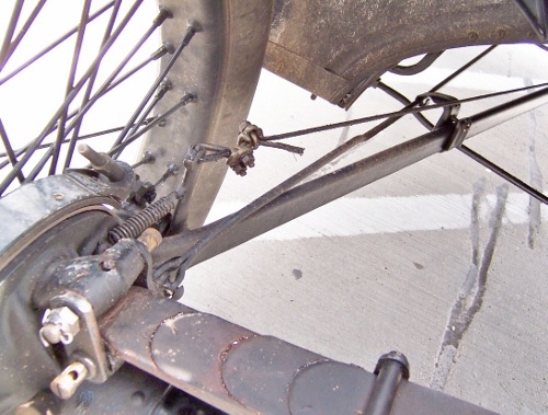

The A-C type are made for existing small drum, so perhaps they will fit his wire rear wheels. This photo shows A-C type on a typical laced wire wheel.
- Posts: 7279
Re: hayes wire wheels and brakes
Dan's photo shows a laced wire wheel with spokes laced directly into the wheel rim. Hayes wire wheels have demountable rims, with the spokes laced directly into the outer felloe at one end and directly into the brake drum at the other end. This places them much closer to the brake shoes. If there is any run-out in the drum, you do need to make sure the shoes cannot ride outwards onto the spokes. It is not hard to do.
