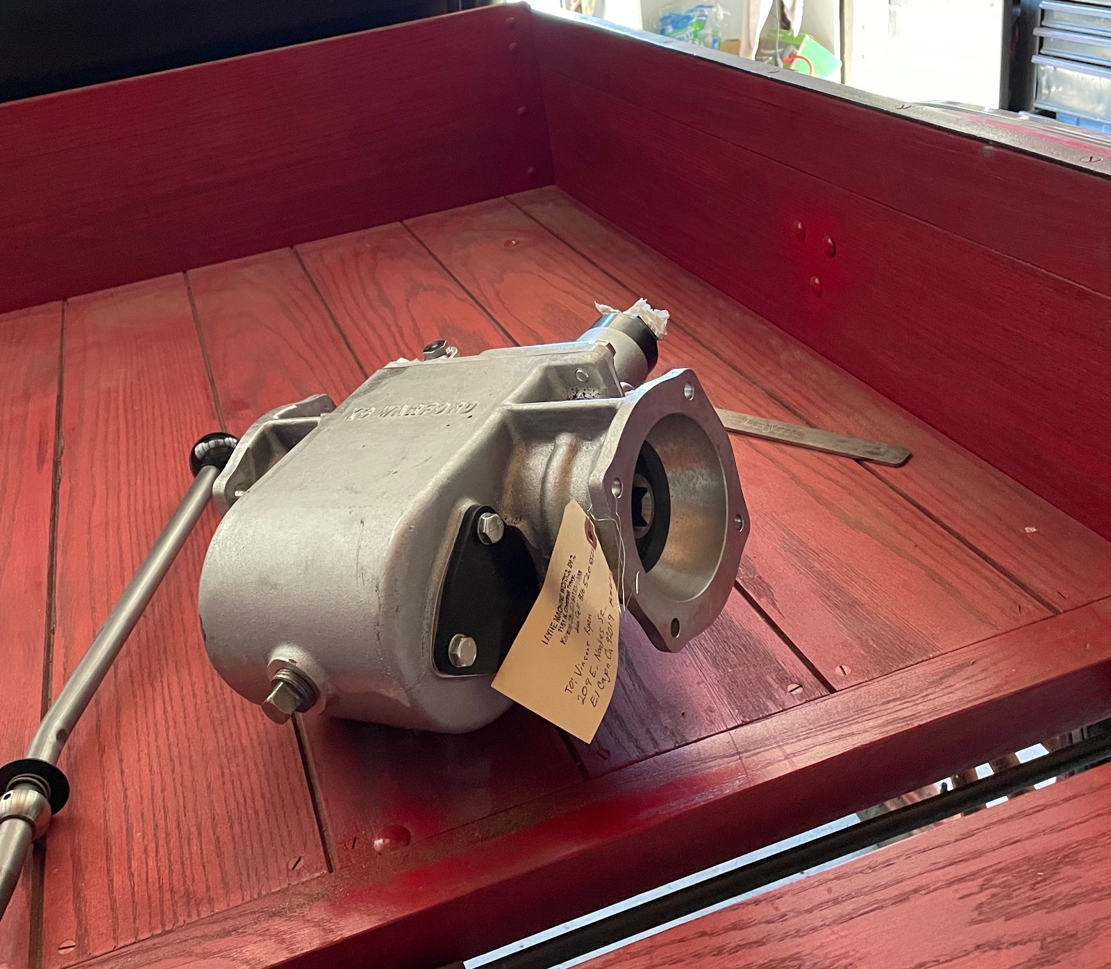

I’m on the list for a Layne Warford Transmission but haven’t heard back on it. Has anyone out there received theirs yet?

My gearbox is done, should be here in a week or so. Now to study up on axle/differential removal and repair as to coincide with the installation of the Warford.

Got mine today!
