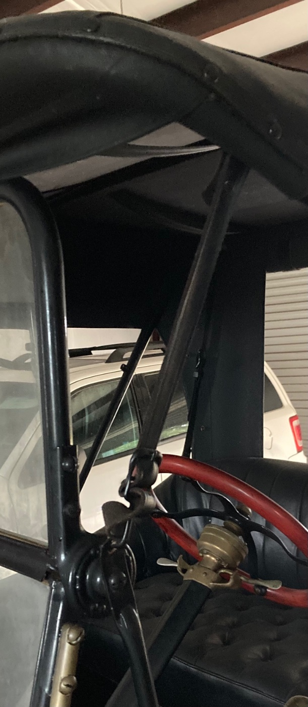

This is my first model T. I'm recovering my seats in leather and building a new top. I have a couple of questions on the top and can't seem to find the answers. 1. Should this top have straps front to rear as on the touring top? 2. I purchased my top material from Mike at Classtique, I bought the pre made to pads from them but they are 9" wide, the pads I removed are 6" wide, which one is correct? I believe the wide ones will wrinkle on the center bow. I also need a front bow, mine is warped. I can't find any to fit the 15. Langs has a set but lists the years from 17-22. My first post on here.
Thanks in advance for any help!

Lawrence,….I’ve always known/learned/thought my ‘14 runabout top is exactly like a ‘15 runabout top. That said, I believe you’ll need 2 sets of leather straps - 1 set in front and the other in back as per these pictures. Get them from Russ Furstnow…. And the 9” pads are correct.

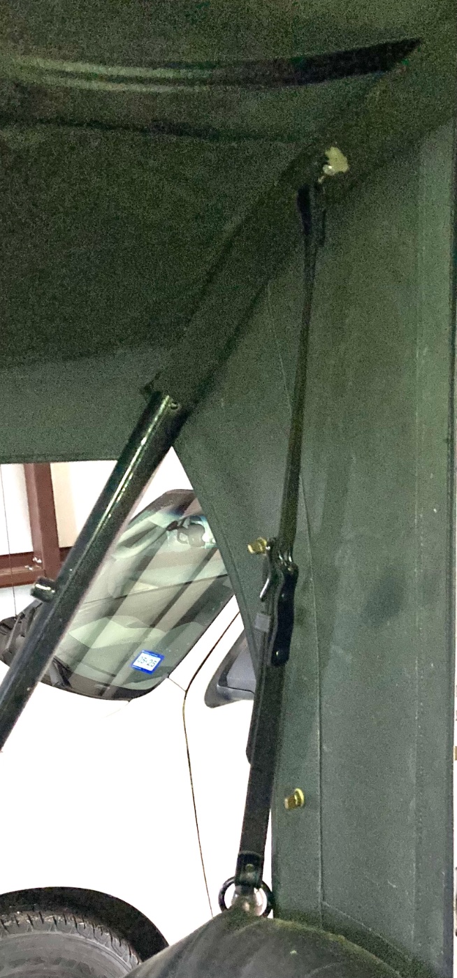

I know about those straps but I can clearly see the straps up under the top in your pics! They are inboard from the pads. So your pics helped! I'll know more when I finish the frame and I can set the pads on and look at them, my originals are actually curved, May be from time?George House wrote: ↑Sat Dec 14, 2024 10:38 amLawrence,….I’ve always known/learned/thought my ‘14 runabout top is exactly like a ‘15 runabout top. That said, I believe you’ll need 2 sets of leather straps - 1 set in front and the other in back as per these pictures. Get them from Russ Furstnow…. And the 9” pads are correct.

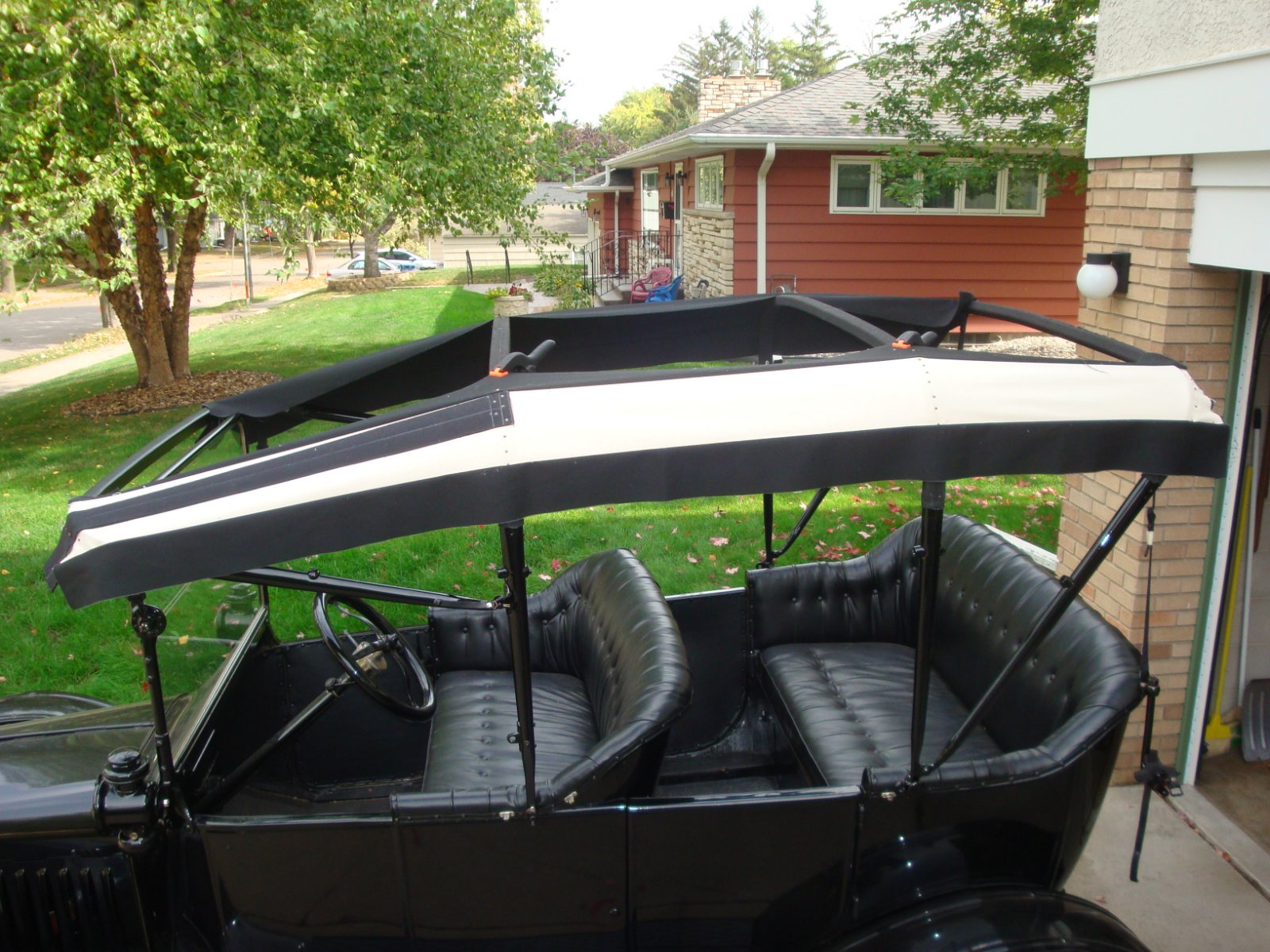

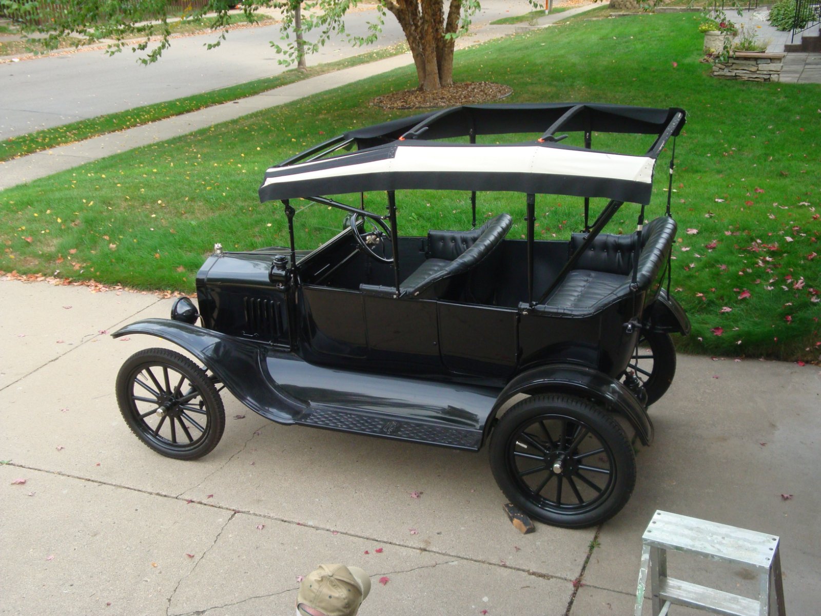

If you are purist and want to do it right, this is how the pads were constructed at the factory:
- Lightweight white canvas sewn inside, along the folds of the black cotton covering. The pads are stuffed with cotton batting.
- There SHOULD NOT be two straps that run from the first bow to the last bow
- There SHOULD NOT be jute furniture webbing inside the pad
- For reinforcement, two pieces of top material sewn down the center and fastened finished side down to the first and second bow
- The first bow is attached to the windshield via adjustable cotton webbing straps with buckles - if you don't have a pair, you can purchase them from Lang's. Cotton webbing, not leather, is correct for 1915 through 1922.
- There are two adjustable cotton webbing straps with buckles (aka rear curtain straps) attached to the rear bow and the top saddle brackets - if you don't have a pair, you can purchase them from Lang's. Cotton webbing, not leather, is correct for 1914 through 1921. (In 1922, a revised top saddle bracket was utilized which are not compatiable with the cotton straps and metal D rings.)
Below is how the pads should look before adding the cotton batting and sewing them closed. This is my father's 1917 Ford touring which he has owned since 1949. My father installed a new top on the car in 1951 using the orignal, factory top for patterns. These photos were when we were installing another top a couple years ago. This was all done by scratch - not a kit.

I measured the original, factory issued pads from my unrestored 1917 roadster and the width is seven inches.
1915, 16 and 17 all used the same oval top sockets and curved bows. The only difference between the construction of the top is 1915-16 had a tombstone light (window) in the rear curtain wheras 1917 had three rectangular lights in the rear curtain (although photos and surviving original examples of early 1917s did have a tombstone light so there was some carryover early in the 1917 model year).
1918-22 tops have square top sockets with curved ends that receive straight wooden bows.
