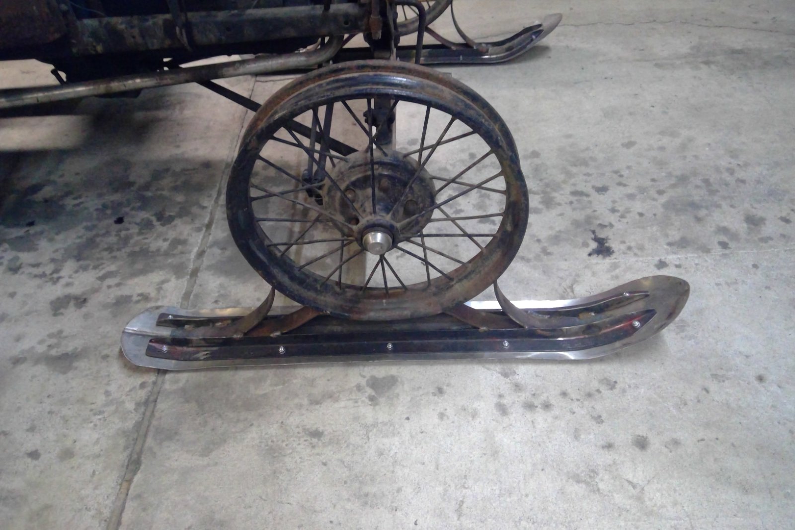

Here are the skegs on an ARPS Supersnowbird ski.
Dennis Prince
Posts: 405
Last Name: Prince
Location: Madras Oregon
Re: Snowmobile ski question
Post by Dennis Prince » Tue Dec 17, 2024 6:24 pm
Thank you Joe for the picture that answers that question. Dennis

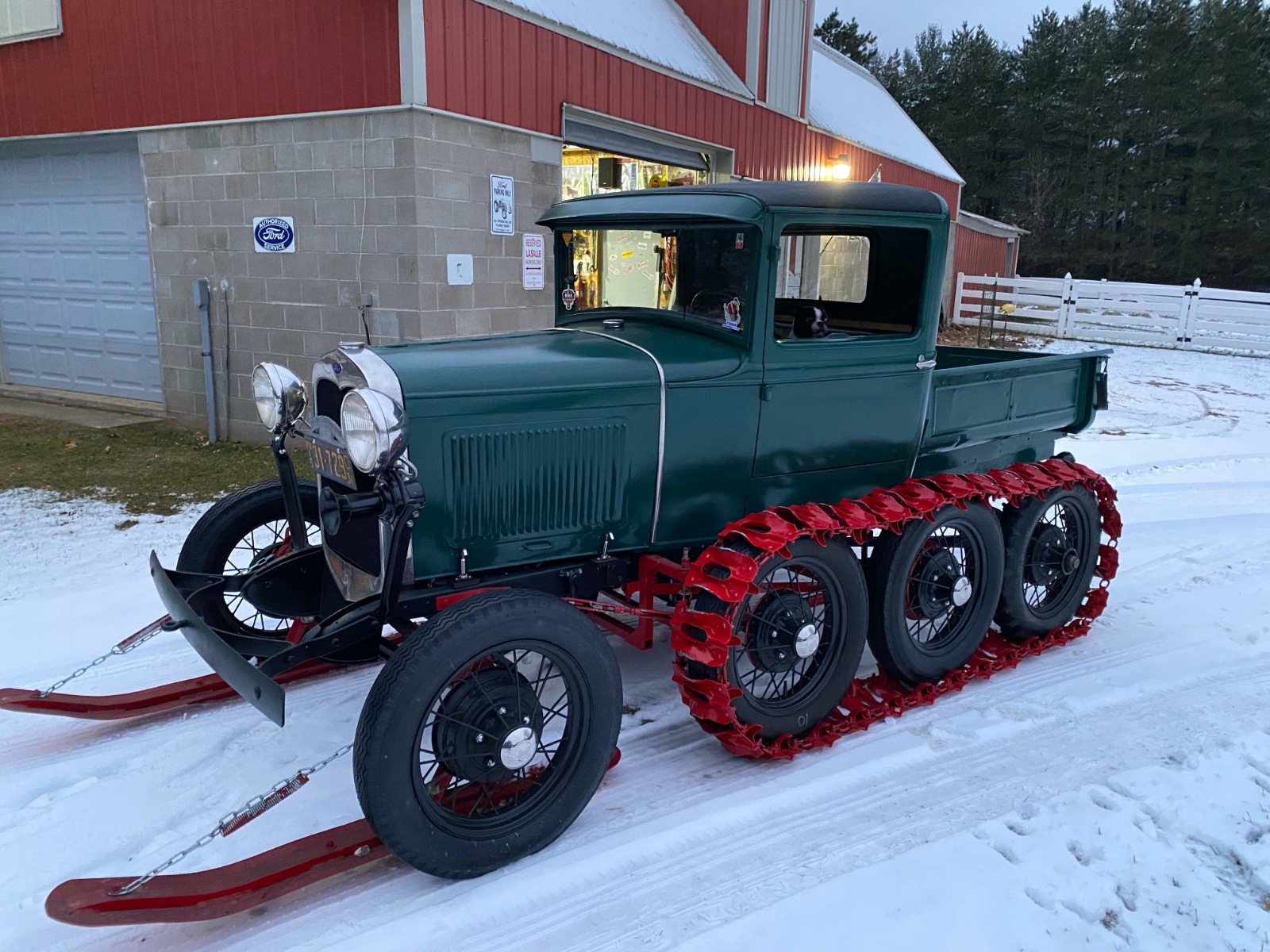

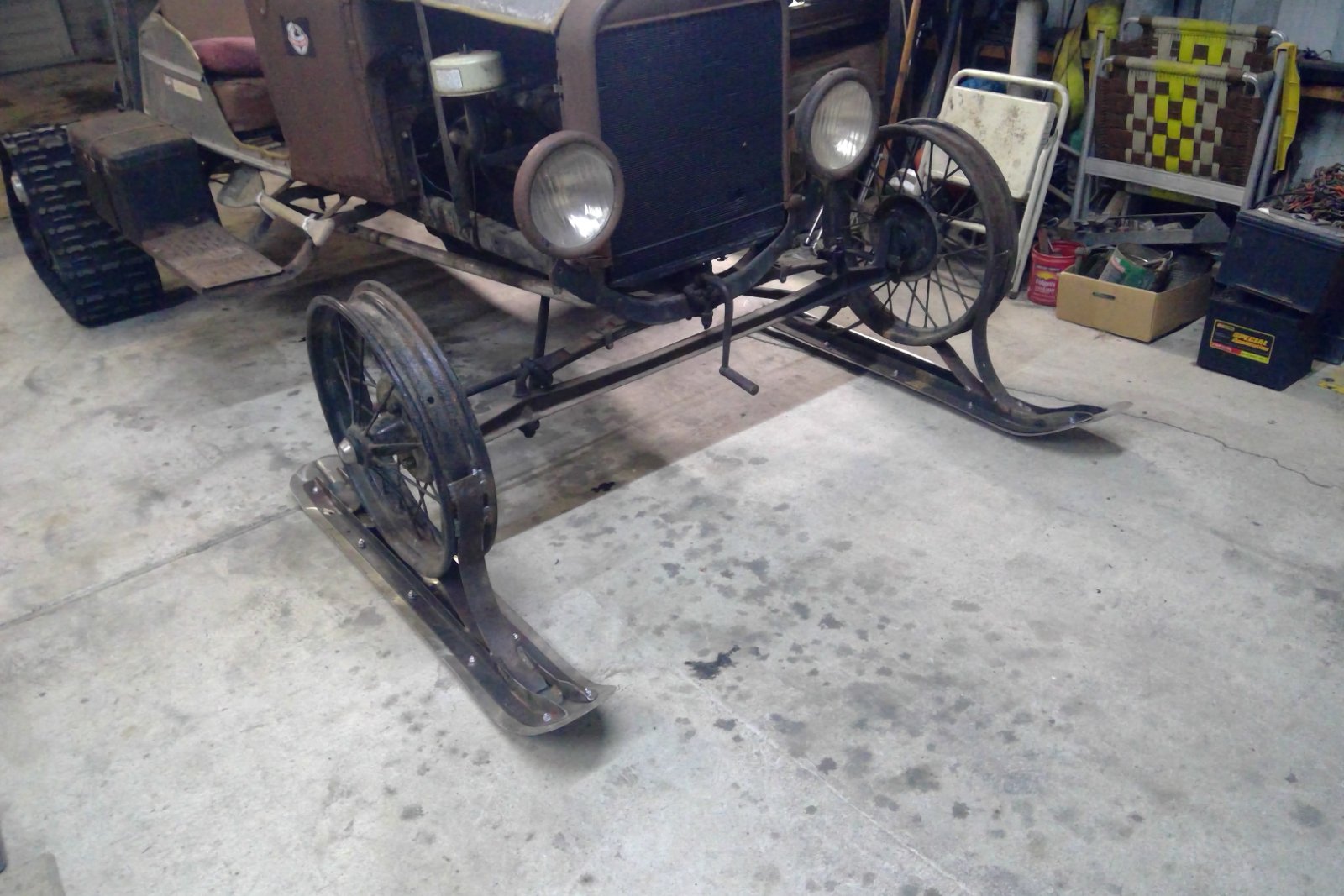

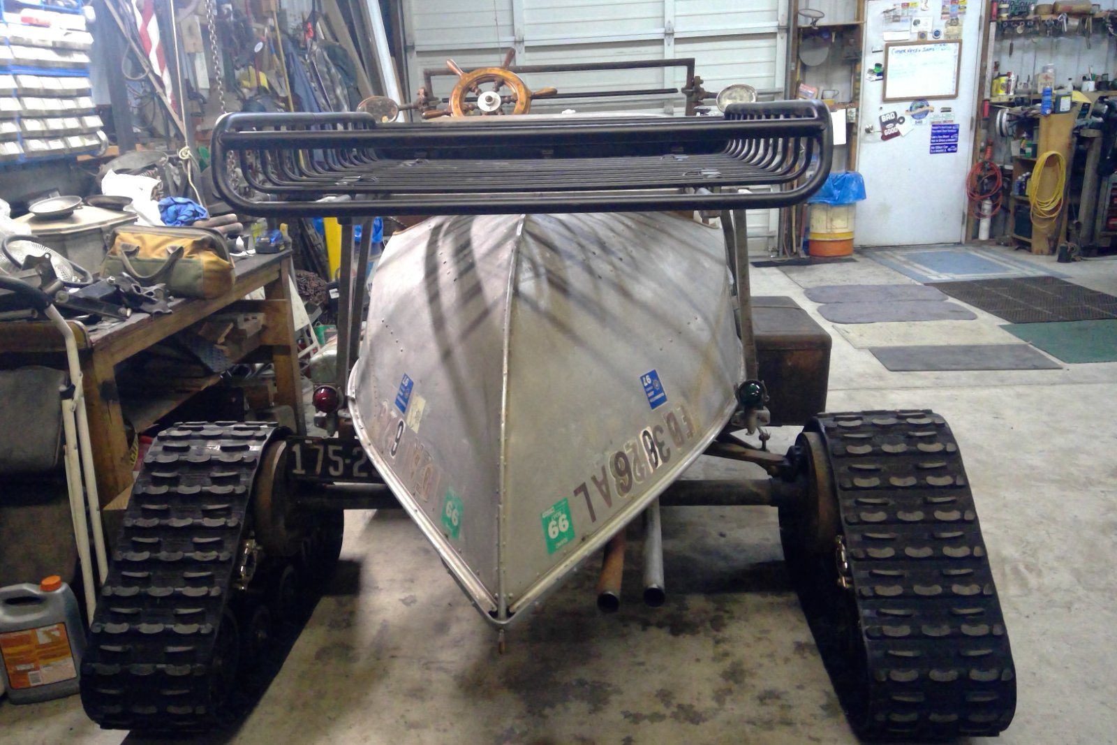

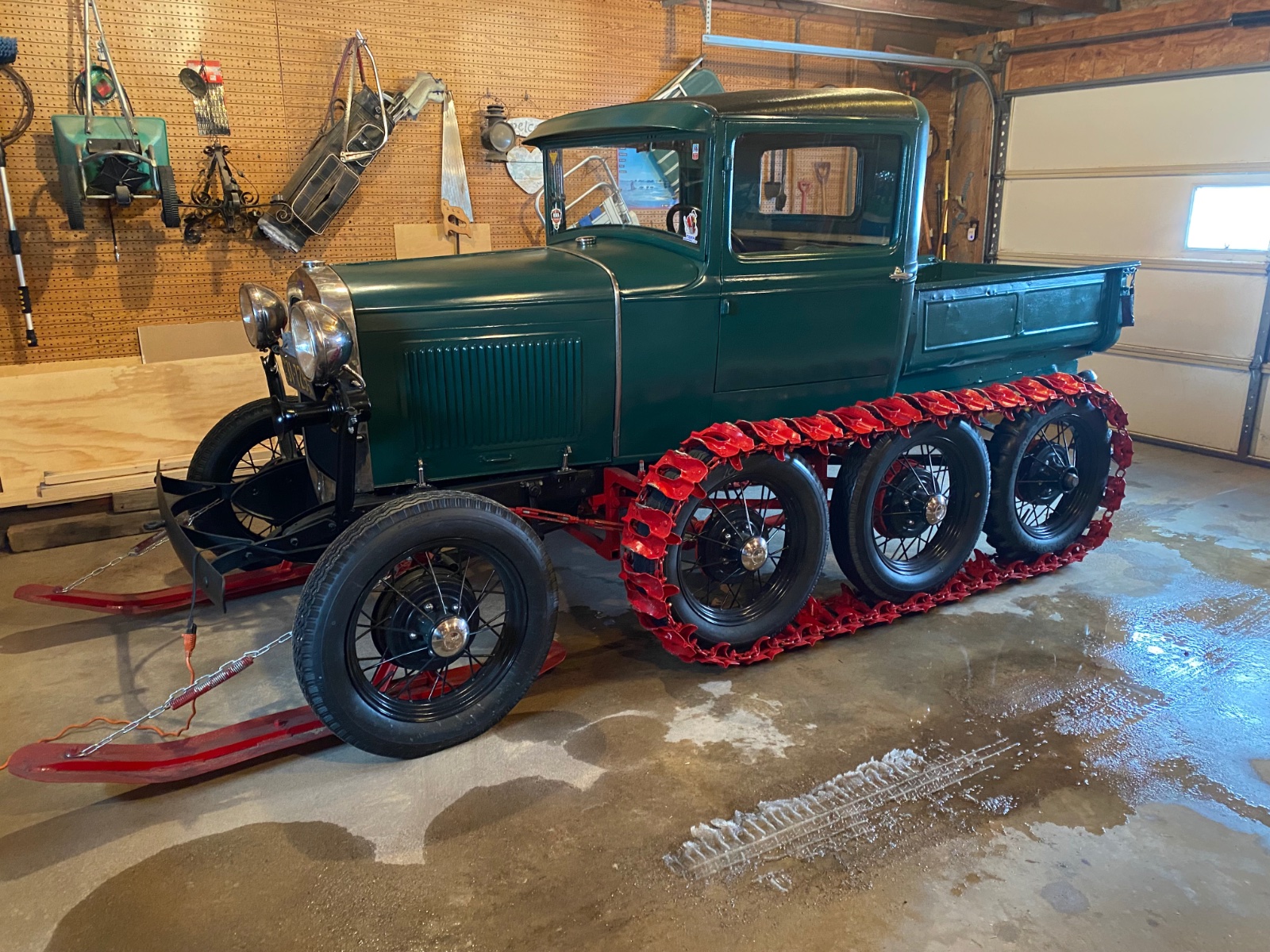

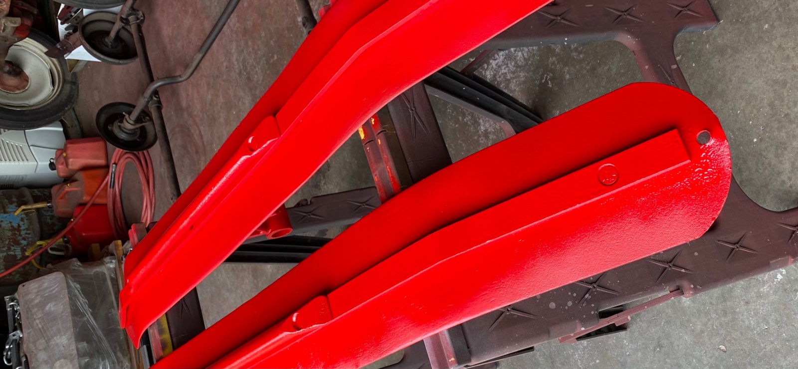

I finally got my skis finished. They are made out of things out of my raw materials pile (formerly known as a scrap pile) I used wheels that were no good for tires, some broken Model A springs, old bed frames, chain links off a potato digger and what was part of the kitchen remodel at the Elk's Lodge 25 years ago. The skeg on the under side I made 14 inches long and now all I need is snow to test them out. As you can see from the pictures it is not a traditional T snowmobile, my nephew had these tracks for his side by side and doesn't like them so a friend and I put 2 tracks a piece on our T's. We will see how well they work. The only time in my life that I have ever wanted it to snow.

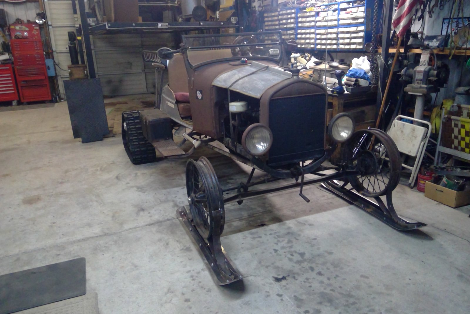

Dennis that turned out really nice. Take some shots out in the snow. Model T’s are light but I wonder about boyancy on top of the snow. This is the 30’s version by ARPS.

Dennis, I'm preparing to make a wood rim for my steeringwheel. I never considered making one like yours. I like it, but I think that I'll stay with the factory shape. :D
Posts: 5475
Post by RajoRacer » Fri Dec 27, 2024 10:17 am
Rather peculiar use for a rare 1925 steel p/u box.

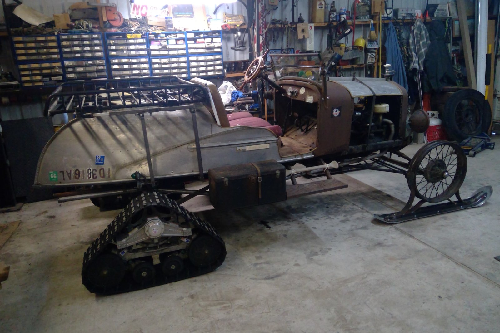

or there is this pair with the spindles on Facebook;
https://www.facebook.com/groups/2503824 ... 7365101454

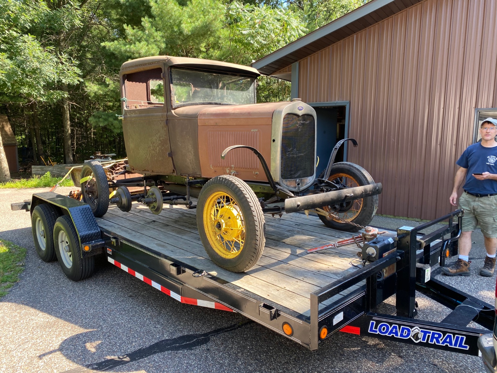

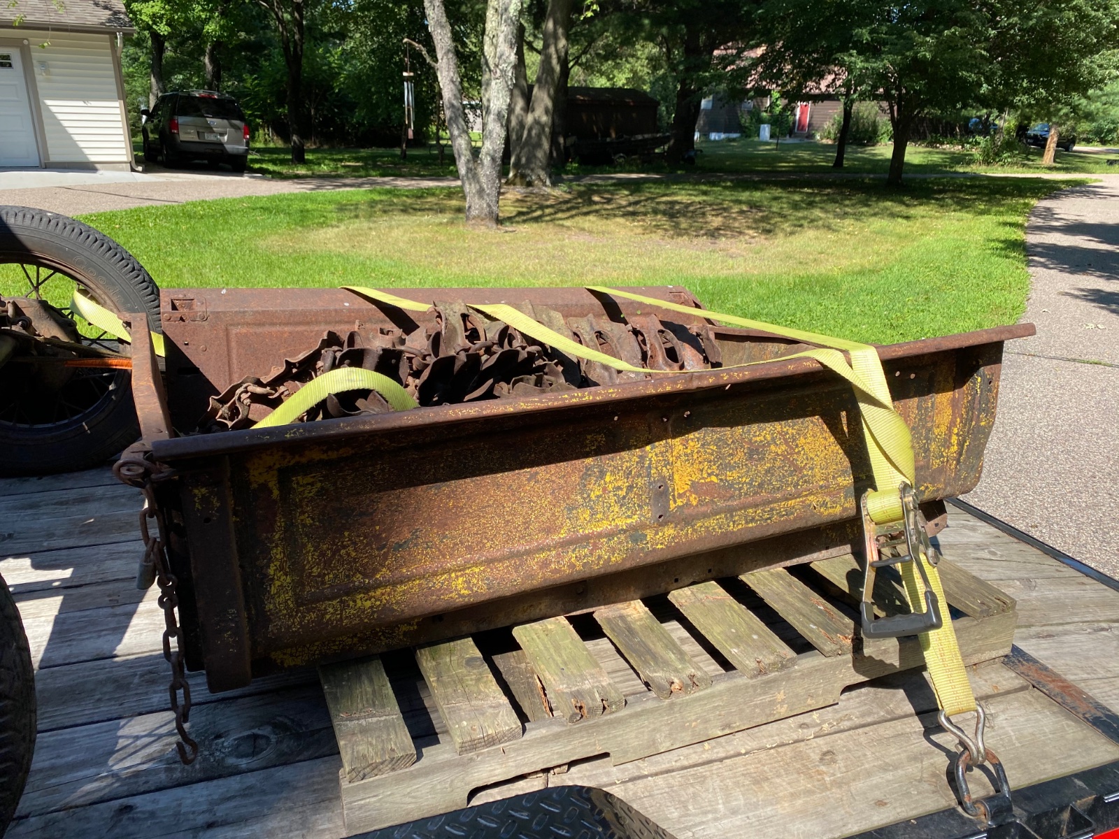

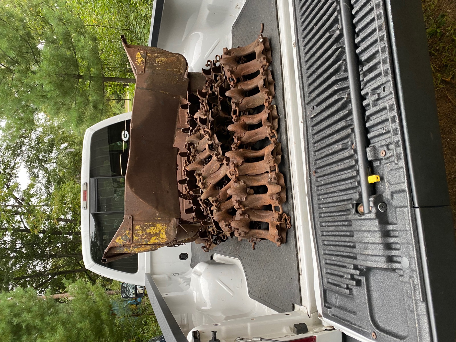

This is how my Supersnowbird started out. The cab metal is pitted more on the inside than outside. The Model A frame was cut, bent and welded to make it straight for some reason and it came with the 25 T pickup box. The frame cross members are now oak and fiberglassed. That is the reason it has the 25T box.

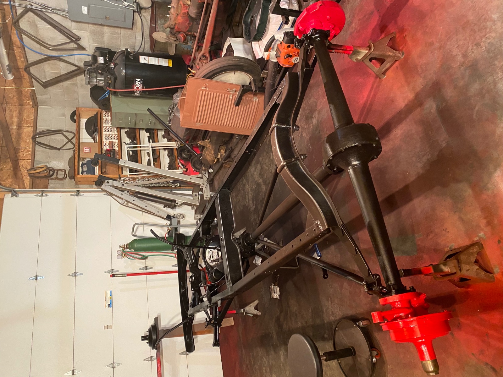

Supersnowbird frame. It is bent parallel behind where the cab sits. ?????? You work with what you got.

The box required a lot of hammering and reshaping.

Joe, You did a really nice job on your Supersnowbird. With it having no rear fenders I thing that the 25 bed looks better than a Model A bed would, looks like a fun vehicle. Do you have to get in and out of the window with that track setup? I am just waiting for snow, all of my snow is coming pre melted.

Post by Joe Reid » Sun Dec 29, 2024 12:56 pm
The doors are cut and remanufactured to open over the tracks. Still not too easy to get in.
