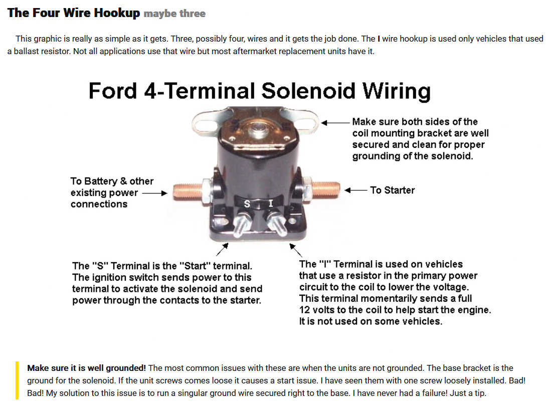

My question pertains to the type of solenoid that has both an "S" terminal and an "I" terminal. I think that if the switch was on mag, it would send battery juice to the magneto with the solenoid closed, so it's a no-no for a car with a Ford magneto. It would be fine with a distributor system that used an ignition resistor.
Just don't connect anything to the I terminal. It's purpose is to send the full 12 volts to the coil when the starter button is pressed. As soon as you stop using whatever switch you use for operating the starter motor, current stops flowing to the I terminal. If your T is six volts, or you are using the magneto, you don't need it. If it's 12 volts and uses a distributor, you probably do.
Posts: 6540
Re: Starter switch off the floor
Post by TRDxB2 » Sun Dec 22, 2024 4:44 pm

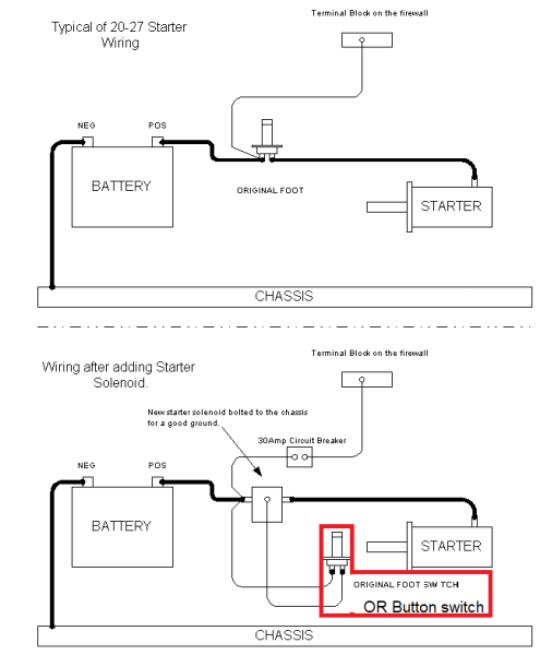

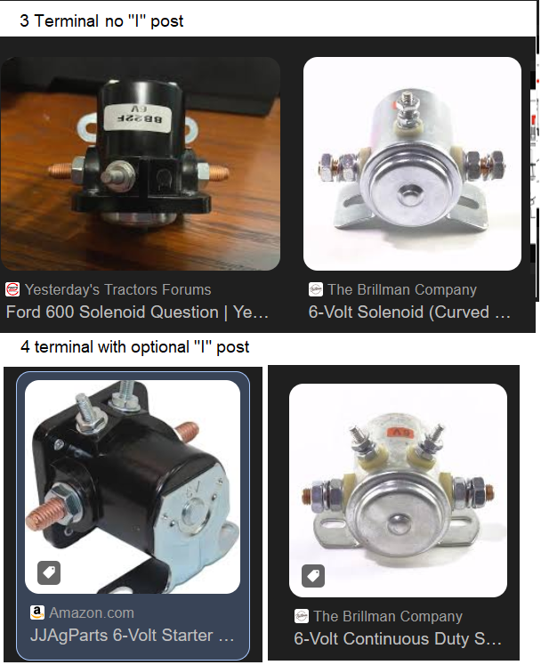

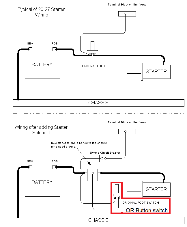

As indicated above the "I" post is for a distributor with a ballast resistor
3 terminal vs 4 terminal come in 6v & 12v
The wiring diagram with a push button does not really change anything to the electrical system
