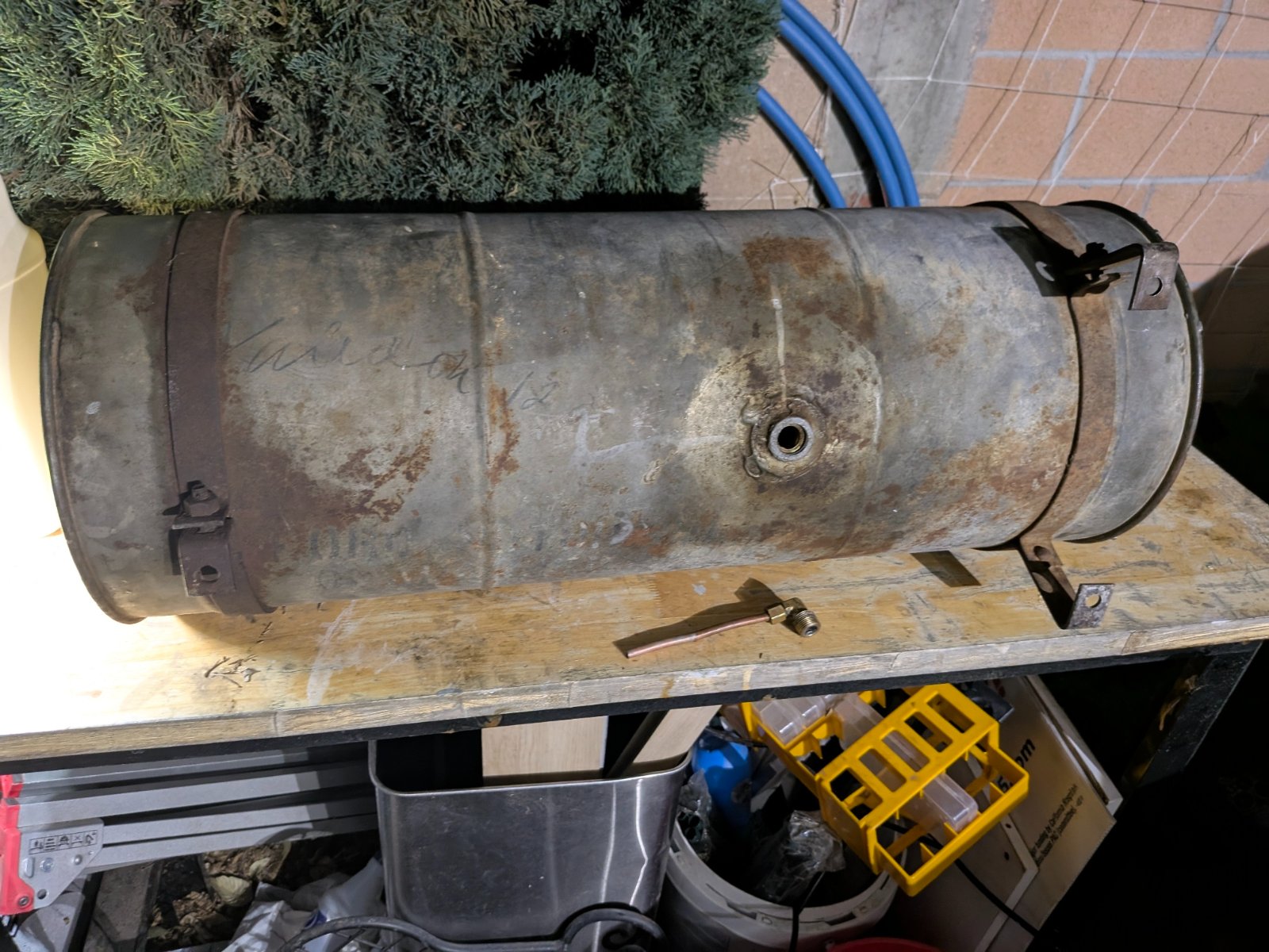

Hello all,

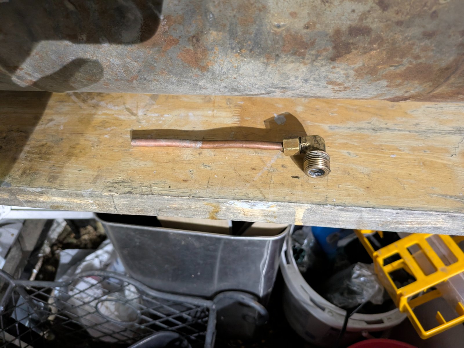

The carb restoration took me to pay attention to the gas tank and after cleaning and sealing it, I have found that the sediment bulb wont fit. The PO has installed a brass bushing in the outlet and had screwed in a brass elbow leading to a copper line to a flex hose to carb. There was no sediment bulb.
I'd like to restore it to original and would like to remove this brass bushing so that the sediment bulb can fit. any ideas how to remove this bushing without causing damage to the tank?
Also, the tank is round and not oval. Will this cause issues once the sediment bulb is fitted on? not much clearance between the bottom of the tank and the drive shaft down there....
Any help would be most appreciated.

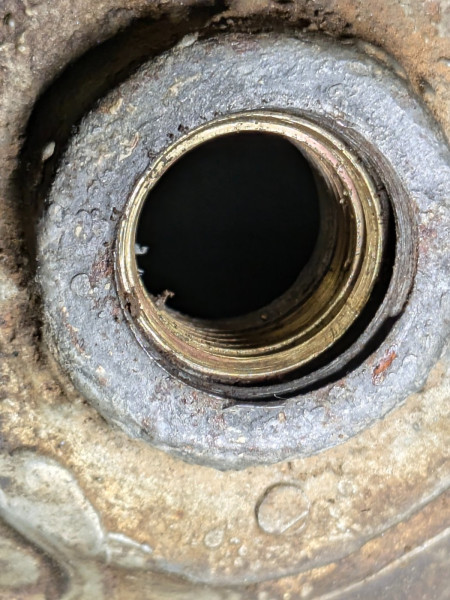

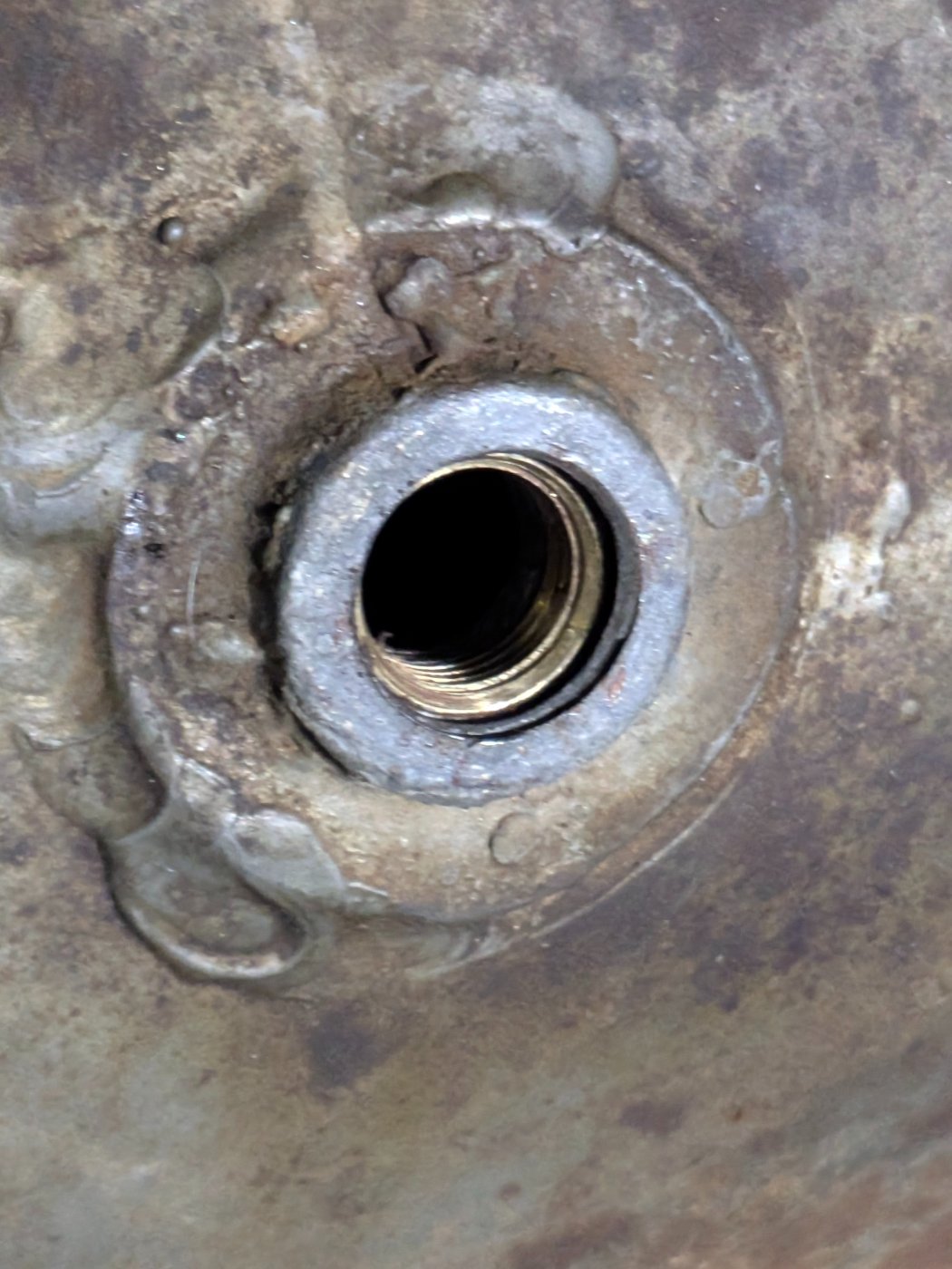

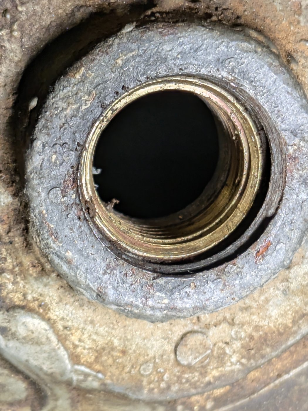

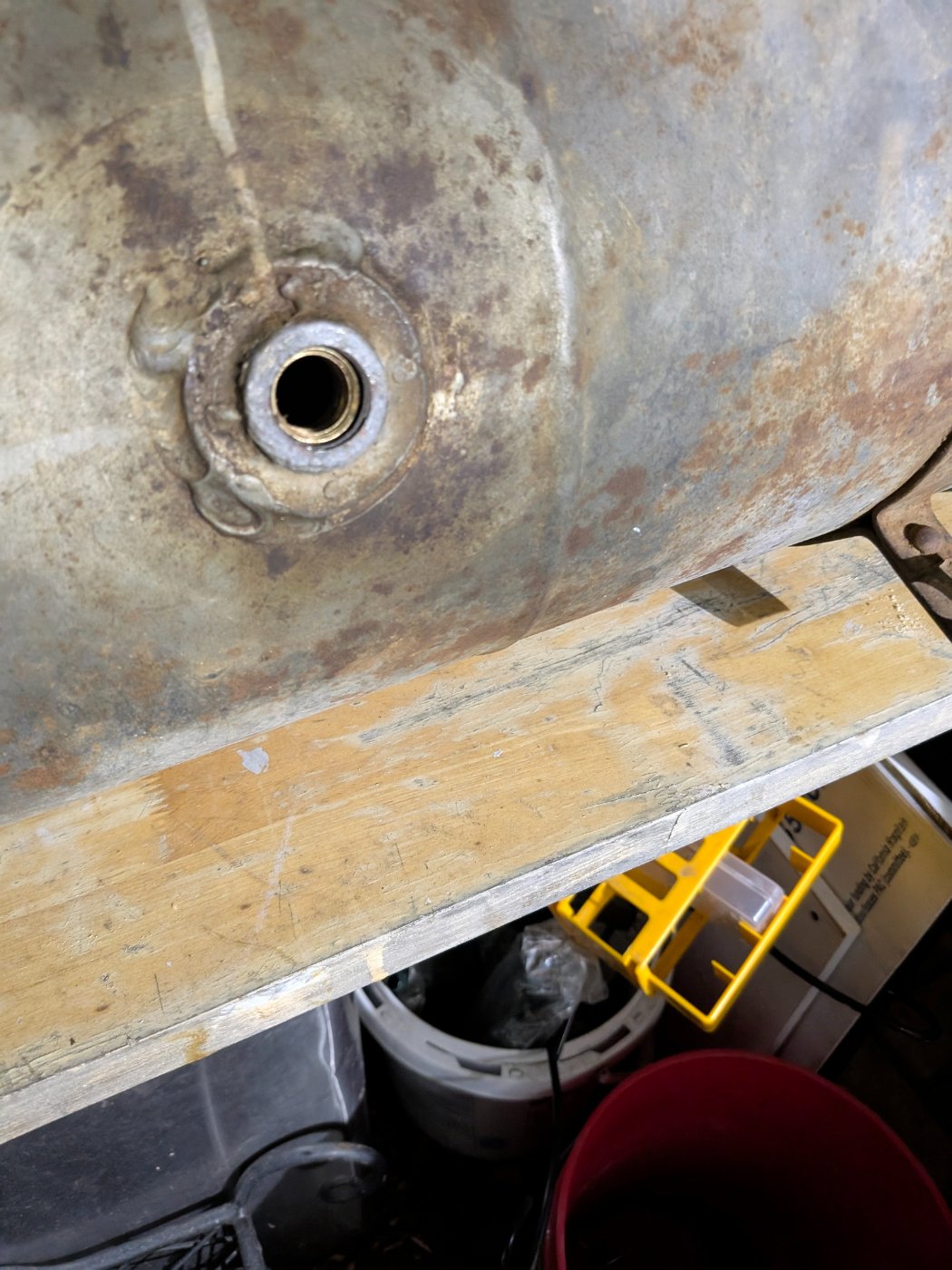

The car is a 1925 model T truck and not a TT. It seems like the bushing is threaded and no hex shoulder. The gas tank is round and fits under the seat in the current cab. Here are the pictures...
As always, really appreciate all the help.

I have used internal pipe wrenches with good results. If it's stubborn carefully slit the bushing first

There is a broken PVC sprinkler pipe extractor tool that looks like a taper reamer.Pat Branigan Wisc wrote: ↑Fri Dec 20, 2024 7:43 amI have used internal pipe wrenches with good results. If it's stubborn carefully slit the bushing first
Comes with 2 sizes of extractor ends. It will bite into your bushing.

Pat has the solution, internal pipe wrench. Jim

Here's a bunch of options... https://www.mcmaster.com/products/pipe-extractors/
This one is cheap & easy... https://www.mcmaster.com/products/pipe- ... d-parts-6/
I'll sometimes file four small corners for the edges of the tool to more easily grab.
