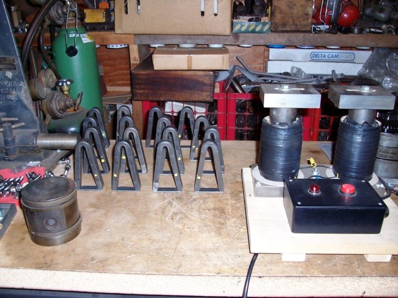

I agree with David - I attempt to charge to the same orientation.
