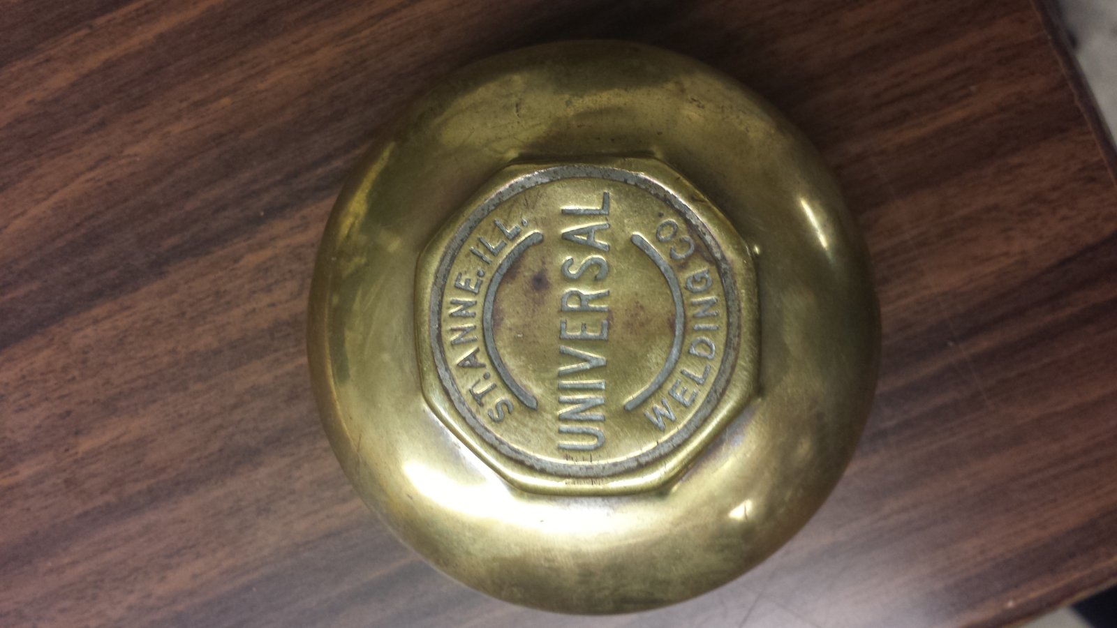

a fellow chapter member of mine has a set of universal welding co. wire wheels on his 1915 touring. one of the hubcaps is stripped.
i an going to try to repair it. its thin brass with really fine threads. does anyone have a process that they use to repair these. also
see the picture does anyone have one to sell? thanks philip

Good luck with your search... not many of these wheels out there, and I’m sure even fewer extra hub caps. The new Mclaren brand wheels are a reproduction of the Universal brand wheels. You should look up Mike Lebsack, as the Mclaren caps may directly interchange with the Universal. Could most likely recreate the logo and make whatever you need

show the inside, with a focus on the threads, please.

Yes I have considered brazing also I have a metal spray torch the backing is a good idea. One thought I had was to thread a new brass ring leave it a little thick then cut the threaded portion off of the hubcap and silver brake the new ring on and then
Finish the outside. Philip

This hubcap is 3 inch od
