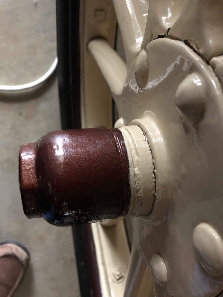

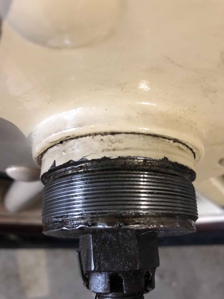

Hello everyone, is there anyone that would be willing to loan out a hub threading tool? A previous owner badly damaged the threads on one of my rear hubs a long time ago, and ended up painting over the threads to hide the problem (quality craftsmanship if I've ever seen it :roll: ). I managed to fix the other side just using a 24 tpi thread file, but the remaining side is a little too bad for the file to work alone. The thread chaser tool from Lang's is on backorder with "no end in sight." If there is anyone that would like to loan me one for a short while, I will gladly pay for postage both ways. Thanks.

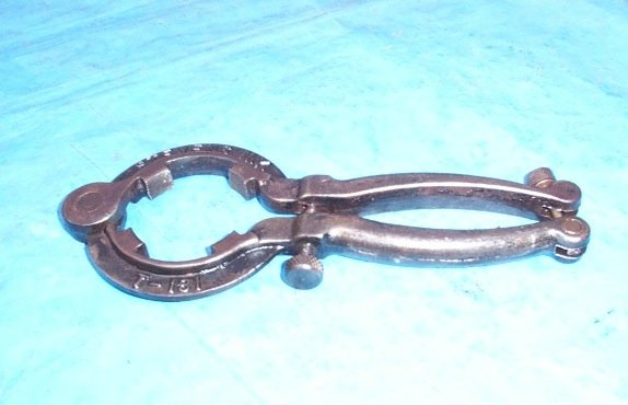

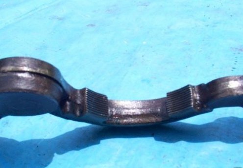

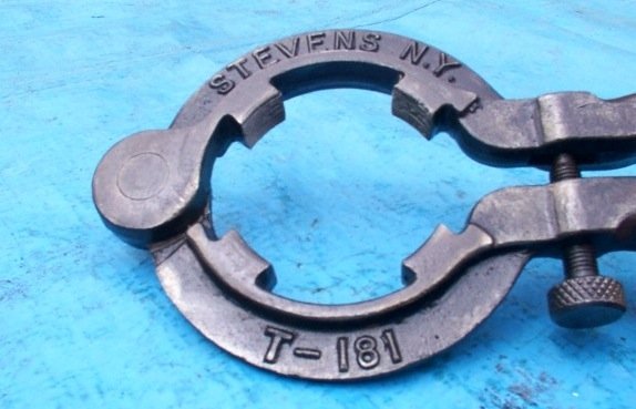

The trouble with the usual chaser is that it has to thread on from the outside. That's where the threads are often boogered up worst. The tool you want is Stevens T-181. Unfortunately it's rare and usually expensive. I've thought of making my own, but haven't got to it yet.

Steve: I would love to find one, but they are, as you said, rare and/or expensive. Some day I might make one if I have the need and haven't found a Stevens by then; however, a chaser will probably be fine in this case. Fortunately the threads on the outside are fine and it's a spot in the middle that gives me trouble.

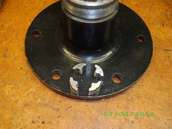

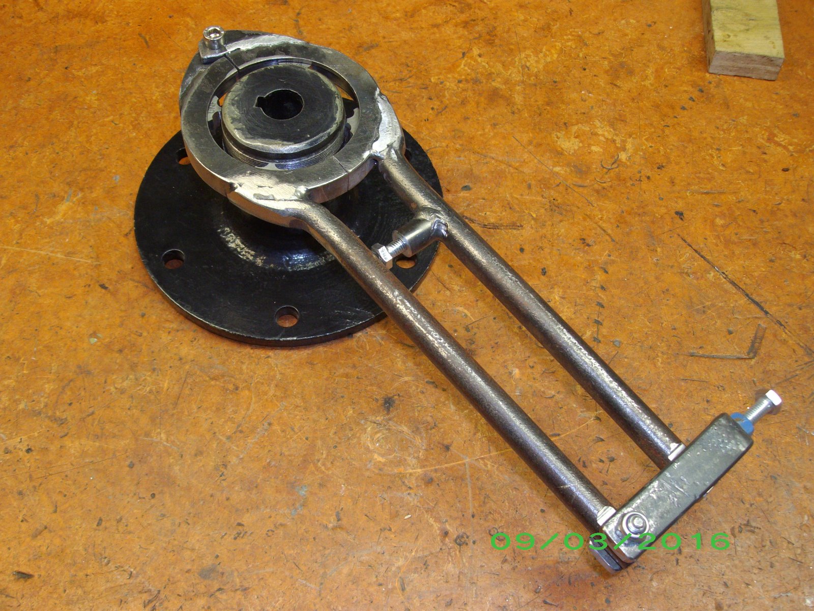

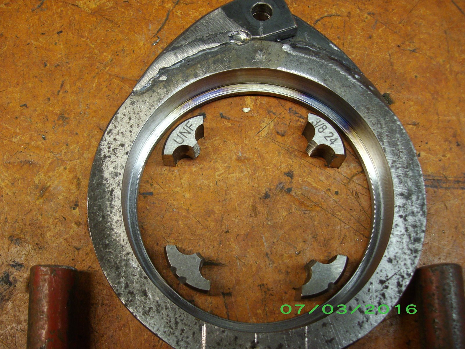

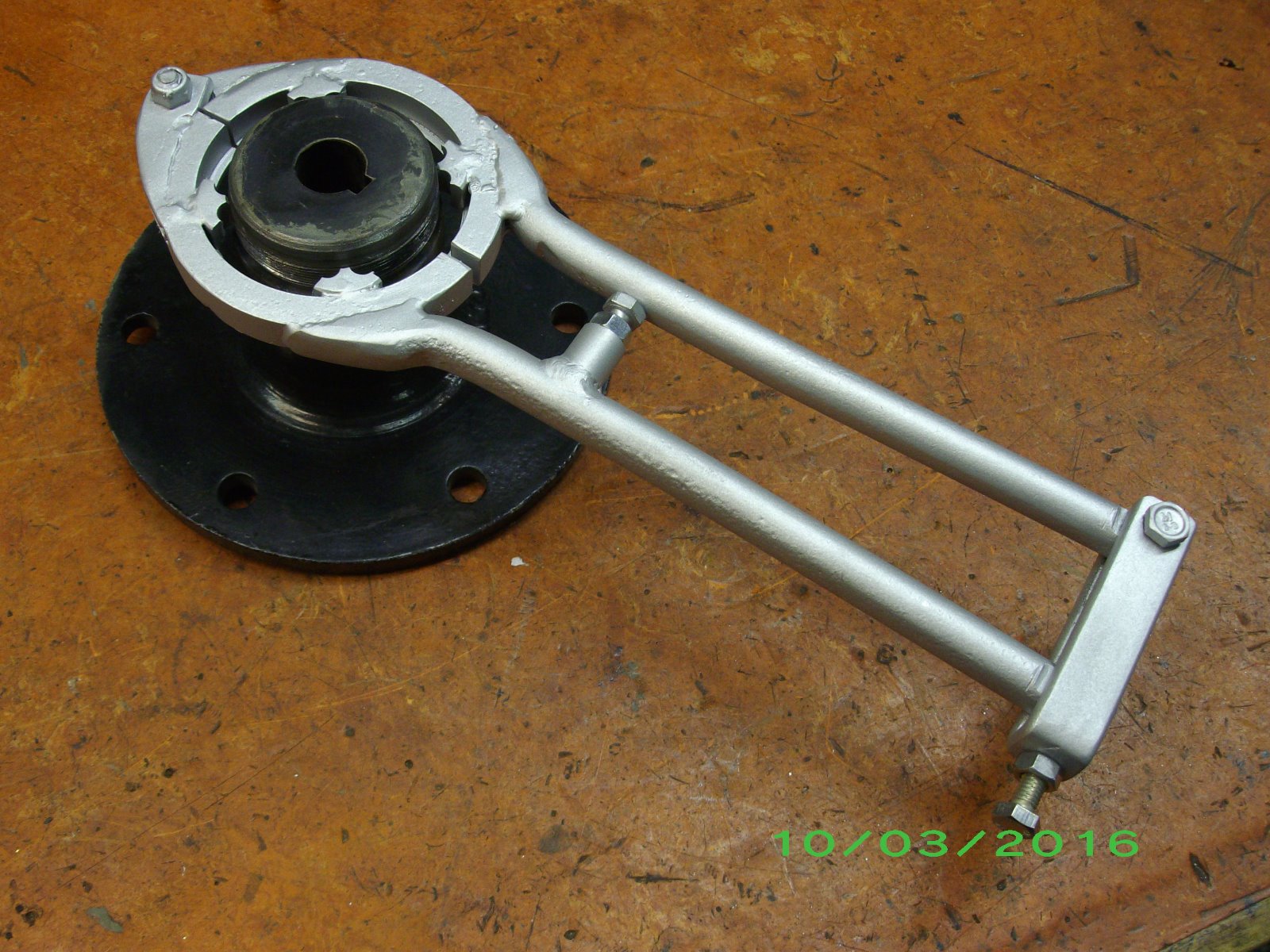

Eric ; As I could not find one here in Holland , I had to make one .

I had emailed Jack Putnam (yesterday) about potentially purchasing a repro one from him, but he has yet to get back to me. Might be a bit expensive for me anyway. I like the design that Anthonie posted in this thread, I might try to replicate it in the future if I have need again.

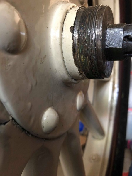

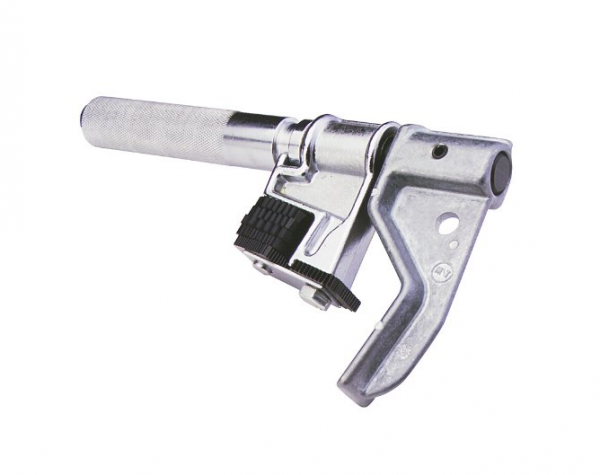

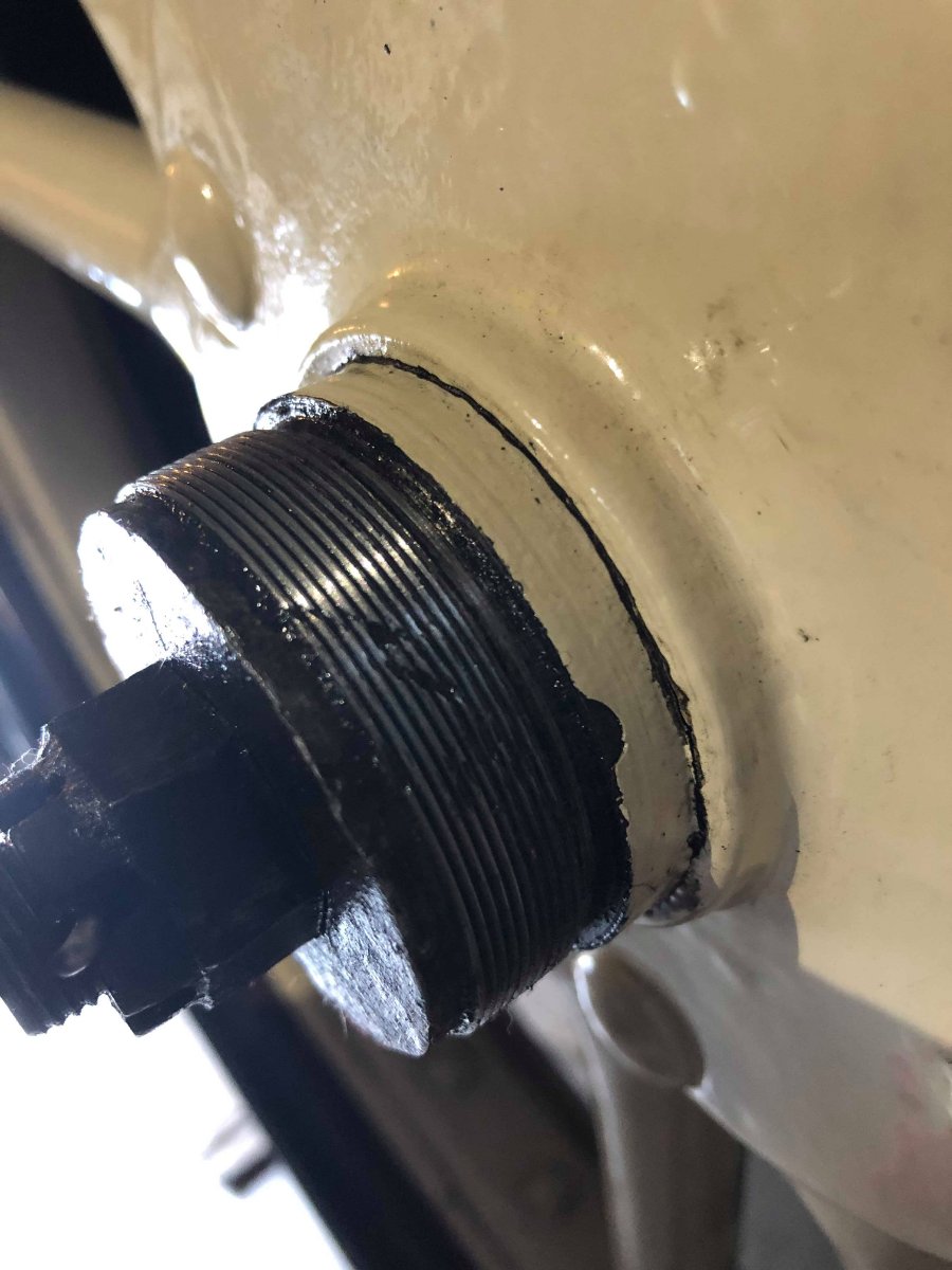

After attempting to use the hub thread chaser from Lang's (for about 6 hours total) in combination with plenty of oil and (eventually) an 18" wrench with little results other than some choice words and a bruised hand, I broke down and got an OTC Thread chaser, like that shown in the picture. Lang's chaser worked alright for one damaged hub, but the other was too far gone for the Lang's tool to work. This OTC chaser was about $70 on Amazon with same day delivery. Also commonly available at auto stores. After about 2 minutes with this OTC chaser (which required almost no effort at all), I was able to screw the hubcap all the way onto the hub using only my hand. I almost cannot believe how well it worked. The amount of grime and metal shavings that this tool was able to clean out of the threads is ridiculous. For anyone that might need this info in the future, simply select the right TPI die, attach it, oil up the hub, place the tool on and carefully thread it counter-clockwise (outwards from the wheel). It only took one sweep. A thread file is probably useful for cleaning up lingering burrs, but probably not necessary.
Pic of the thread chaser
Hub with painted over grime.
Bad gash in the worse-off hub. After thread filing and some scraping, before chasing.
Same bad gash after OTC tool. Not pretty, but the hubcap goes on all the way with no wrenching and that's good enough for me.
