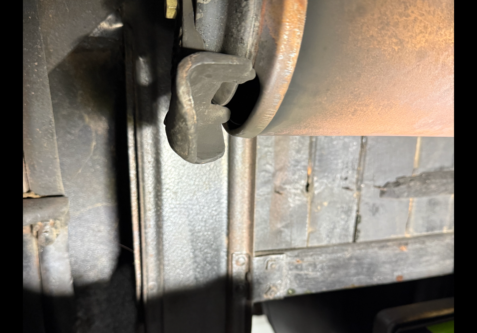

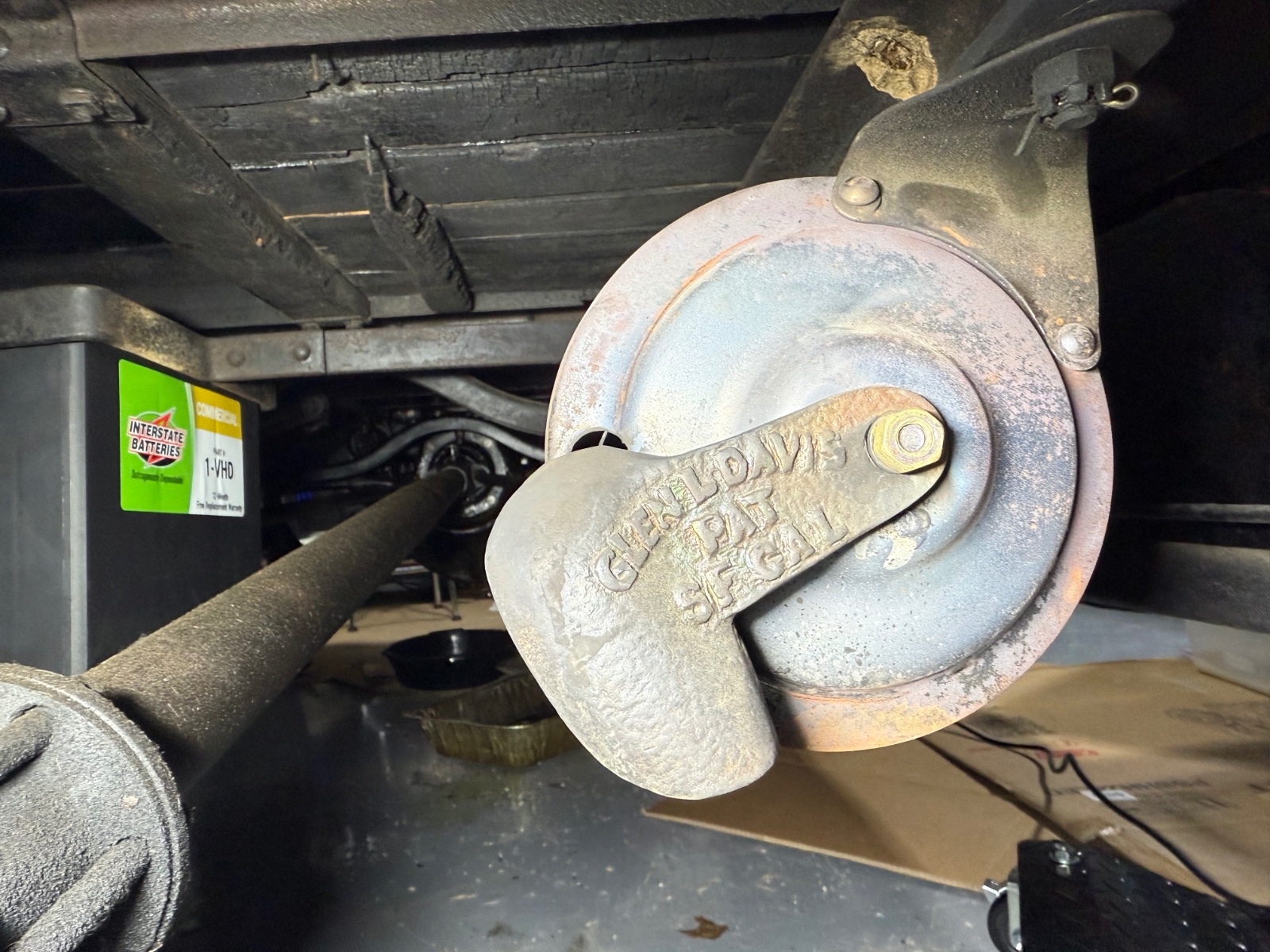

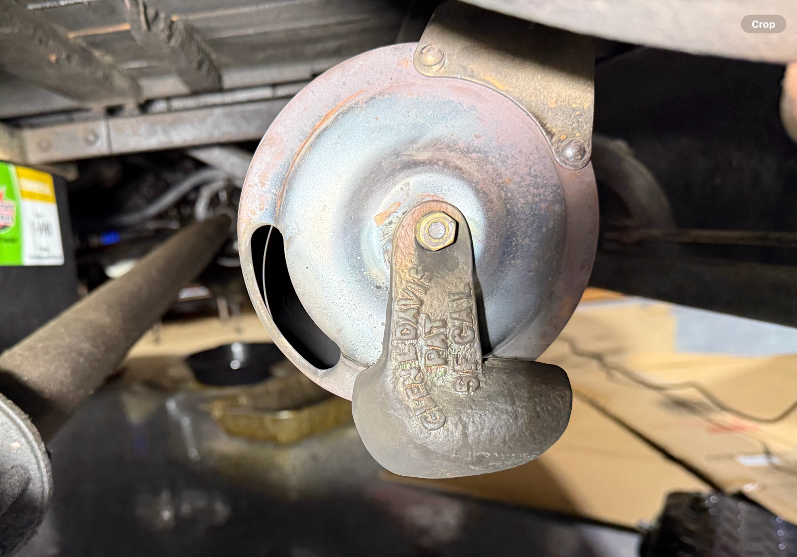

I recently inherited a 1926 model T that has been in my family (grandpa and father) since 1961. I knew my dad put a new exhaust pipe on it a decade or more ago. Tonight I noticed something on the very end of the muffler. What is it? It rotates. Is there a time or reason to rotate it? To where? When? What is this thing called? My google-foo not working well tonight…

That is an exhaust deflector, It is out of place as it should be directly over the muffler outlet. It is used to deflect the exhaust downward towards the ground and away from the rear axle and under-body. As you can see, it's effectiveness is sometimes less than desired.

mtntee20 wrote:
Sat Jan 11, 2025 10:48 pm
Thanks for the quick response. That makes sense! This looks better….
Now I had to noticed the burned wood floor…. That will be another exploration another day…
mireland
Posts: 22
Joined: Mon Nov 25, 2024 12:54 pm
First Name: Matt
Last Name: Ireland
Location: Adel, IA
Re: What is on the end of the muffler?
Post by mireland » Sat Jan 11, 2025 11:00 pm
Is it common to have that significant charging near the tail pipe?

Post by TXGOAT2 » Sun Jan 12, 2025 10:42 am
Putting another small bolt in the muffler body will keep the deflector from moving out of place. I doubt if the deflector caused the wood charring. That may be the result of a rat nest fire, or who knows what.

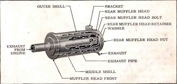

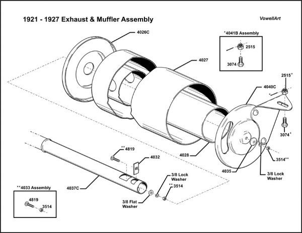

jiminbartow
Posts: 2485
Last Name: Patrick
Location: Bartow, FL
Post by jiminbartow » Tue Jan 14, 2025 9:18 pm
