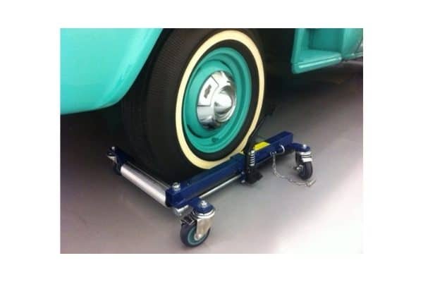

This is a tricky one, you want the ski to slide without damage to the ski, but you need traction for the tracks and you don't want to damage the ramp,
Hmmm.... can you make some sort of sleeve for the ski, or adapt some of those 'skates' they use to roll cars around in a workshop, you know these:
And then use rubber mats or old tires to run up the ramp, they use told tyres to move heavy diggers and even tanks to move over pavement that can't get churned up by the tracks, works really well
Leo van Stirum, Netherlands
