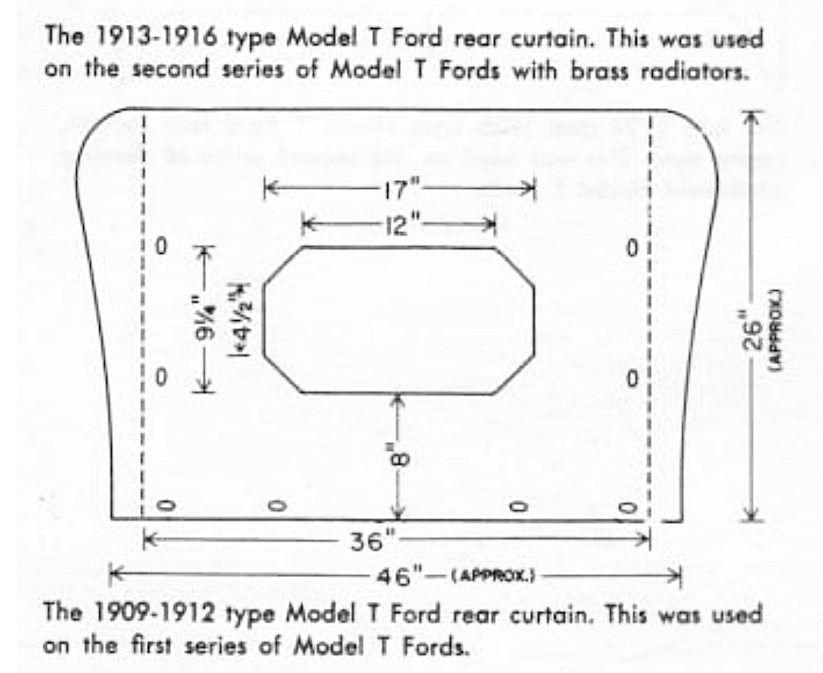

1912 Touring rear window dimensions needed
Post by 49willard » Tue Jan 14, 2025 9:26 pm
I should have titled this thread differently. Rather than calling the rear window on a 12 touring a tombstone the window is 8 sided I believe in the 12.
Can someone provide measurements?

Re: 1912 Touring rear window dimensions needed
Post by Mike Silbert » Wed Jan 15, 2025 8:18 am
Buried in this old 2010 thread about the 1915 Top it shows all the rear windows and their sizes
http://www.mtfca.com/discus/messages/11 ... 1277520007
Good luck with your project
Post by 49willard » Wed Jan 15, 2025 5:03 pm
Thank you both for your replies. That is exactly what I needed!
