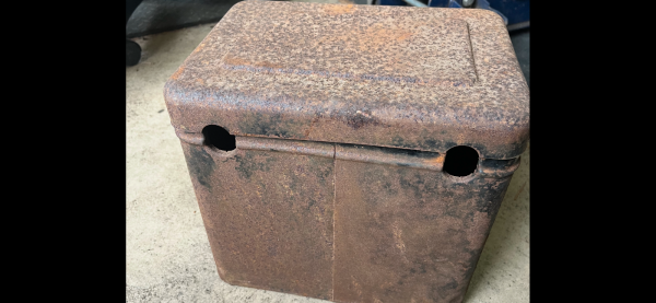

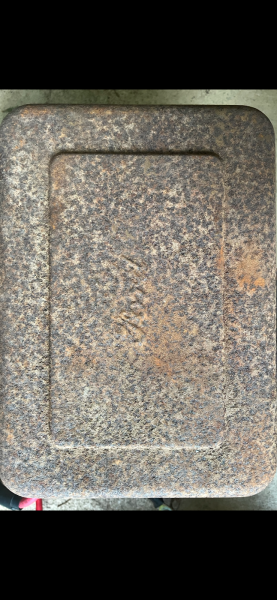

Reciently i was search for parts and I found this battery box with Ford script on the top, I would like any information about what them and what years they were made made

That is the earliest iteration of the battery box, 1919 to early 1920. The running board splash apron would have had holes for the battery cables to go through. A sought after piece to be sure, my 1919 could definitely use it (if it doesn't fit your needs and are willing to part with it). I have some pictures of one somewhere (earlier/old forum posts).

So eventually the battery was in the car on the left ( drivers side ) with the battery carrier after car no. 11,500. Didn’t know that! I bet that there isn’t many of the Ford script battery boxes that survived. It’s a wonder that one did. Wow,!
And as Pep S noted the battery cables would have run through the splash apron. Makes you wonder again if there were any rubber grommets for insulating the cables! Probably the insulating grommets weren’t listed in the parts books. But I’m guessing on that.
The cables would rub against the metal splash shields and short if the insulating grommets weren’t there.

It would be interesting now to find a splash panel with Factory formed holes. They may well have been flanged like the box to help preserve the insulation on the cables. My D & F wide body roadster has the battery on the running board because the fuel tank is mounted in the turtledeck above where the battery access cover would normally be. I use a short piece of heater hose over the cables where they go through the splash panel. It is thicker and fibre reinforced, much better than a grommet.
