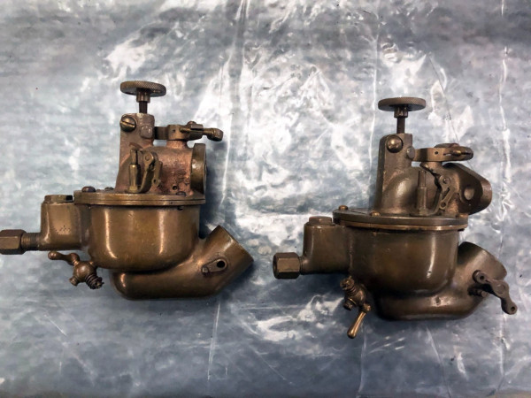

Can anyone tell me definitively if the 1911-12 Kingston 6 Ball carb used a stove/hot air pipe? I can't seem to find much of any information about these carbs.
I am told they are rare. I have two of them that have been rebuilt with new floats, etc.

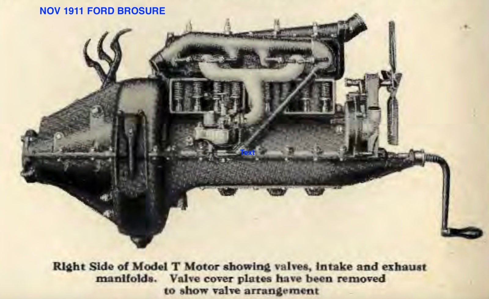

- Posts: 4053
Re: Stove/Hot Air Pipe for 1911-12 Kingston 6 Ball Carb
This illustration in the 1911 Ford brochure indicates a hot air pipe. Casting around the front of the exhaust manifold and pipe going down to the intake on the carb.

Thanks, Dan, that answers the question as to whether it used a stove. Now I need to figure out how to make one up. The carb inlet throat is 1 and 3/8". Langs sells a pipe with 1 and 1/8" diameter. I will probably need to fabricate something. I have a casting that clamps to the exhaust manifold like other carbs, but I need to fit the pipe to the exhaust manifold casting (should be relatively easy) but need to figure out how to secure the pipe to the inlet on the carb since there is no counterbore or clamping nut in the carb inlet. Seems like it needs an adapter that is counterbored to fit over the carb inlet that is counterbored for the appropriate sized pipe.
I wish that illustration was clearer so I could see how it fits to the carb inlet.

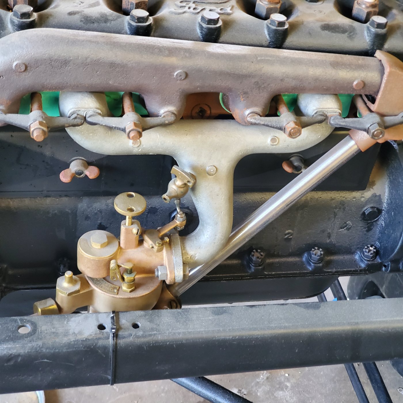

Haven’t experience on these early carbs hot air pipes. But this post by Kim Dobbins might help.
https://search.app/SbzHvfsZuNHxKstD8
