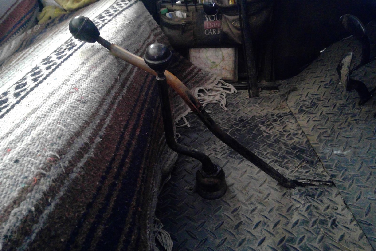

I have a KC Warford in my 26 roadster and the only issues that I a know of are with the shifter, in it original form a friend hit the shifter with his leg and knocked it into neutral and the car ended up on its top (yes it had rocky mountain brakes). I ended up with the car and put the trans in my car, I shortened the shifter and that got it out of the way and shortened shifter throw and that makes it easier to accidentally go from direct to low when you are trying to go to overdrive and it will go right into low. It is easier to shift if you have a foot throttle. Other than that I love it. I included a picture of the modified shifter.
