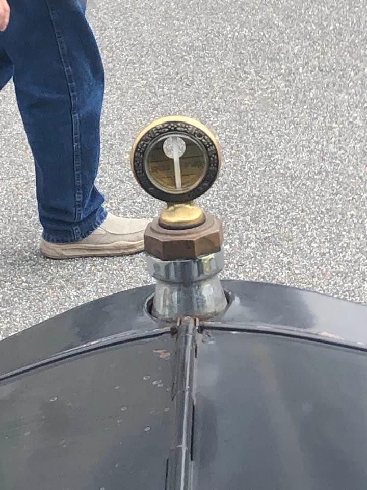

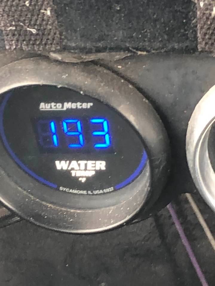

This morning I went to a charity show at an assisted living facility here in Melbourne Florida. It took about an hour to get there at about 30 to 35MPH. The moto meter never showed any temperature but the my gage that I have taped into the goose neck showed the highest temp of 193F. It was 43 degrees when I left. Coming home there was a very little bit of red in the moto meter and the gage showed 205.

I think your motometer is not working.

Untape your dashboard sensor from the water outlet place it in a container with your moto meter and pour in some hot/boiling water and compare readings. That should allow you to 'calibrate' the motometer against the sensor set-up, however neither may be 'correct'. If you have an accurate thermometer that reads that high, add that to the mix too. Best, jb

193F is not too hot, especially at Florida's low elevation. I'd think it would run a little cooler at 43F ambient, but as others note, if it doesn't boil, it's OK. Be sure you are using enough spark advance and that the carburetor is not excessively lean or rich. I'd also check to be sure there are no issues with dragging bands, dragging brakes, or under-inflated tires. Model Ts do not like thick oil. A quality 10W30 oil should work well in Florida. I get excellent results using 10W30 synthetic oil in Texas heat. The previous owner raced the car with 0W20 synthetic oil with good results. (Montana 500) "Green" anti-freeze at 50/50 gives good results. Keep the radiator free of bugs and other debris to allow full air flow, and adjust the fan belt as Ford instructed.
- Posts: 8665
Re: Coolant Temperature
Generally speaking, automotive temperature gauges are not very accurate. Keep in mind that the hottest water in the system will be at the water outlet, and the thermo-syphon system will not circulate water unless the water in the engine is hotter than the water in the radiator.

Since the motometer is suspended in the air space of the tank, thus reading air temperature and not coolant/head/block temperatures like the modern sensor, I would expect there to be inconsistent "readouts" between the two. Fluid contact, heat transfer you know science and stuff...

I do not run a water pump, The radiator is relatively new, I got it from Burks I believe his name was. Its a great radiator, I wish the guy would make radiators again. I don't understand why he stopped. He had a great product. Thin core. I'm certain that it was just the difference between the air temp and the radiator temp.

I too have a Berg's radiator. I have measured the coolant temperature at the top of the radiator core with the temperature probe of my DVOM. It's always around 175 - 180* after warmup.
