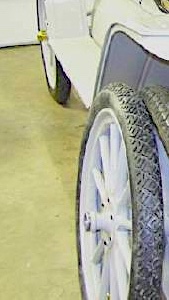

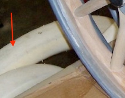

Once bought a set of 'used' smooth whites to put on my faux '09 runabout. When looked over, the center tread area was really thin, could easily press finger into the tire casing and almost see thru. Figure that it worn out to me. So bought a set of Non Skid as this T was to be driven, and didn't want tire trouble on a T with no spare!
worn smoothie.jpeg (37.91 KiB) Viewed 13355 times
non skid.jpeg (25.62 KiB) Viewed 13355 times

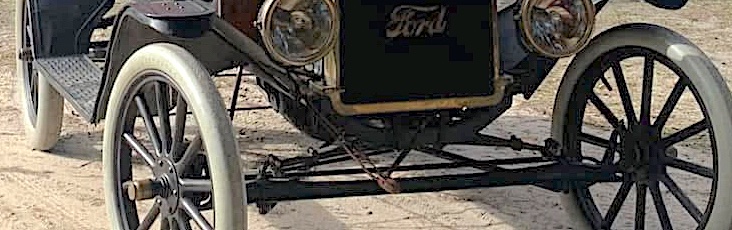

On newest T, the '12 open express am running those Coker close-out blem smooth gray. Seem to be good tires. But will check wear by the same test, deflate tire and press on the casing and see how thin is the tire.......unlike treaded tires, you can't use a penny and measure with Lincoln's head :D

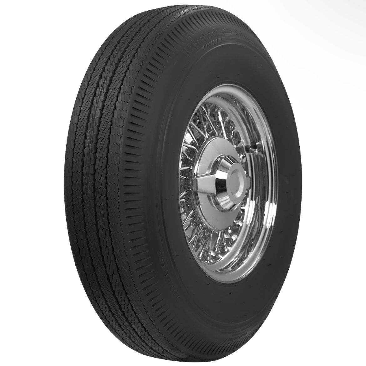

Posts: 7411
Re: tires
Post by Steve Jelf » Fri Jan 31, 2025 12:00 pm
The pictured tire is not a clincher or any other kind of Model T tire. How is it pertinent?
