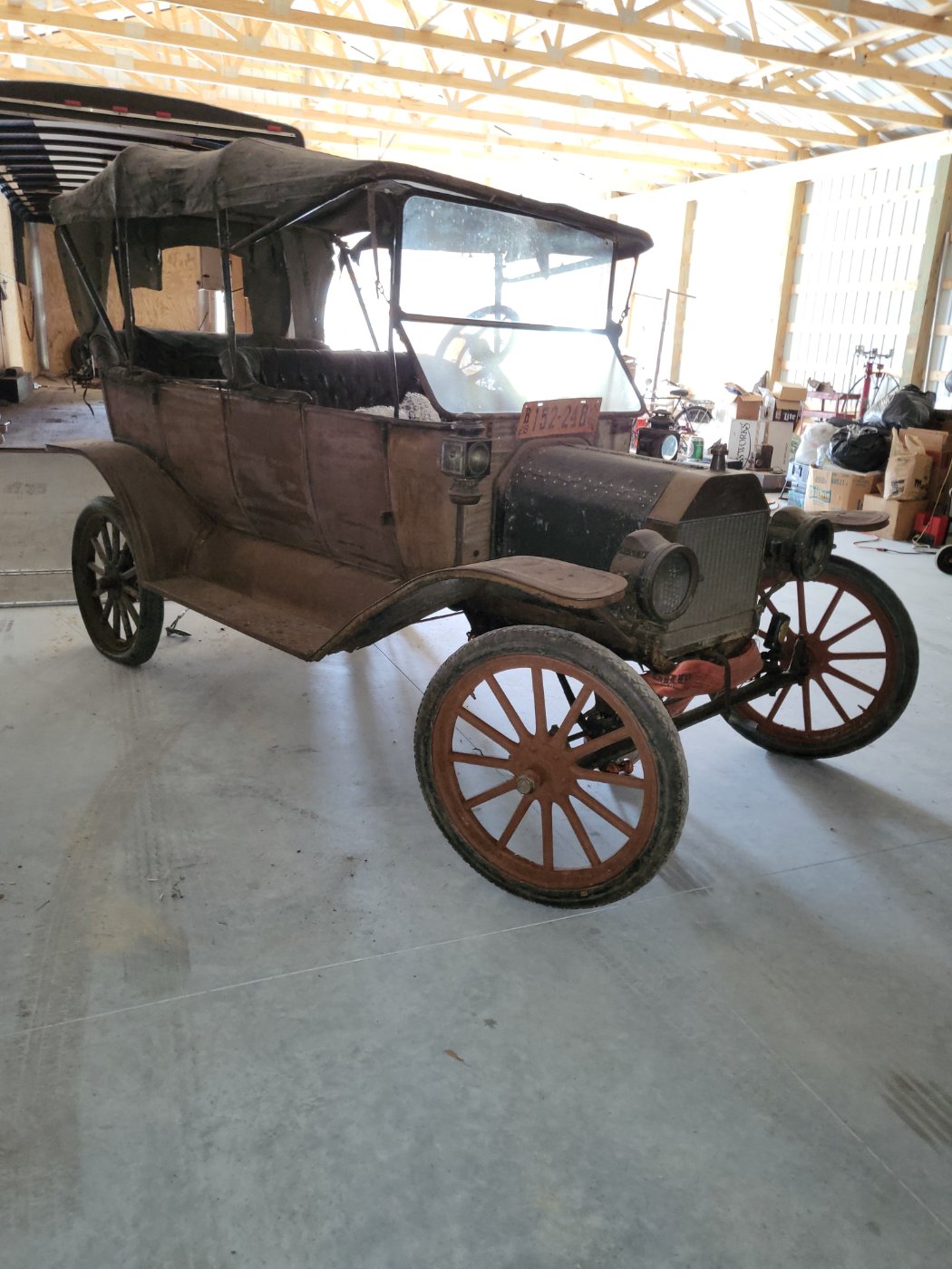

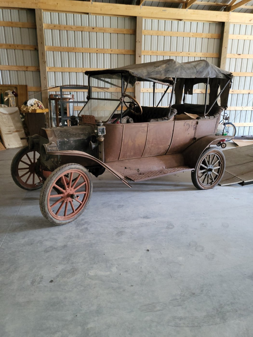

I might be able to help.
- Posts: 7264
Re: 1913 touring top bow assemblies
Steven, note on Bob's car the equal height second and third bows. Note also the second bow leans back. This is because the top has shrunk with age, pulling the bow back as it does so. You can compensate a little for this by giving it a slight cant forward when setting up the bows. Doing this will set the front bow in its position.
