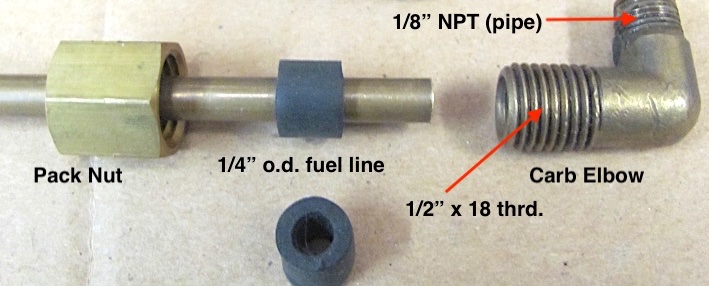

I make my own packing like the blue neoprene ones pictured. I cut a short bit of 5/16" fuel hose, slit the outer layer and remove it, and just use the inner layer as the packing. They can safely be reinstalled most times.

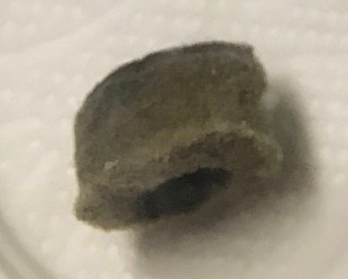

The pack nut, felt, is hard as a rock, feels dry and not sticky but still a bit fuzzy on the outside. So?TRDxB2 wrote: ↑Thu Feb 06, 2025 1:21 pmIts hard to tell what might have been used by someone when taking apart an old gas line. I doubt that Henry would have used anything that added cost to what he may have had on hand.
Old oil & petroleum jelly will coagulate, meaning it will thicken and may solidify, especially when exposed to low temperatures, due to the natural process of waxes within the oil crystallizing and clumping together.
Recently I plucked out a felt from an old pack nut and unable to tell if its felt (for sure not neoprene) - need to get the magnifying glass out will add a picture later
