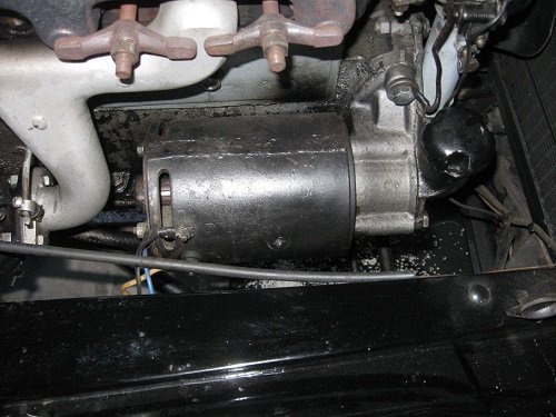

They were made by Randy Johnson, Lincoln, Ca. I have had two of them for over 30 years. They have been pretty much trouble free. Several years ago one of them quit charging. Turned out to be a broken brush spring. Spring from a stock Model T generator fit right in. I had to replace the bearings in the other one last year. He has not made them for several years.
