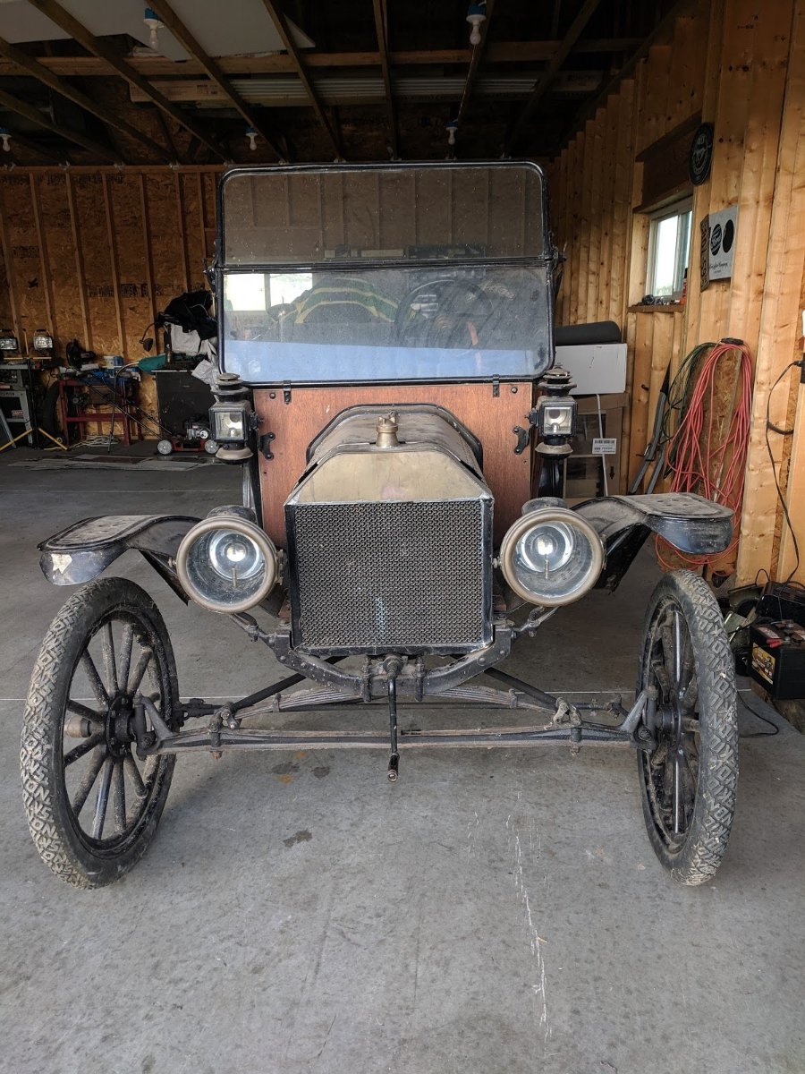

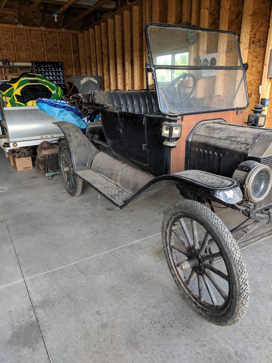

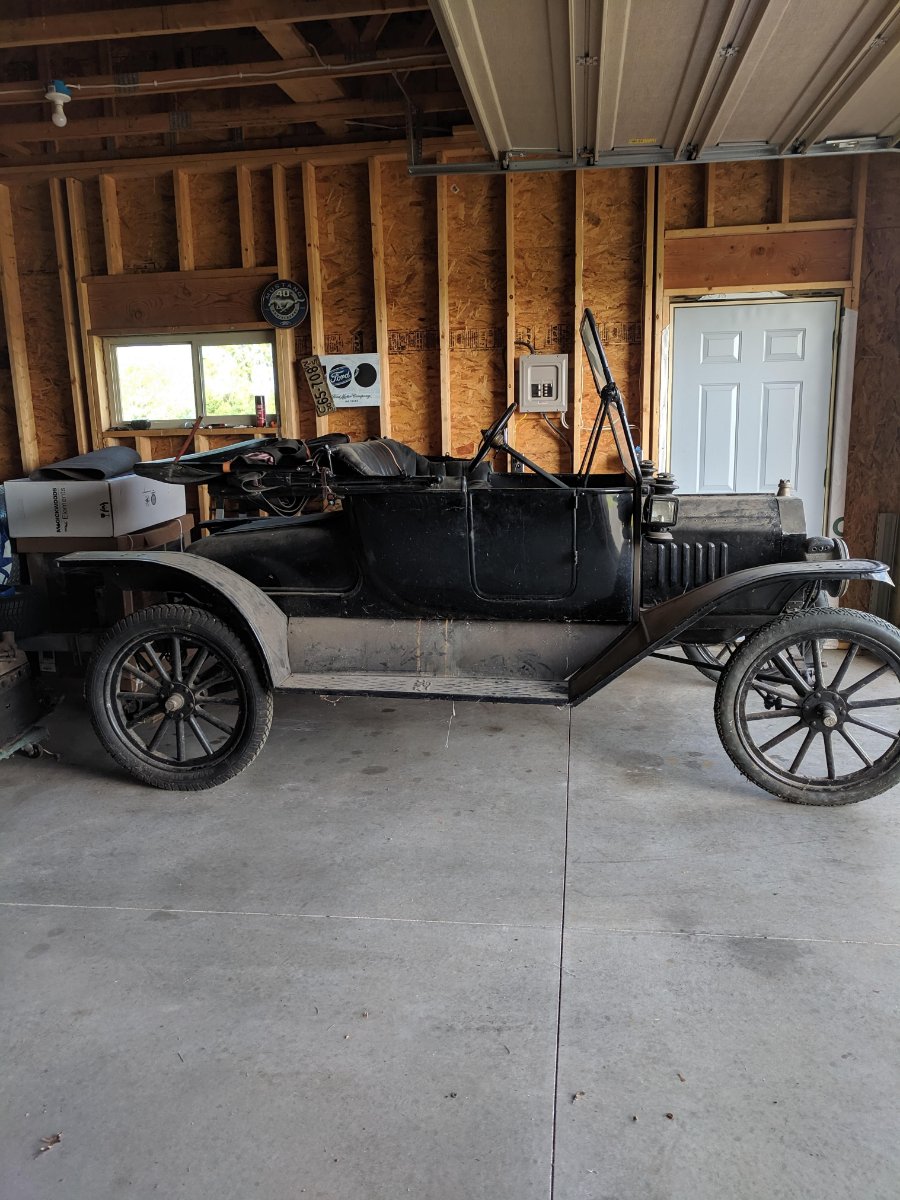

So not exactly a new T owner, I've owned a 1922 TT fire engine that is currently for sale. I recently acquired 2 new to me T's as a package deal from an estate. A 26 Touring and a 14 Runabout. Both were amateurrly restored in the 60's and are in reasonably good condition and I did get both running.
My questions today are about the correctness of the 14. I have been reading up on the brass era cars since this is my first and it appears Ford ceased production on the open cars sometime in late 14 until 15.
The car is titled as a 14. The engine number on the car is 590057 which puts it in September of 14 if I understand correctly. Most of the attributes of the car are representative of a 14 including the carbide lights, cowl lamps, and rear fenders. The front fenders are of the 15 style which has me wondering if they are original. Also appears to have a 15 louvered hood.
Can you fine folks share your opinion on this as well as any other thoughts on the build month. I also wonder around what month production ceased on the open cars in 14? Thanks in advance for your knowledge! Many more questions to come as I learn more and enjoy both cars. I've added some pictures for reference. Excuse the dust that's exactly as I brought her home.

Loren, that is a nice find. 14-15, there will be an overlap period when parts could come up on either years which may be correct on individual cars, like 15 front fenders on on your car. I have seen 13-14 riveted diff halves on known 1915 cars.
There is something going on with the windscreen though. On 1914 cars the lower screen leans back and the top screen is vertical. The top screen folds back, and as a result there is a dogleg in the support to allow it to do so. Your two screens on the same plane and the straight suppports are not usual on any car. It is a problem easily sorted with the correct parts.

The engine assembly date is Tuesday, September 29, 1914, which puts it in the 1915 model year. But as Dave says, there's no guarantee that it's the original engine. You can check the hood with a magnet. If it sticks, the hood is 1916 (steel). If not, it's 1915 (aluminum).

Lorien, Your Sept 1914 engine could be original to the car. Ford had a delay in producing the 1915 style open cars.

It is a body made in 1914, with a later windshield and home-made windshield supports. It is an engine made in 1914. Odds are strong that the two left the factory together. The car came with a bill of sale and not a title, as titles came much later, at different times in different states. The owner had to produce evidence of ownership and then declared the car to be a "19xx" car, so even some original titles were not entirely accurate. Our February '13 touring still has it's original Indiana title from 1926 (as I recall) and it is a title that reads unlike any other title you'll ever see (and the old farmer called it a '14, as it turns out)
I get the fact that the fiscal year and calendar years are different, but honestly, it is splitting hairs and would be plain goofy to call this car a "1915" given that the car was made in 1914, and is a 1914 body style (1915 was markedly different)

Although Ford's 1915 fiscal year started October1, 1914, the non-cowl 1914 body was produced through January 1915 and who knows how long at assembly branches. Regardless of production date, I generally date a car by its model year. Your car is a 1914 model. I wonder how many Nov 1914 to Jan 1915 cars were incorrectly restored with wrong bodies or engines. I would love to find more cars like yours from that unique era. I find Ford's transitional times really interesting. My transitional Oct-Nov 1911 has step-side body has been known as a 1911ever since it was new.

Tim, I thought you were going to write about my observation when you mentioned cowl lamps. They appear very much like Victor #1 lamps and would match the painted bonnet headlamps as Victor #1s too. Combined with the straight windshield support arms this points to 1913. Of course the door style is 1914. Scott, my 1914 windshield appears like the picture. Push it forward a notch and it’ll be perfectly verticle. Lorien, your runabout is beautiful and you’ll get a great deal of enjoyment out of it. Check two things for us: does the top of the windshield fold forward or rearward...and...is the Ford script on the cowl lamps ‘raised’ or ‘recessed’. One more thing. Do you know for sure if the rear axle babbit thrust washers were replaced?

What a great looking runabout !! No one has mentioned the after-market radiator, and I'm not "up" on '13-'14 differences enough to know if the crank handle changed from "curvey aluminum" to "straight taper steel" in '14. (??) It's always a question with a 105 year old Model T just how many later parts were added replacements during its using life, and just how complete it was before undergoing a restoration at the tender age of 50 . . . and how attentive to "authenticity" was that restorer ? I'm curious about the dash, possibly replaced in a 1960's restoration ? I believe the finish veneers run horizontal over a vertically laminated core originally.

Do not try to move the windshield until until you turn the driver side hinge over the other way. It is on backwards.
The passenger side windshield hinge is on correct for it to fold to the rear. ;)
Then we can talk about a nice looking '14 :) with some Victor lamps we have to get lit! :D

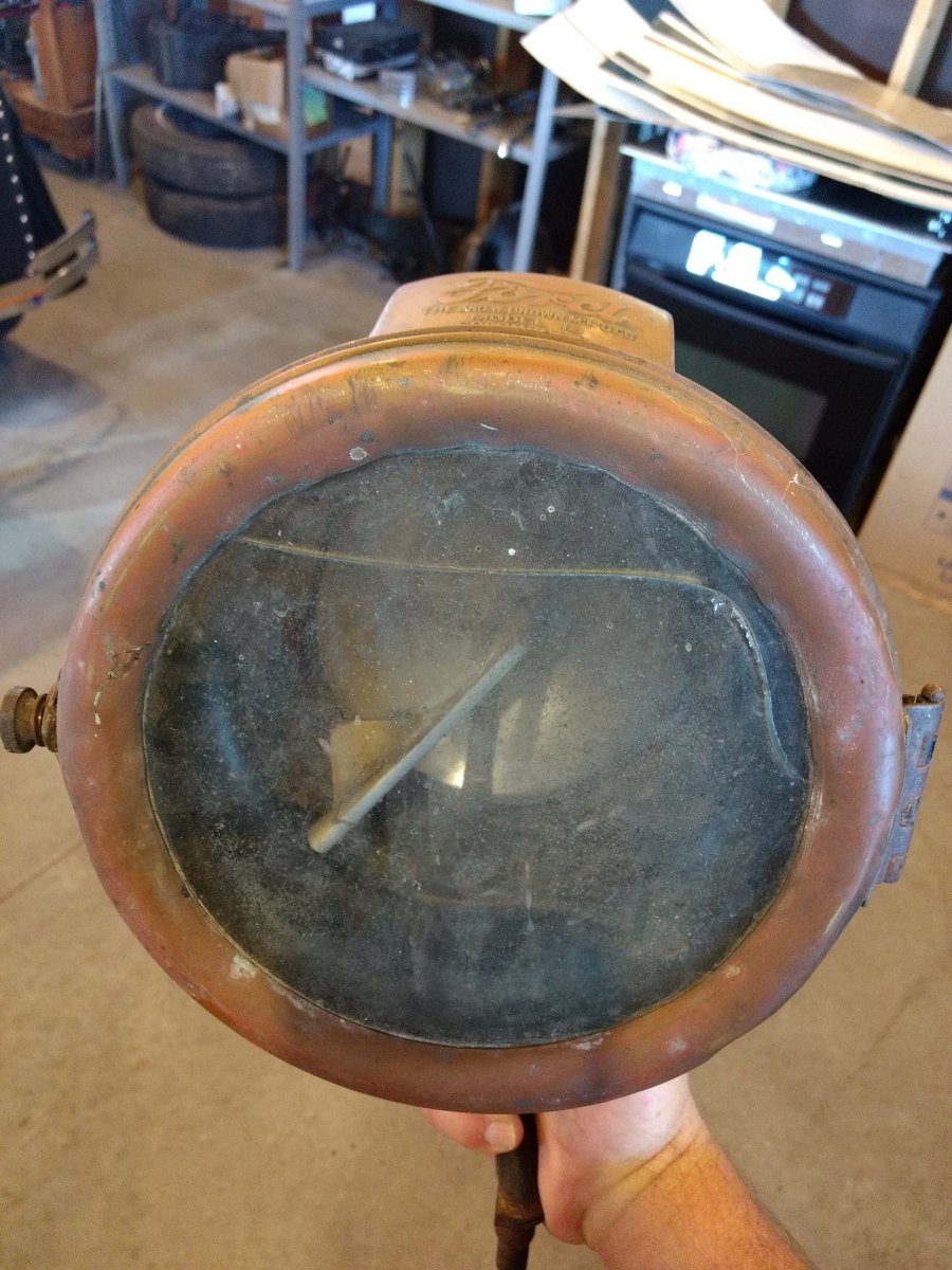

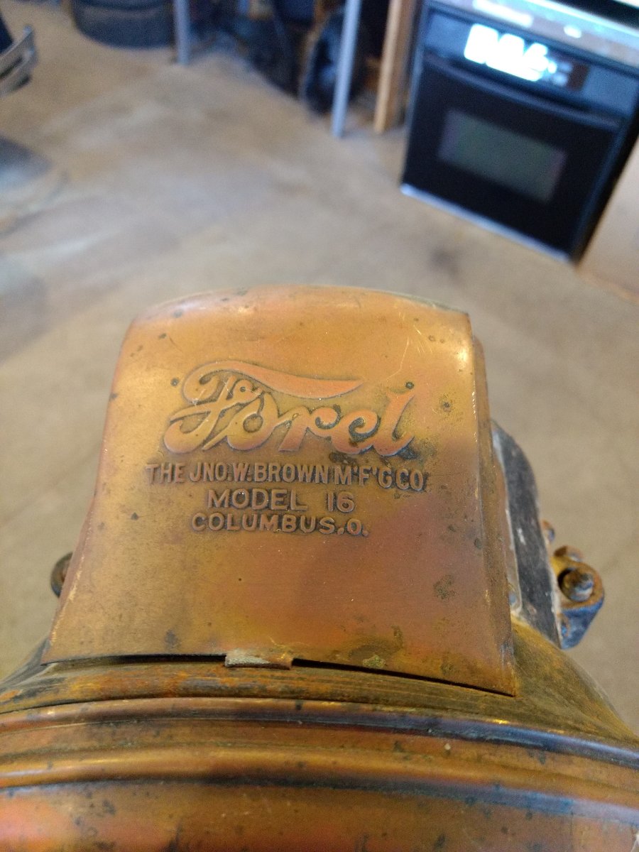

On a similar note, a pair of the headlights below also came with the car and are in good condition. Any idea on what year these are?

The '15 style fenders were used in late '14, but they still use the '14 bracket. Fairly common. Check the windshield hinges for the double dimple. It's the only year they did that. The support arms, as noted, are for a '13. They are difficult to find.

Here's the pictures of the additional headlights. Any idea on year?

I have all matching Brown 16's on our '14.

The John Brown 16's also "fit" your runabout. You have plenty of headlights! :)
I have a set on a my July 1913 '14 style touring. Most important part is the Mangin mirrors in them. The mirrors will also fit the Victor lamps that are on your car.
A fellow has a post on the HCCA that he goes to Hershey and re-silvers the Mangins if they need it.
https://hcca.org/BOARDS/viewtopic.php?f ... 58049a53c3
I haven't tried to have any silvered since I have a number of good mirrors. Has anyone used Joe to re-silver?
The John Brown 16's come left and right door opening but doesn't matter. Seems they got mixed even on the assembly line.
